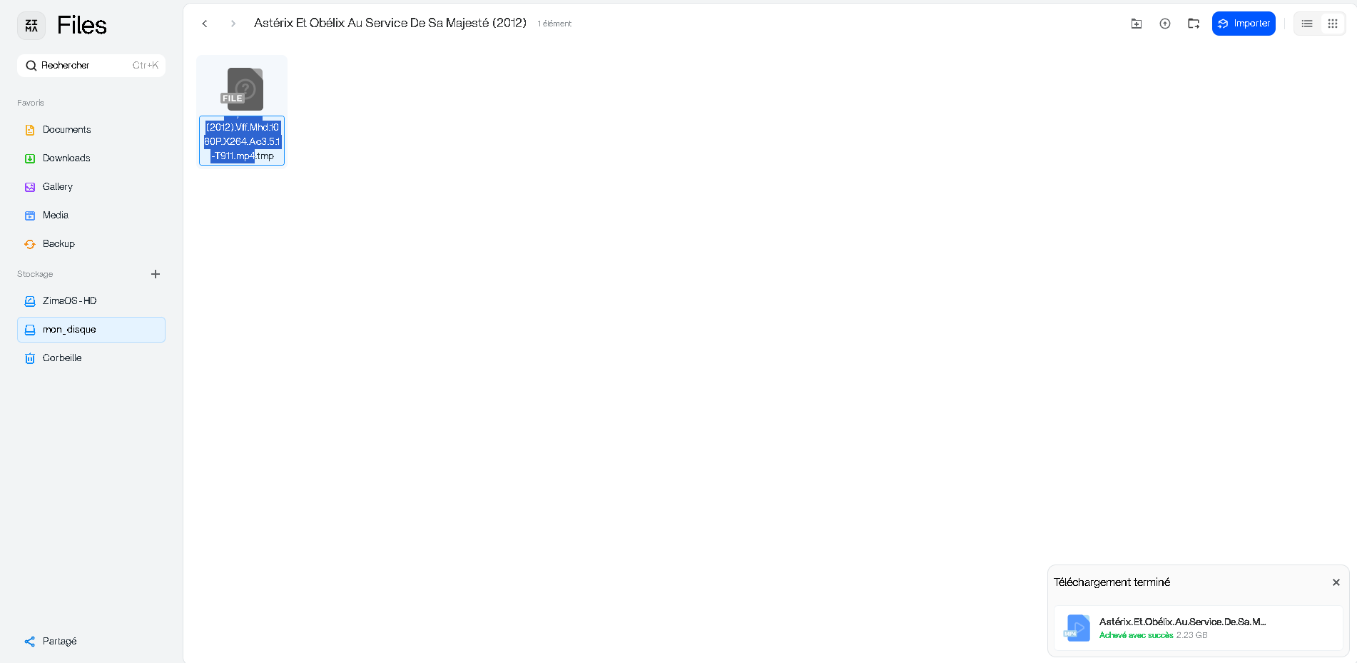

Why when I push a .mp4, the file manager add after .mp4, .tmp ?

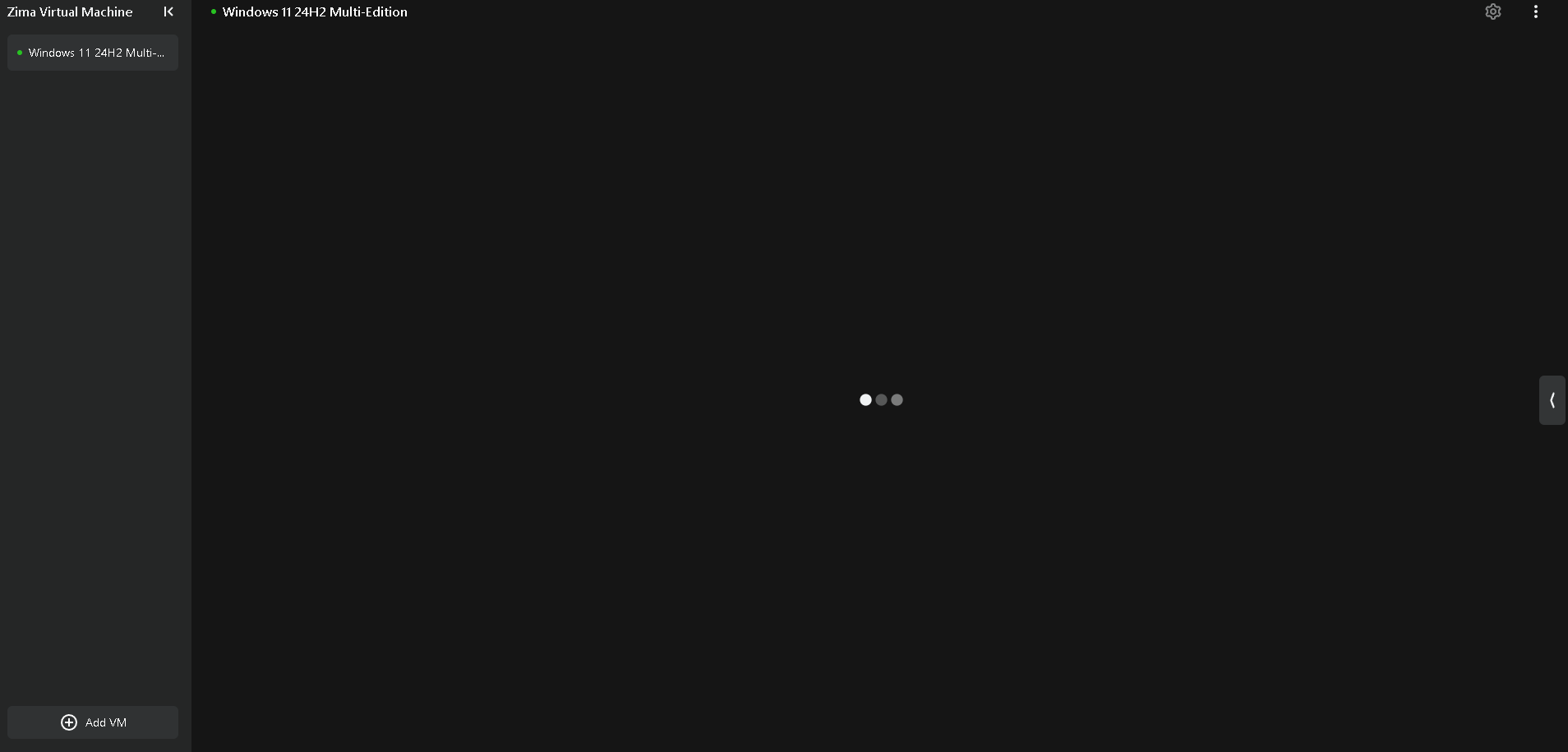

For my virtual machine, u see my probleme.
He don’t work, he load all time
Would you please provide the specs of you machine? The name/version of the OS in VM?

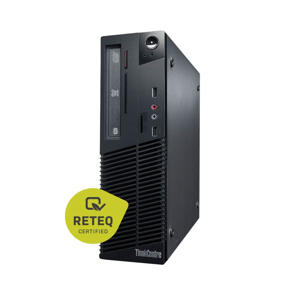

This is information of my machine and i use ZimaOS v1.4.0-beta1
sudo dmidecode -t system | grep -Ei ‘Product Name|Manufacturer’
Manufacturer: LENOVO
Product Name: 3664BT4
The virtualisation is active on Bios
lscpu | grep Virtualization
Virtualization: VT-x

And for .mp4 tmp is not fixed, I update nas but no change
I tried to create a virtual machine with virtual manager but I need to enable libvirtd and I can’t enable it.

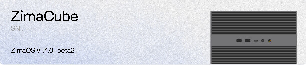

Did you mean the .tmp issue is not resolved in 1.4.0 beta2?
Would you reproduce it and take a screen record of the whole process for us to resolve your issue?
Here are the videos for the .tmp
I can’t post the videos directly here because I’m a new user. So here’s a Weetransfer link that’s valid for 3 days. In this folder you’ll find two videos related to the .tmp file and one related to the virtual machine.
