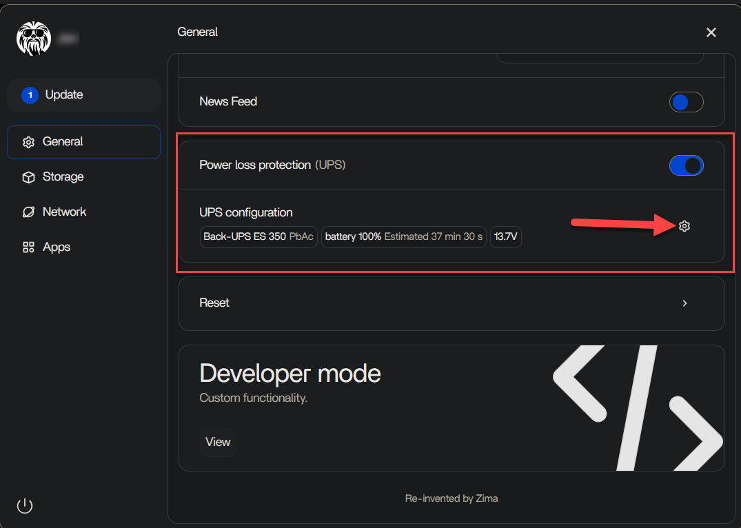

I just saw this:

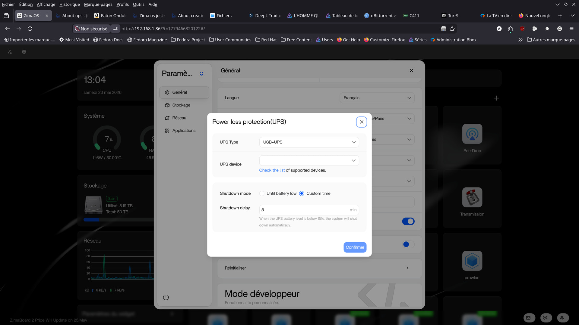

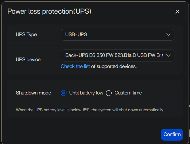

Once you connect the USB cable from your UPS to your NAS, it will show in the settings you see.
Then click the cog to configure.
You can choose to shutdown after a certain time or when the battery in the UPS hits 15%.

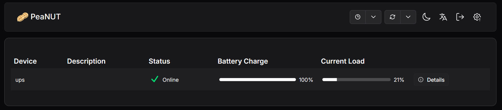

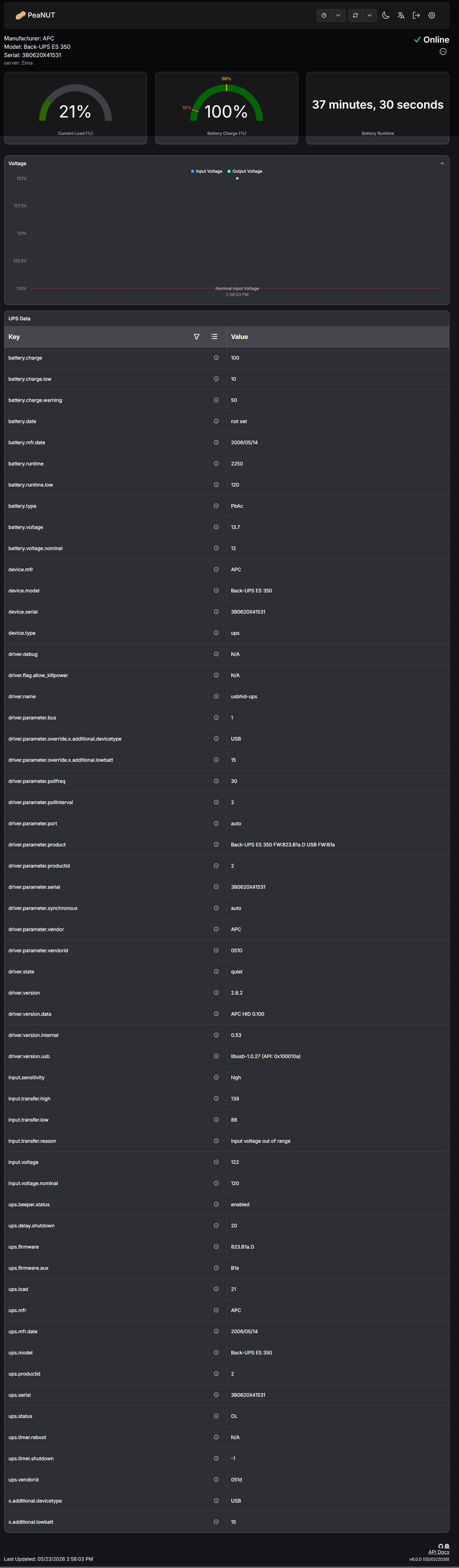

You can also install PeaNUT from the App Store if you want more detailed info about your UPS.

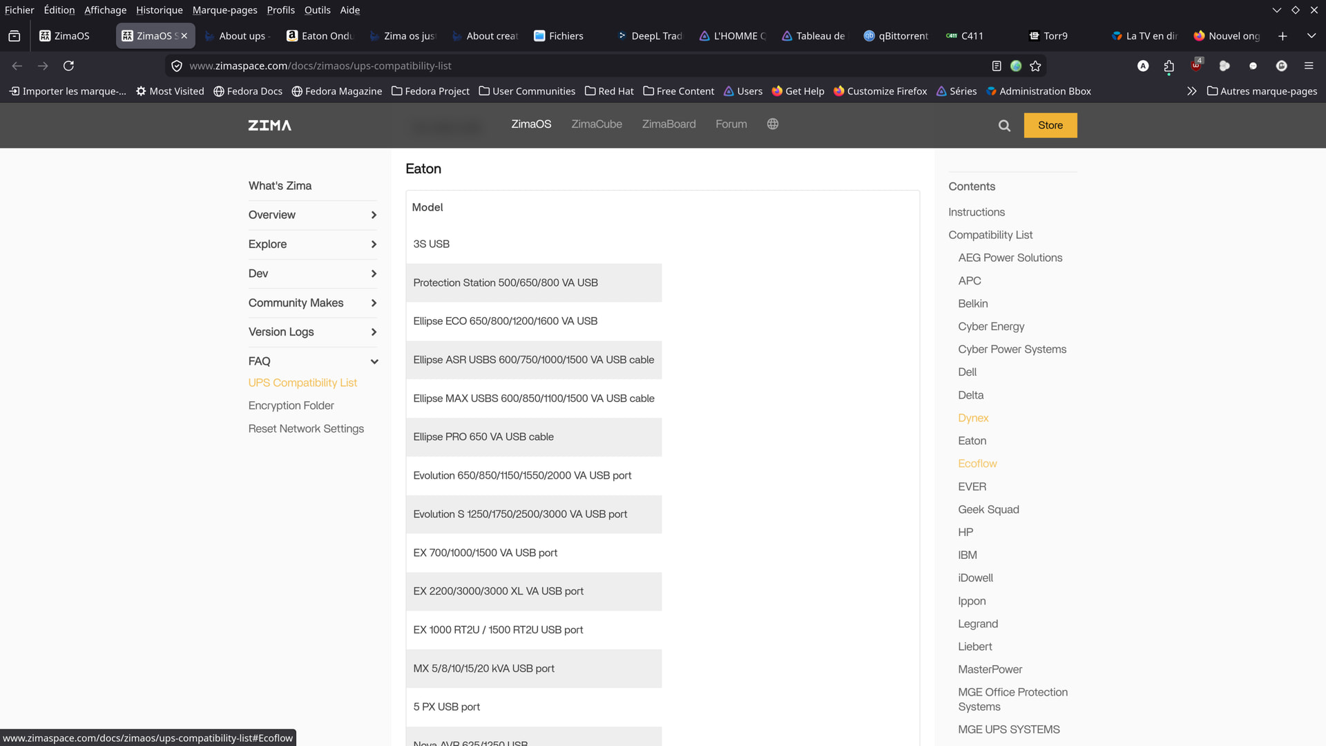

I’m currently torn between these two models:
the Eaton Ellipse Pro 1200 VA
the APC AVR 1200 VA UPS
I believe the APC uses the “apcupsd” driver
and that it is partially supported on Zima OS 1.6.2
I’m leaning toward the Eaton, but the APC is cheaper (though it’s also less powerful).
