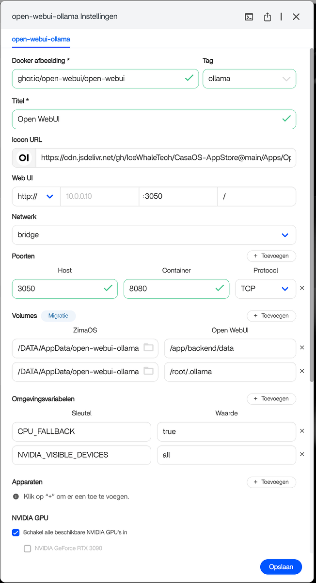

The reason OpenWebUI / Stable Diffusion is running on CPU/RAM is visible in your screenshot:
You have CPU_FALLBACK=true set in the container environment variables.
That will force (or allow) CPU mode even when the GPU is available.
What I suggest
  1. Remove CPU_FALLBACK=true (or set it to false)
  2. In the GPU section, I suggest also ticking the actual “RTX 3090” device (not only “enable all GPUs”)
  3. Restart the container
Also important: OpenWebUI itself is only the UI. The GPU workload must be enabled on the backend container (Ollama / Stable Diffusion container). If only OpenWebUI has GPU enabled, nvidia-smi will still show no processes.
