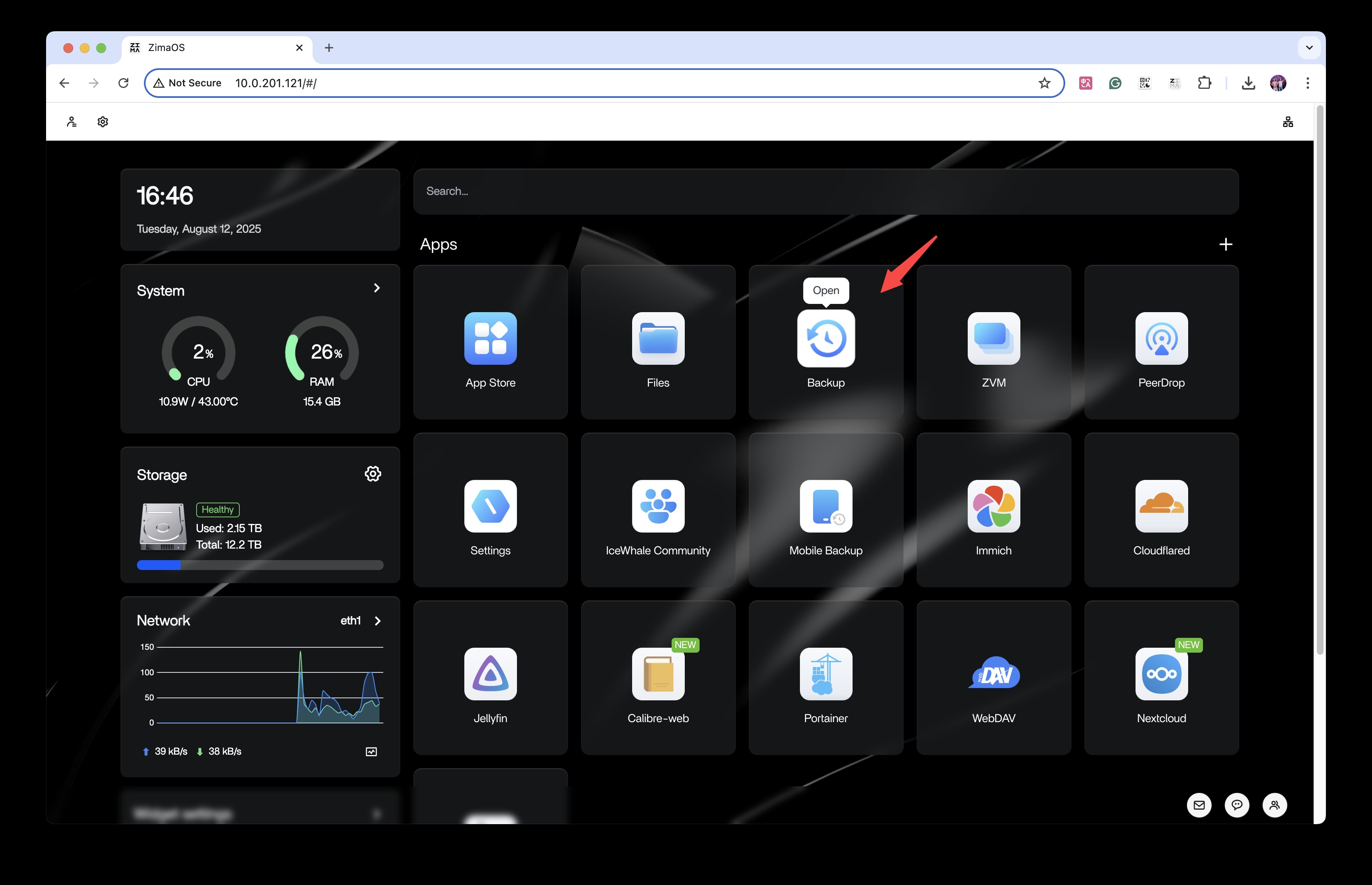

Please upgrade version to v1.7.1 and try it.

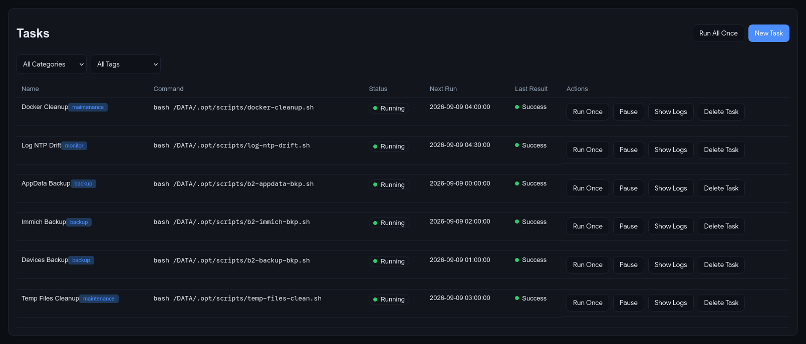

While I understand how a GUI backup tool is beneficial to basic users, as a Linux system administrator ZimaOS comes with all the tools I need to solve every problem you mentioned. With rsync for local backups and rclone for remote backups. You can even create the simple backups with a click of a button for your employees by writing the backup commands as a bash script and using the Zima Cron UI to trigger them. Just keep the cron entry paused so it doesn’t run automatically, and your employees can simply press the “Run Once” button to run it manually.
In my setup, the ZimaOS NAS is actually a local backup for all of my other servers and clients on the network. The ZimaOS NAS is then encrypted and backed up remotely to Backblaze B2 with the rclone utility using bash scripts and the Zima Cron tool for automation.
Here is an example of one of the backup scripts that encrypts and backs up the /media/Quick-Storage/Backup directory (that contains the backups from other clients and servers on the local network) to Backblaze B2, then sends a push notification to my Gotify server.
#!/bin/bash
# Define variables
JOB_NAME="Devices"
SOURCE="/media/Quick-Storage/Backup"
DEST="B2-Crypt:ZimaOS-NAS-Backup/Quick-Storage/Backup"
LOGFILE="/var/log/rclone-b2-${JOB_NAME,,}.log"
GOTIFY_TOKEN="your-app-token"
GOTIFY_URL="https://gotify.example.com/message?token=$GOTIFY_TOKEN"
# Execute native rclone sync
rclone sync "$SOURCE" "$DEST" \
  --fast-list \
  --transfers 16 \
  --b2-hard-delete \
  --retries 5 \
  --low-level-retries 15 \
  --timeout 2m \
  --log-file="$LOGFILE" \
  --log-level INFO \
  --stats 0 \
  --stats-one-line
# Capture the exit code immediately
EXIT_CODE=$?
# Extract the final stats line from the log
if grep -q "Transferred:" "$LOGFILE"; then
  STATS=$(grep "Transferred:" "$LOGFILE" | tail -n 1 | sed 's/.*Transferred: //')
else
  STATS="No transfer data available. Backup may have been empty or failed."
fi
# Send Gotify notification
if [ $EXIT_CODE -eq 0 ]; then
  SUCCESS_MSG="The $JOB_NAME directory backup has completed successfully."$'\n\n'"Stats: $STATS"
  curl -s -X POST "$GOTIFY_URL" \
    -F "title=$JOB_NAME Backup" \
    -F "message=$SUCCESS_MSG" \
    -F "priority=4" > /dev/null
else
  FAIL_MSG="The $JOB_NAME directory backup has FAILED with exit code $EXIT_CODE. Check $LOGFILE."
    -F "title=$JOB_NAME Backup: FAILED" \
    -F "message=$FAIL_MSG" \
    -F "priority=8" > /dev/null
fi
You can use this method to back up any directory on your server, including your ZimaOS configuration. Restoring the files is as simple as reversing the source and destination. For local backups (e.g., a USB drive or another local server) you can use the rsync tool in place of rclone. I actually use the same tools to back up other Linux servers and clients on the network to the ZimaOS NAS. While for Windows I use their built-in backup utility to back up files to a mapped network drive.
If you don’t mind putting in a little bit of work you can use these CLI tools to accomplish your backup goals while you wait for a GUI tool to be developed. I’m sure it won’t happen overnight, so it may be worth looking into. Once you have it set up there really isn’t any ongoing maintenance you need to do to keep it running. It will just continue operating automatically until you tell it not to.
Note: The more advanced way to do it would be to set up systemd services and timers to automate the backups which is what I do on my Linux workstation and laptop, but to keep things simpler I used Zima Cron for this example.
If you want to set this up while you wait for a more comprehensive GUI backup tool and you need some assistance, then feel free to ask. I would be happy to help.
