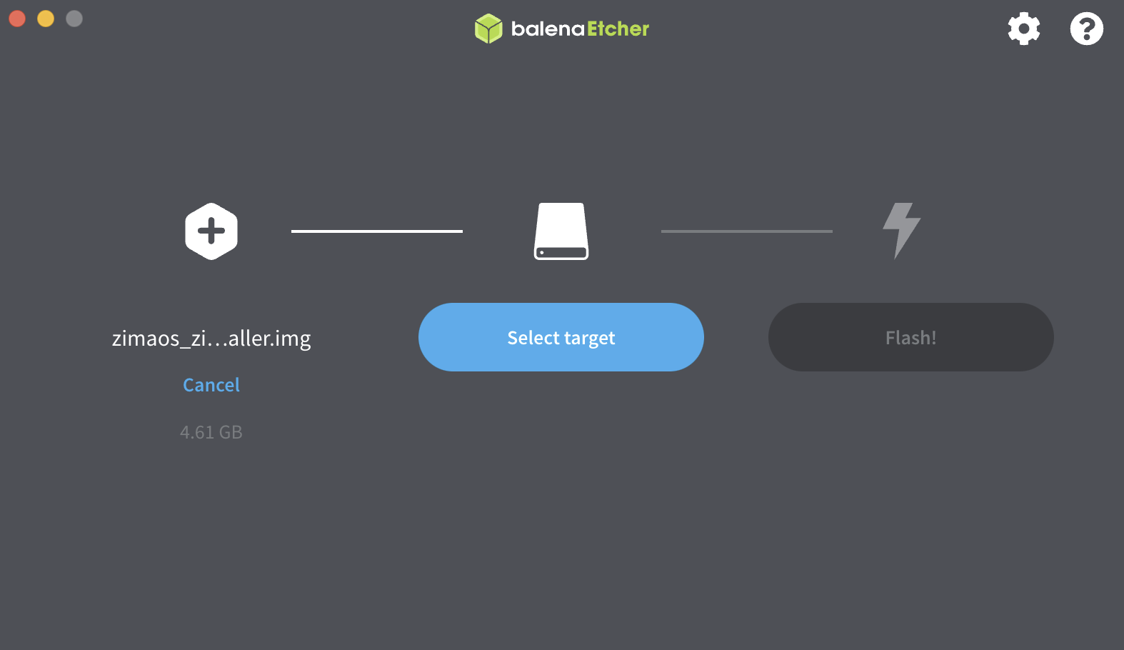

Thank you so much, laughs, now I just have to fix ZimaOS. I was trying to install a bootable ap and it blew up so now I’m trying to find a useable zimaos distro and according to windows, every one I’ve tried has a UEFI issue and windows won’t create a USB.

Honestly just stick with Balena Etcher, it’s the most reliable with ZimaOS. Rufus can work in some cases, but it’s hit and miss with these images and tends to throw those UEFI errors you’re seeing.
What I normally do:
  • Open Balena Etcher
  • Select the ZimaOS image
  • Flash it straight to the USB (no changes needed)
That’s it, Etcher handles everything properly in the background.
If Windows is complaining before that, just ignore it or reformat the USB once, then let Etcher take over. Don’t try to “fix” it with Windows tools, that’s usually what causes the issue.
Once it’s flashed, plug it into the ZimaBoard2 and boot from USB, it should come up fine.
You’re actually very close, this part is just one of those annoying quirks.
