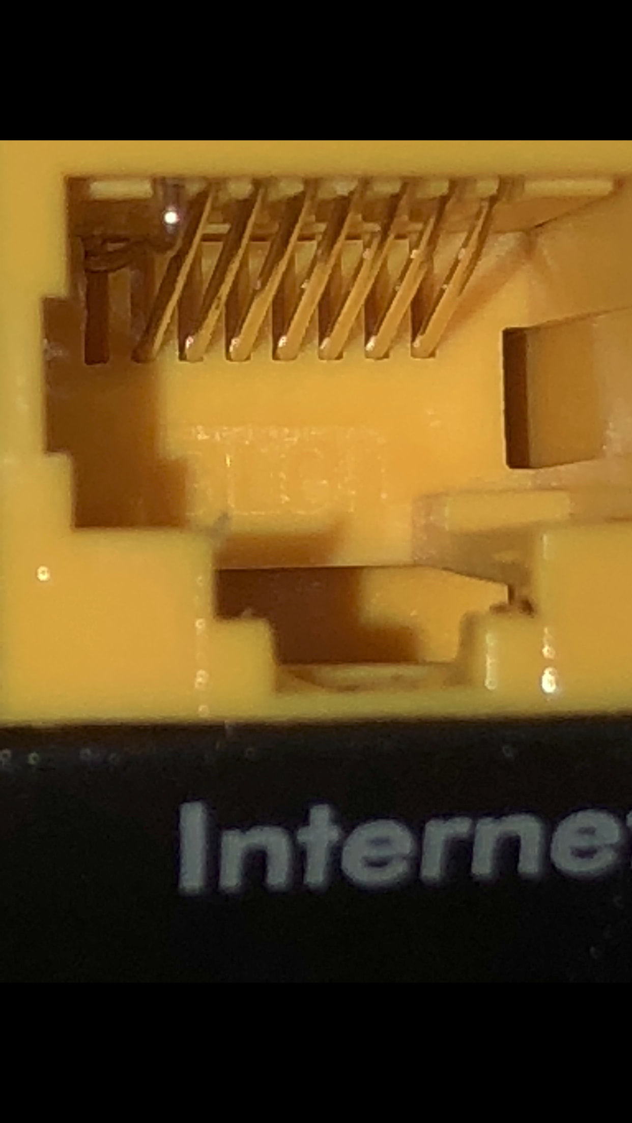

I would first try a different Ethernet cable. If it still having issues then I would look at the switch or router port connector to see if it has a bent pin
