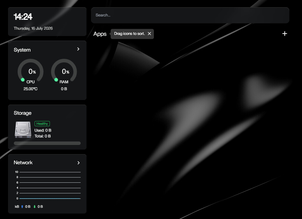

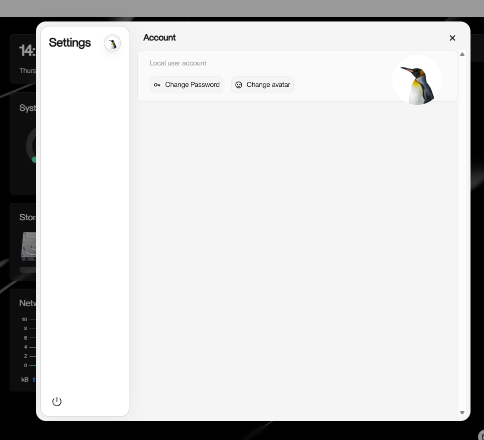

I’m in a weird situation and not sure how to troubleshoot.My ZimaOS server suddenly stopped working. The server boots up fine - and I get to the Linux post-boot screen where it shows my IP address and filesystem name etc.. So far so normal. On the online interface side, I can log in, and get a skeleton version of the desktop, but with no apps or file systems showing. I can see the SAMBA shares on my local network, but most of them show only directory names and no file content.

That looks like zimaos.service is not running.
Have you had SSH enabled?
Can you check if it is from the connected monitor, or try to start it:
Check: sudo systemctl status zimaos.service
Start: sudo systemctl start zimaos.service
I could replicate exact same behaviour when i stopped zimaos.service
