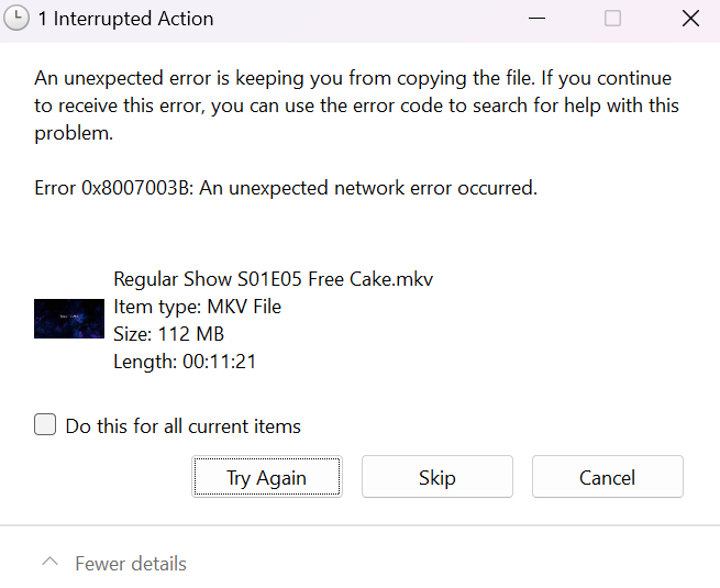

SMB was working fine a couple days after set up but now when I go to transfer files it will transfer a couple files then completely stall out at zero bytes per second waiting for it to fully time out I get this error
I also get a network error when trying to use file explorer on ZimaOS

Grab a file you want to transfer to ZimaOS then try to transfer it over SMB or File explorer on the ZimaOS control panel

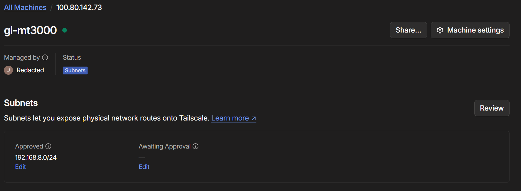

Phone/PC > 5G > Tailscale > Whatever tailscale nodes it jumps > Router(home network) > ZimaOS
But what it was trying to do was
PC > Tailscale > Direct connection using the public ip > Router > ZimaOS
Since my network doesn’t know how to handle nat hairpinning it was basically dropping but also sort of working? It was really weird. I don’t use the client since I already have a remote access network setup that doesn’t require port forwarding
I should clarify that the router is also running tailscale and is exposing my whole entire network subnet to my tailscale internal network. Which pretty much means any device connected to my account can access any device in my home network

What I think was going on was there was routing clashing. Please correct me if I’m wrong but if Zima client does routing table updates for windows that would interfere with tailscale since that also does routing table updates. Tailscale uses the IP range 100.64.0.0/10
When you expose subnets it routes that subnet through the host that is exposing it
