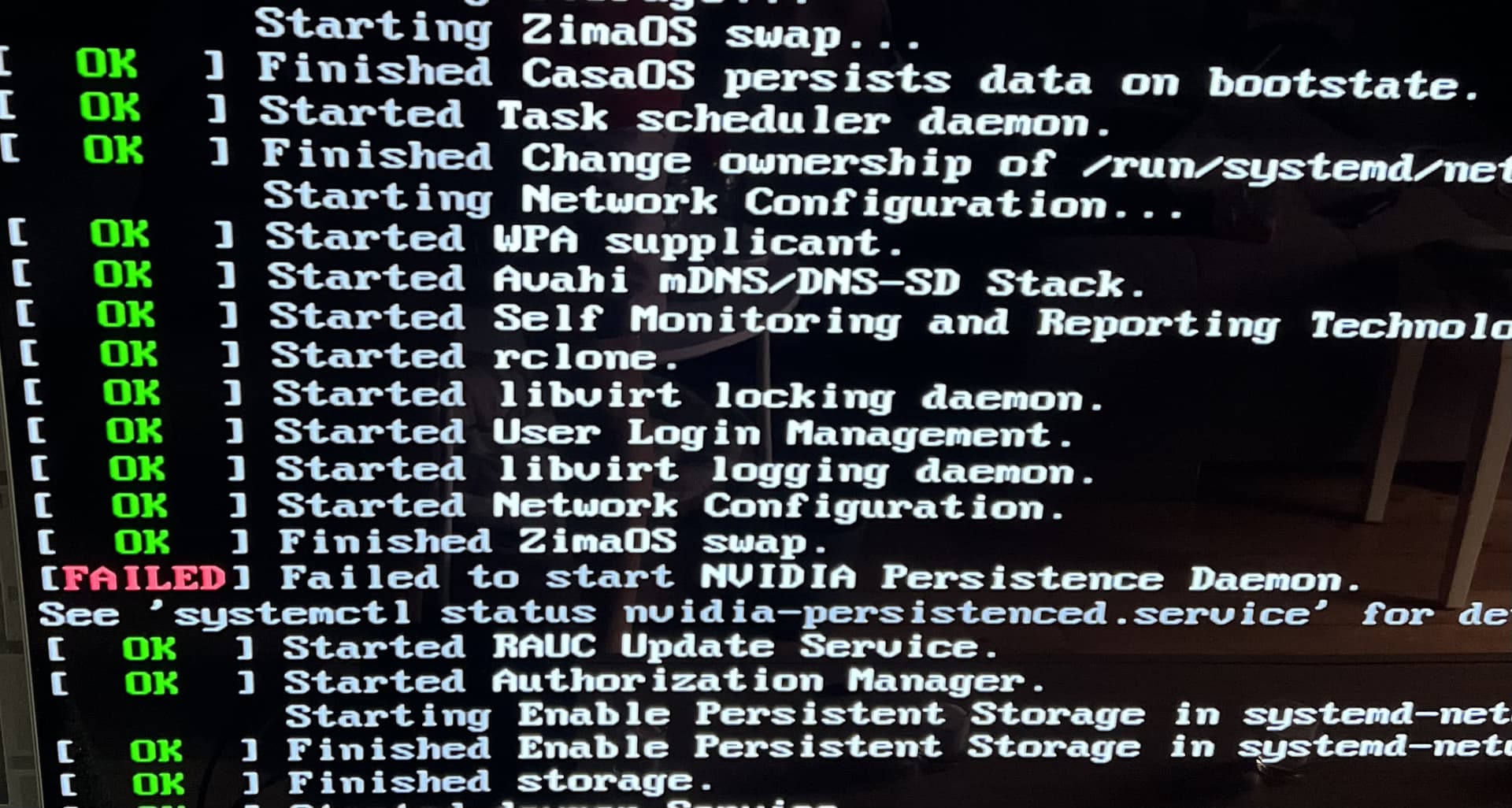

I have this error when booting (Failed to start NVIDIA Persistence Daemon)
Can someone help me?
