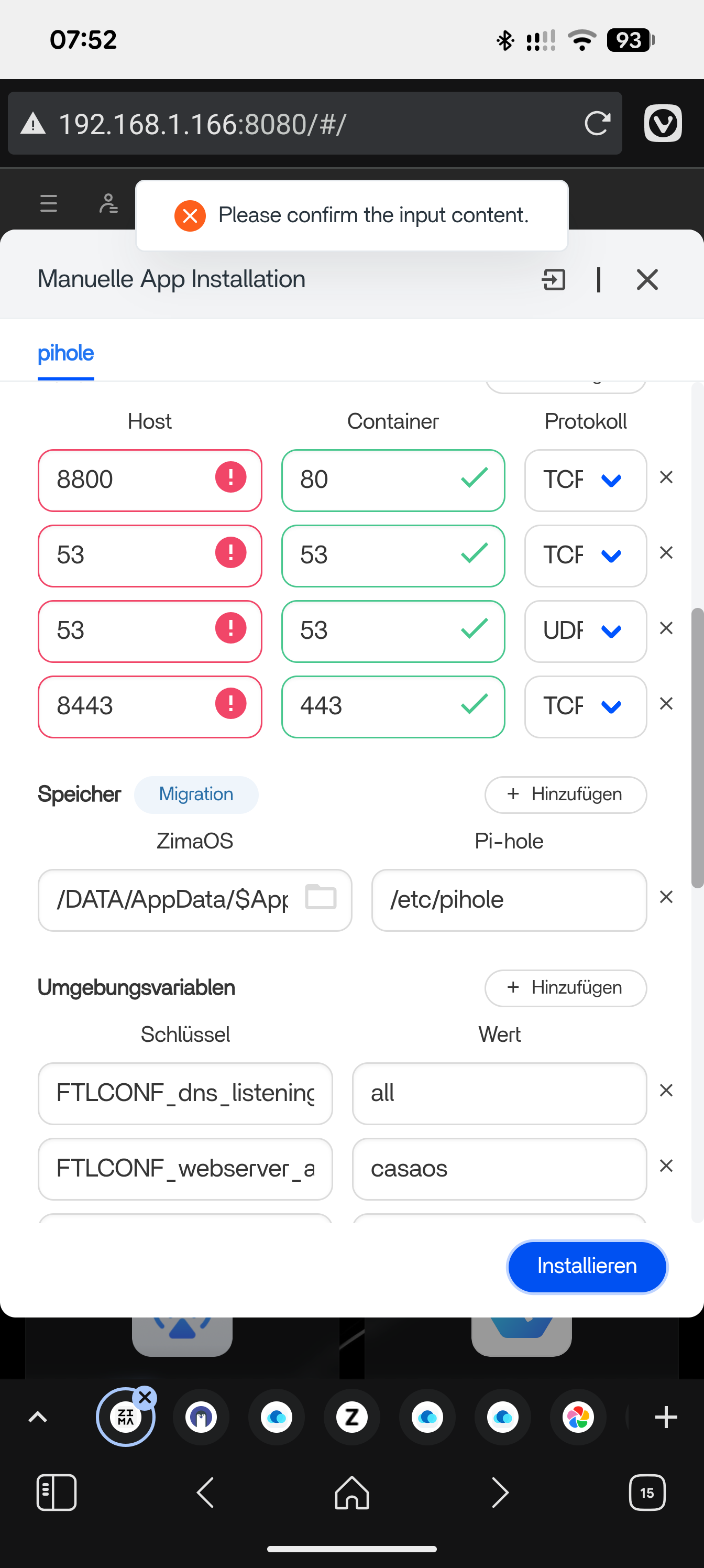

Hi, after the latest upgrade to ZimaOS 1.6.1, some applications have stopped working for me. Especially Pi-Hole and Nginx which means my apps are not accessible via the reverse proxy any longer.
I tried to uninstall and reinstall them but that doesn’t work. It shows, however, that the problem is with the port allocations. How can these ports now be in use by something else when before the upgrade they were used by these applications?
Here’s a screenshot from Pi-Hole during an installation attempt. How can this be fixed?
Hi, can you try reinstalling again now?
In some cases after the upgrade, the ports may not be released immediately, so Pi-hole or Nginx will temporarily report that the ports are already in use. Usually after waiting a short while and retrying, the ports will be released normally.
Please try again and let us know if the issue still exists. If it still fails, please also send us the exact port conflict message or a screenshot so we can help investigate further.
OK, thanks for the comment. I did the update 3 or 4 days ago. It required another system restart for the ports to be released. The apps are back working now. Thanks for the hint!
