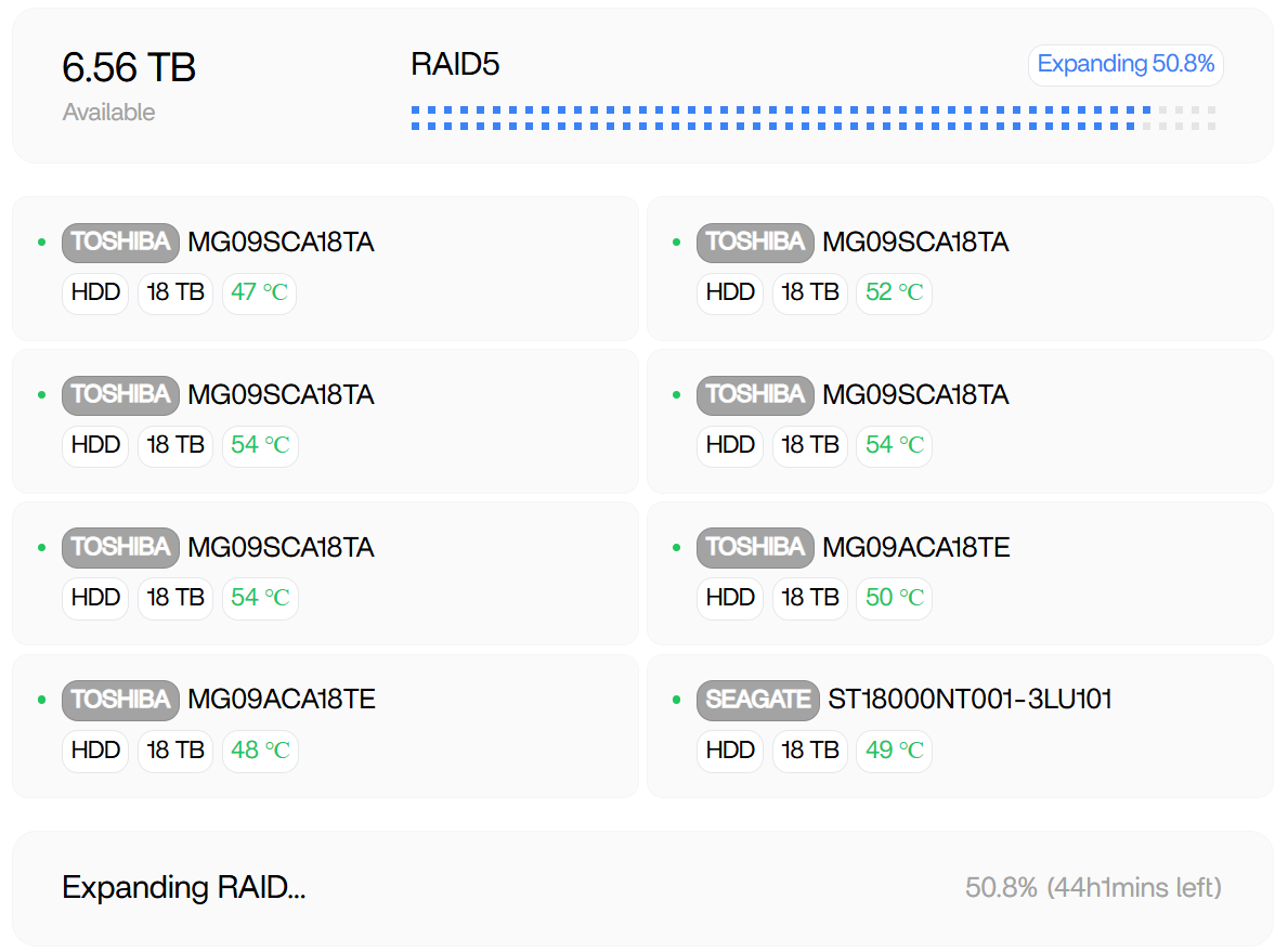

I recently installed ZimaOS 1.5 Plus, which I bought to support the Developers, to setup my DIY NAS.
Started with 5x 18TB disks in a Raid 5 config and all was fairly normal, until a few days ago I added 3 more 18TB disks and pressed Expand Raid.
Big mistake…
Expansion process is been going on for several days now, still only 44% done on an estimated 90+ Hours process.
My NAS is severely blottlenecked now in performance and I probably have 4 or 5 more days to go until this finishes, assuming this goes error free?
Apps like Plex that relly on large media files are buffering every 10 seconds when I watch a movie from the NAS, for example.
Surely this delay is not normal? Or did I do anything wrong? The disks are all fine without any bad sectors.
I have never seen anything like this on my other NAS system, like Unraid or TrueNAS.
Expansion would take a day, tops. Not even close to a week.
Thanks

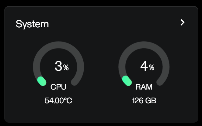

I believe it is not the hardware resources.
Currently it shows very low usage.
I’m runnig a modern HBA card (LSI 9500) that worked well with my other NAS systems, like Unraid.
I only have a couple of Apps running, like Plex, but currently I have stopped all of them to see if it improves performance somehow.
Let’s see. I see no errors anywhere, just a massive waiting period.
Guess I just need to wait 2 or 3 more days :frowning:
Good sign overall, the system isn’t overloaded, and the HBA is handling the drives fine. What’s happening is simply the RAID expansion process itself being extremely I/O intensive, not CPU or RAM bound.
Even with an LSI 9500 and 126 GB of memory, the rebuild speed depends on how fast each disk can read/write in sequence. Eight × 18 TB drives means hundreds of terabytes of parity data to recalculate, so it’s perfectly normal to see 2–4 days total duration.
You’ve done the right thing by stopping Plex and letting it finish undisturbed. Once it completes, performance will return to normal, nothing wrong with your setup, just a long expansion window.

Just sharing that since stopping all the apps, the % went from 44% to 90% in 12 hours.
Definitely a big improvement from before.
Probably will have this expansion finished later today.
Just finished finally.
Word of advice to everyone, if you extend your raid, stop all apps and VM’s first.
It will go way faster.
How long did it take in the end for you? A week?
5 days in total.
