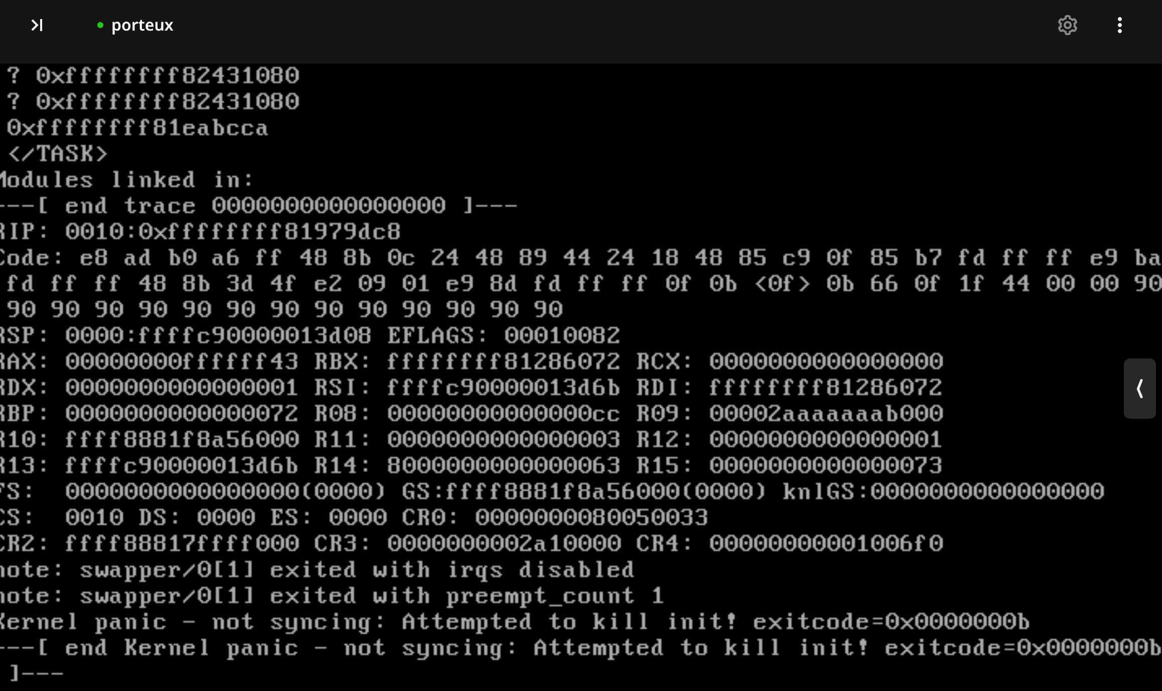

So meanwhile here is the screenshot at least -
Thanks, the screenshot is useful. It confirms the guest kernel is crashing during early boot with:
Kernel panic - not syncing: Attempted to kill init! exitcode=0x0000000b
No problem if you are not familiar with the VM configuration. You have already provided the most important comparison: the same guest works on ZimaOS 1.6.1 with kernel 6.12 but crashes on 1.6.2 with kernel 6.18 on the J1900.
I believe this now needs IceWhale to check the QEMU CPU configuration generated by ZVM and test the kernel change on older Bay Trail hardware. For now, staying on 1.6.1 appears to be the safest workaround.

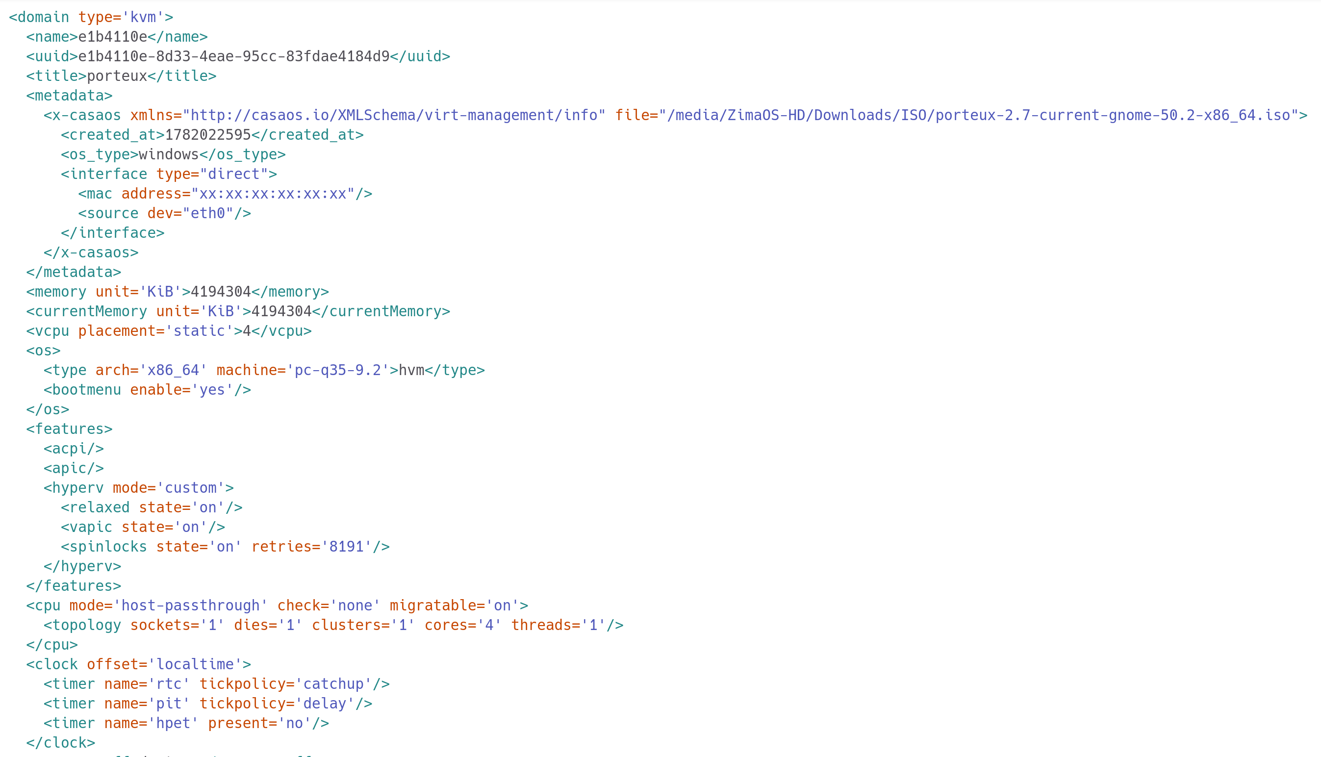

now, found this xml file in the /etc/libvirt/qemu directory, which looks like configuration for the shown porteux OS VM.
There is a line mentioning
arch=‘x86_64’ machine=‘pc-q35-9.2’
but why says <os_type>windows</os_type> ?
The exciting thing is, this same OS image is running on J1900 + 1.6.1 and N100 + 1.6.2 without a hitch!
e1b4110e e1b4110e-8d33-4eae-95cc-83fdae4184d9 porteux 1782022595 windows 4194304 4194304 4 hvm destroy restart restart /usr/bin/qemu-system-x86_64

Thanks, that XML clears up an important point.
The windows value is only inside ZimaOS/CasaOS application metadata:
<metadata>
  <x-casaos ...>
  </x-casaos>
</metadata>
It does not control how QEMU boots the guest. Libvirt permits applications to store their own information in the <metadata> section. The actual VM type is defined here:
<os>
  <type arch='x86_64' machine='pc-q35-9.2'>hvm</type>
</os>
More importantly, your CPU configuration already shows:
<cpu mode='host-passthrough' check='none' migratable='on'>
So the previously mentioned migratable=on workaround is already enabled and does not resolve this case.
The comparison remains significant:
  • J1900 with ZimaOS 1.6.1 works
  • J1900 with ZimaOS 1.6.2 panics
  • N100 with ZimaOS 1.6.2 works
  • The same PorteuX image is being used
I believe this points more specifically to a Linux 6.18 KVM/QEMU interaction with the older J1900 CPU rather than an incorrect guest operating-system selection.
No problem about the attachment restriction. Pasting the XML as text is enough, and this has already ruled out the migratability setting as the cause.
