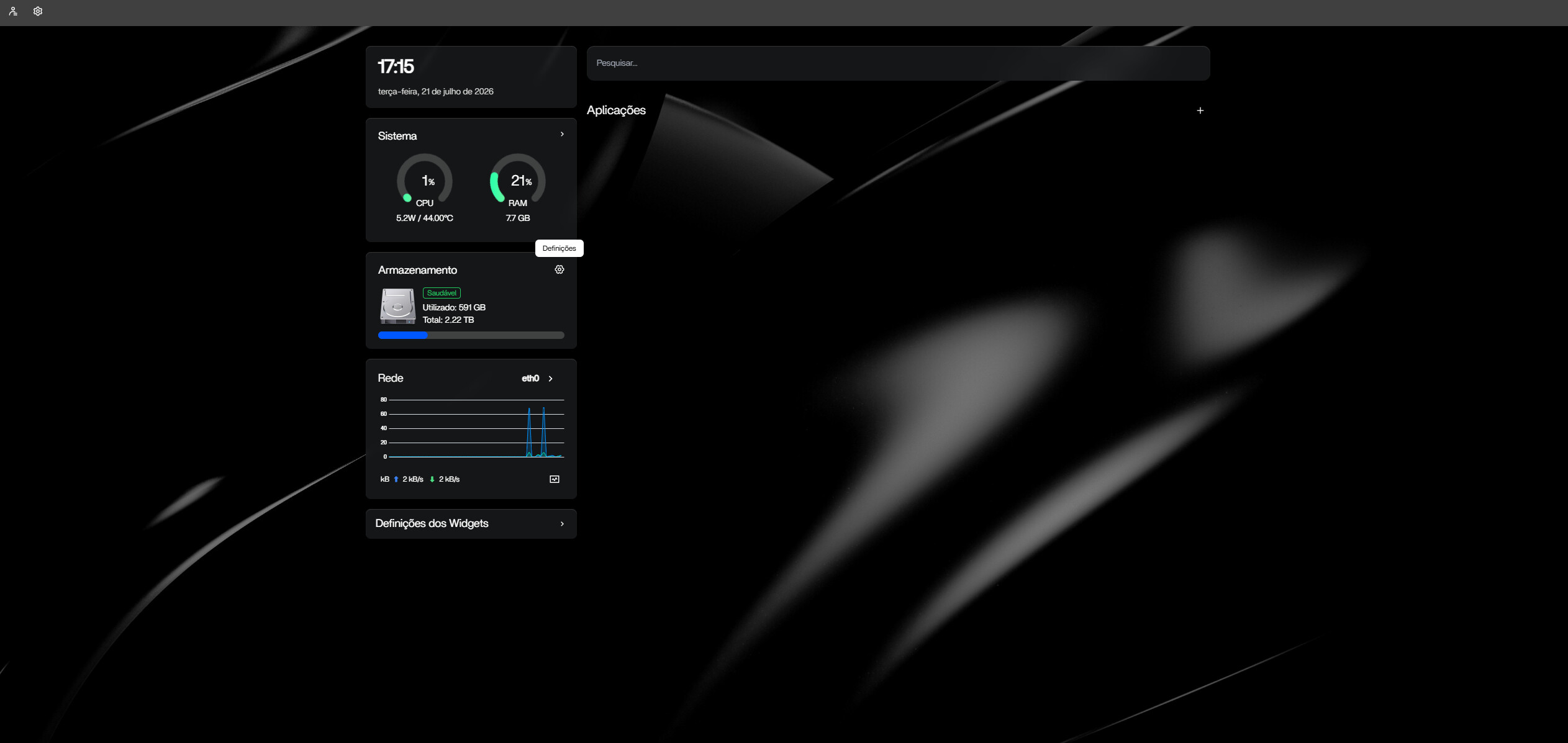

After installing beta version 1.7.0, all my apps and app store disappeared.
can you help please?
@luisgsi Are you using a sub-user to log in to the system? It would be better if you could add a screenshot.

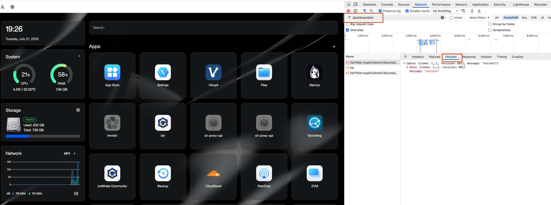

@joey Thank you for your feedback, Let me troubleshoot this problem. Can you help me open the browser debugging tool, filter the /dashboard/list request, and see what error is returned?

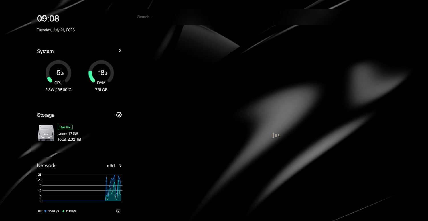

After the update all the apps where displayed, but after several hours, when i accessed again, it was empty.
