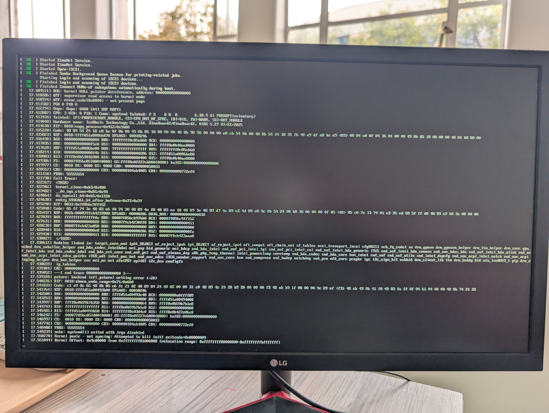

Escalation — corrupted overlay partition: Crash frequency accelerated to every 1-2 hours. Eventually a hard reset left the board unable to complete boot: journalctl -xb showed CasaOS overlay setup itself failing to start, and root/etc stuck read-only even after mount -o remount,rw (both / and the underlying /mnt/overlay ext4 partition). Nothing writable, including from rescue mode. This looked like corruption of the /etc overlay (upperdir on /dev/mmcblk0p7), likely from the accumulated hard power-cycles forced by all of the above.

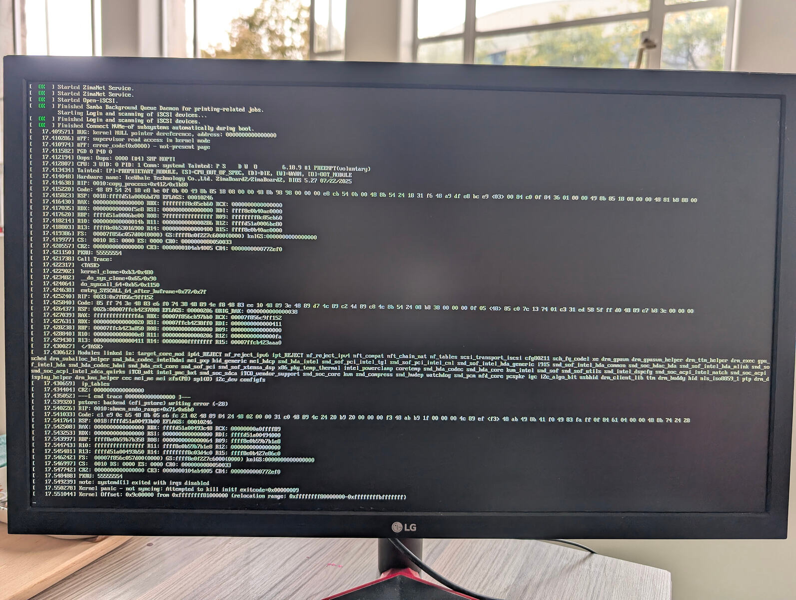

Full fresh reinstall: Reinstalled ZimaOS v1.7.0 from the official installer image onto the eMMC (NVMe left connected but untouched). On literally the first boot of the fresh, stock install — zero apps, zero config — it hit a full kernel panic:
This happened immediately after “Started ZimaNet Service” and “Started Open-iSCSI” in the boot log, while systemd was forking a new process.
Since then: repeated reboots have gotten progressively worse — from surviving ~7 minutes before freezing, down to freezing before the uptime counter even ticks past 0, sometimes not completing boot at all. Tested with the NVMe physically disconnected — crashes continued, so it doesn’t appear to be NVMe/storage related.
Where I’ve landed: this reproduces on a completely stock, freshly installed system with default config and no apps, so I don’t think this is anything user-side. I’ve emailed support directly with this timeline and the panic photo, and I’m stopping further hard reboots for now since each one seems to be making things worse, possibly further corrupting storage.

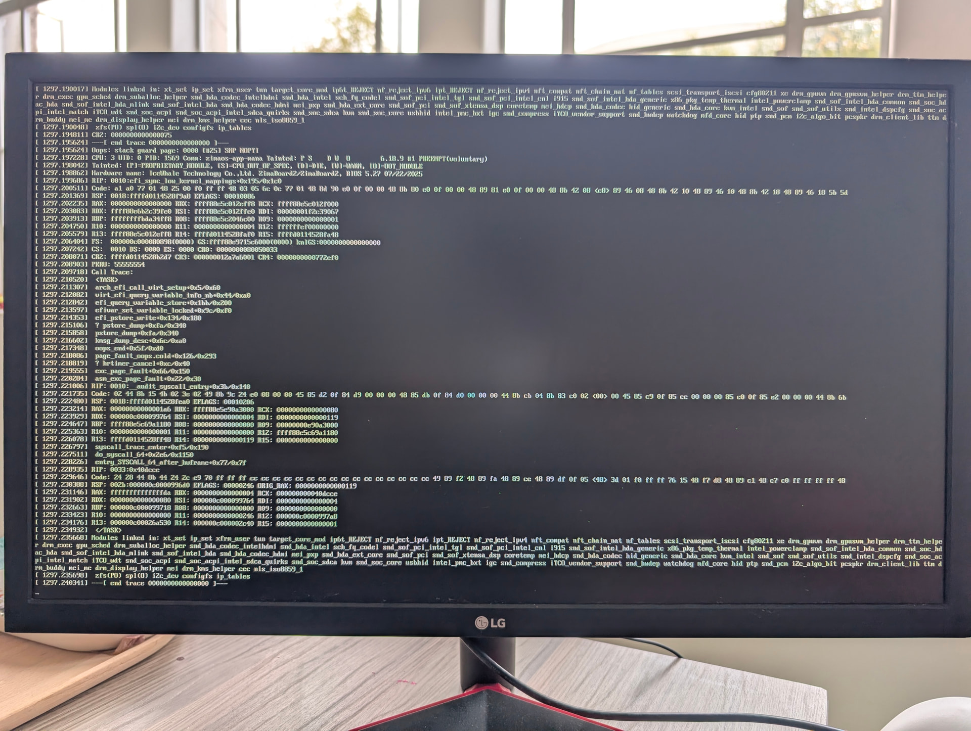

Update — found a clean, reproducible trigger.
After masking ZimaNet and the whole Open-iSCSI stack (znet, iscsid, iscsiuio, iscsi.service + their sockets), the board stayed fully stable over SSH — 19+ minutes idle, load average normal, no crashes. Best result all week.
The moment I opened the Web UI dashboard, it crashed within 2-3 minutes. Full trace this time:
Oops: stack guard page: 0000 [#25] SMP NOPTI
CPU: 3 UID: 0 PID: 1569 Comm: zimaos-app-mana Tainted: P S D W O 6.18.9 #1 PREEMPT(voluntary)
RIP: 0010:efi_sync_low_kernel_mappings+0x195/0x1c0
Call Trace:
arch_efi_call_virt_setup+0x5/0x60
virt_efi_query_variable_info_nb+0x44/0xa0
efi_query_variable_store+0x1bb/0x200
efivar_set_variable_locked+0x9c/0xf0
efi_pstore_write+0x134/0x180
pstore_dump+0xfa/0x340
kmsg_dump_desc+0x6c/0xa0
oops_end+0x5f/0xd0
page_fault_oops.cold+0x126/0x293
---[ end trace 0000000000000000 ]---
So: zimaos-app-mana (App Management backend) hit a stack guard page fault (stack overflow) the instant the dashboard was opened, and then the kernel’s own crash-dump handler (trying to write the oops to EFI pstore) faulted a second time while handling the first fault.
This is now the third distinct process to trigger a kernel-level fault across my testing this week:
  1. crudini/Python 3.14 interpreter (SIGSEGV, earlier posts)
  2. systemd/copy_process (NULL pointer deref, fresh-install first boot)
  3. zimaos-app-mana (stack overflow, triggered by opening the Web UI)
Three unrelated userspace processes all independently causing kernel-level faults suggests this isn’t one buggy service — more likely something at the kernel build or EFI/firmware interaction level (the failed efi_pstore_write path in particular looks like a known-troublesome area on some UEFI implementations). Reproducibility now looks like: idle + no ZimaNet/iSCSI = stable; open the Web UI = crash within minutes.
Happy to test anything specific if it helps narrow this down further — at this point I can reproduce a crash on demand just by opening the dashboard.

  1. General protection fault in PID 1 (systemd), task_dump_owner, ending in “Kernel panic - not syncing: Attempted to kill init!” — same fatal pattern as the panics I reported on 1.7.0
  2. DMAR/IOMMU fault directly tied to eMMC storage I/O: “DMAR: ERROR: DMA PTE for vPFN already set”, crashing inside intel_iommu_map_pages, called from the eMMC block-request path (mmc_blk_mq_issue_rqcqhci_request)
  3. An RCU stall (CPU core detected as unresponsive by the scheduler, requiring an NMI-forced backtrace), followed by another DMAR fault and an i915 display FIFO underrun error
Given this now reproduces across two different OS versions and two different kernel builds, with faults specifically tied to the eMMC storage controller and IOMMU mapping (not any particular app, service, or driver I’ve disabled), I don’t think this can be a ZimaOS software regression. This looks like a hardware-level fault — possibly the eMMC controller, memory controller, or IOMMU hardware path.
Given the device is essentially unusable on both the current and previous OS release, and given everything documented so far (kernel panics, installer write failures to the eMMC, and now IOMMU/DMAR faults tied directly to storage I/O across two kernel versions), I’d like to formally request this be treated as a hardware fault for warranty purposes. I’ve also raised a claim with shop@icewhale.org but haven’t heard back yet — would appreciate if this could help move that along, or if you can point me to the right next step.
Happy to share the photos of all three crash traces if useful.
