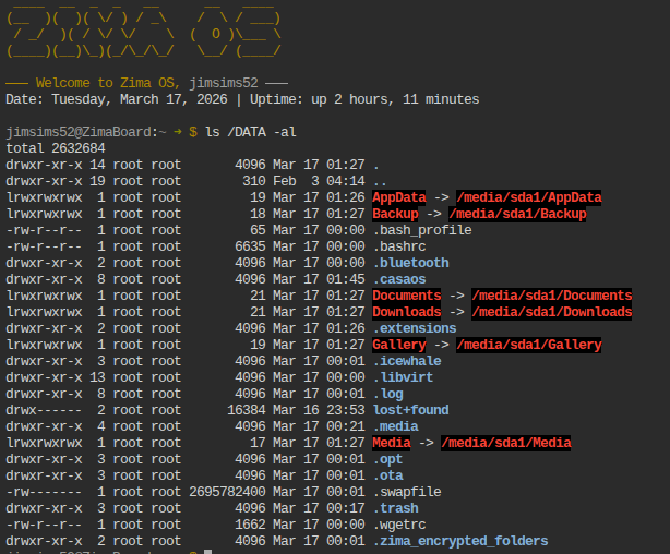

I did exactly as you suggested. ZimaBoard 832. Fresh ZimaOS 1.54 install….
migrate all data through Settings→Apps; Migrated: App data, App image, User database to
4GB SATA drive (SDA1) ( it showed that location when I hit Recommended Location button).

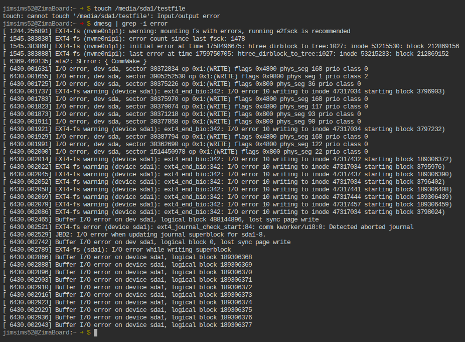

Got this in terminal:

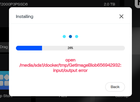

Tried to install Linkwarden and Syncthing from App Store. Got this errror during each install.
Is there something I did wrong?
Thanks for your help.
That error:
open /media/sda1/docker/tmp/...: input/output error
points to a disk issue on sda1, not a migration problem.

Quick check:
touch /media/sda1/testfile
If that fails, the disk isn’t healthy.
Also check:
dmesg | grep -i error
If you see I/O or EXT4 errors, that confirms it.
Your approach (moving AppData/Docker off /DATA) is correct — but the target disk must be stable, otherwise installs will fail like this.
If you can share the dmesg output, we can confirm exactly what’s happening.

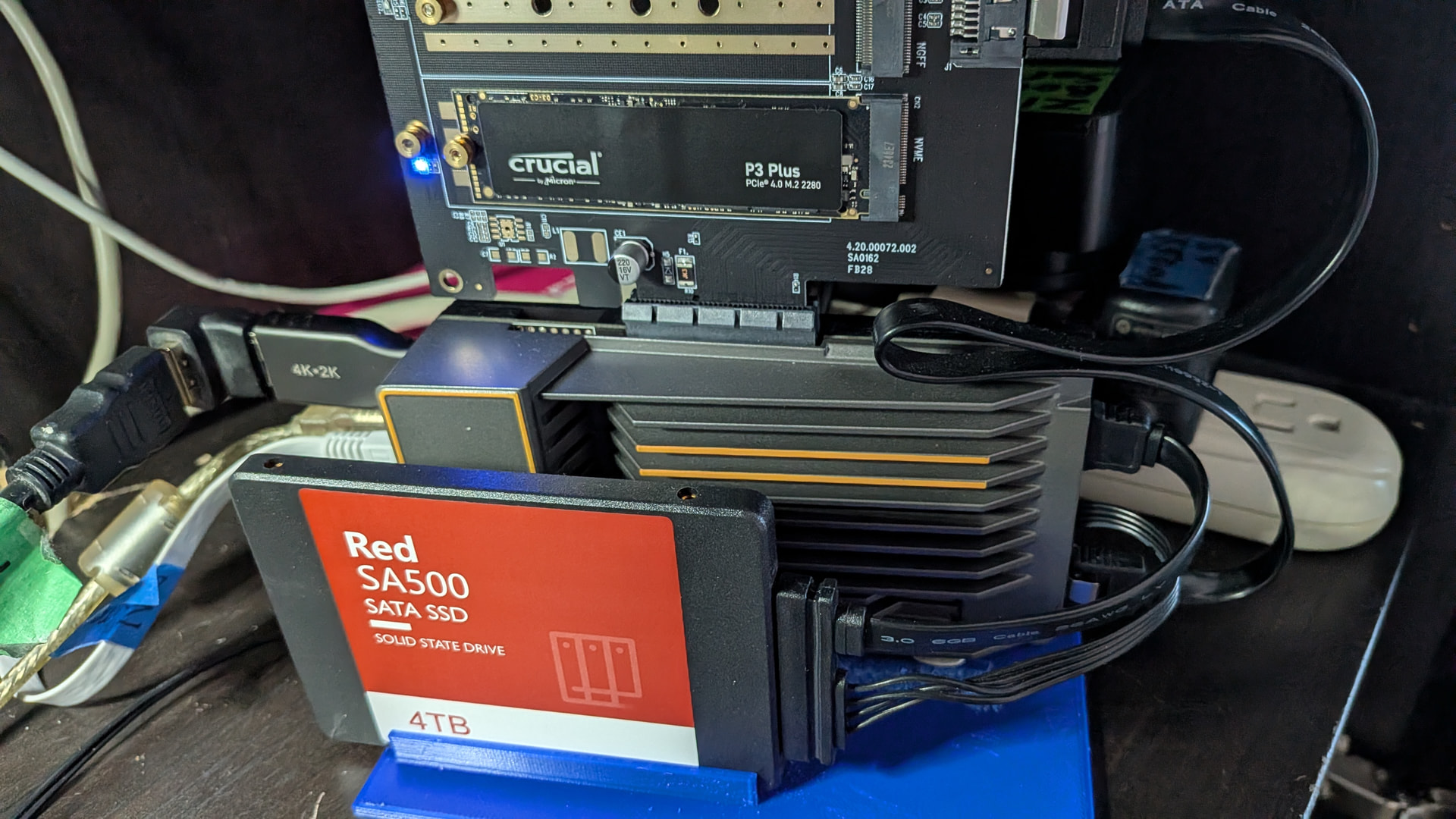

I was suspect of this SSD. I seemed too inexpensive for 4 Tb.
By the way. Your advice regarding Move AppData etc is right on and well delivered. Thanks
Thanks for sharing, this confirms it clearly.
You’ve got multiple:
I/O error, dev sda
EXT4 journal aborted
Buffer I/O error
And even a simple write fails:
touch /media/sda1/testfile > Input/output error
That means the SSD (sda1) is not healthy, this is not a ZimaOS or migration issue.
What to do
  • Reseat the SATA + power cable first (quick check)
  • If the errors persist > replace the SSD
That drive is currently not safe for Docker/AppData
Hardware today can be overpriced, but for a NAS setup it’s critical to use reliable, quality drives, otherwise you’ll run into exactly these types of issues.
Your approach was 100% correct, just unlucky with the target disk.
