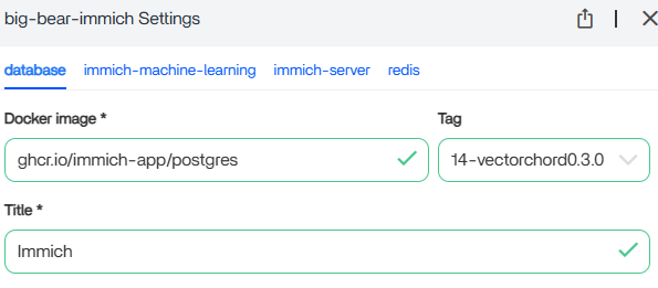

Hi

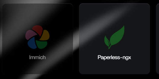

Immich just stopped working after ZimaOS 1.5.4 update and i can’t also look at log because the log&terminal icon is missing on immich container setting
and the app is also greyed
any advice?
PS: Immich is updated to the last version available

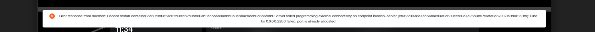

i tryied to restart many times and this meaasge appeared…where TF is stored the address 0.0.0.0??
After a good old sudo systemctl restart docker everything works fine

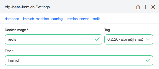

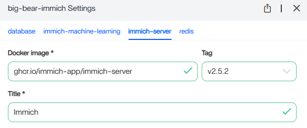

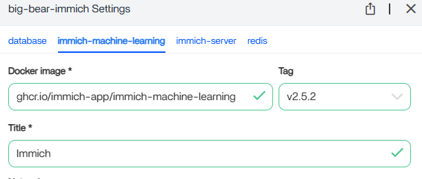

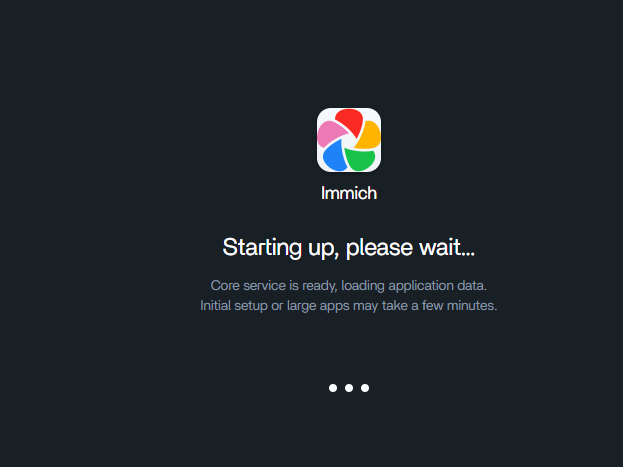

Tried sudo systemctl restart docker, that restarted a few other docker app that was having some issues but Immich is still not working after the ZimaOS 1.5.4 update. I get this error now, i am sure it is something simple - failed to start compose app, please check the compose app status. this has been going for a along time, going to kill it soon.
La ultima actualización de immich con la ultima versión de ZimaOS provoca este error. Yo también he intentado lo que mencionan en este hilo y todo lo que se me ha ocurrido, pero he tenido que volver a la versión anterior de immich. Al ser un problema general, espero que alguien de con la solución y lo comparta.
which immich version are you mentioning?
Well, i gave up trying to figure what happen and why i can’t get this back running, reinstalled, the program, recopied my picture back in, yep, back up and back up on the photos, just need to add the new ones in. Hope someone else with more time and expertise can figure what happen and help the others and to the other who tried to help, thank you for information.
one last bit of information that may help, i tried dockhand after i updated ZimaOS to the current version and that where some of the app went sideways. Dockhand looked good, but i guess i am not ready for it yet. will revisit dockhand in the future.
