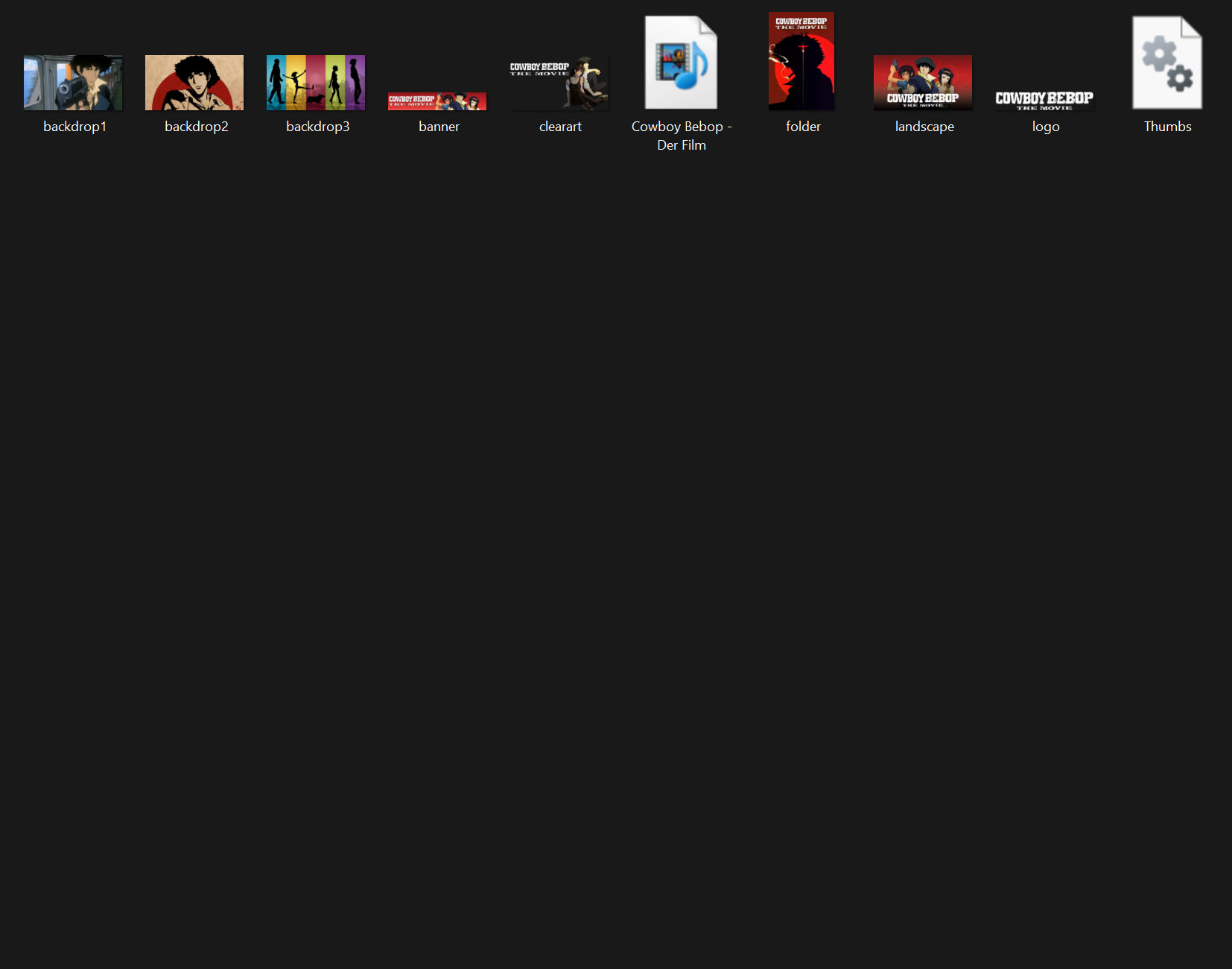

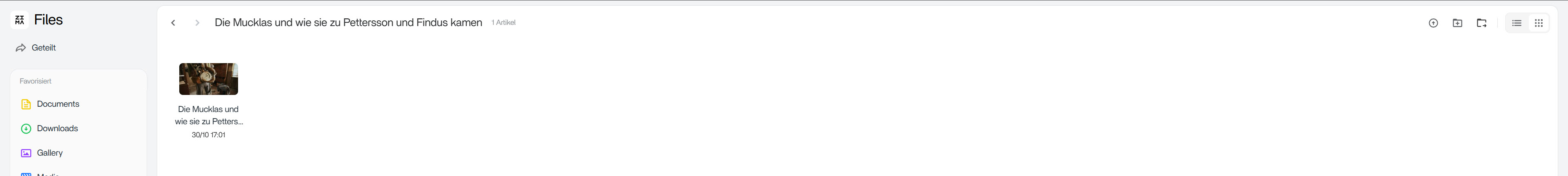

Currently, covers, logos, background images, etc., are always saved on the ZimaOS hard drive in the Jellyfin folder.
I want it to work the way it did when I was using Proxmox.
For example, the movie Dune… Dune is on an external hard drive, and the media data—logo, cover, etc.—should be saved in the Dune folder where the movie is located.
And not on the ZimaOS hard drive.
Here’s an example; I’d like to have it like this again.

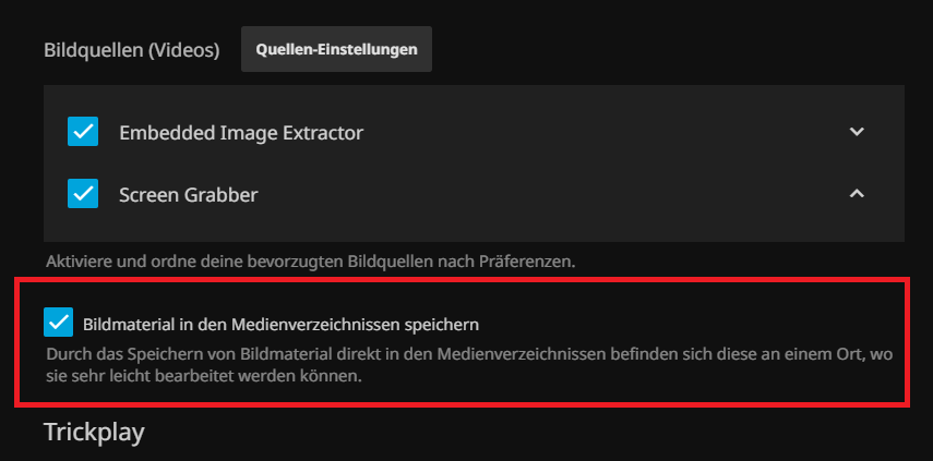

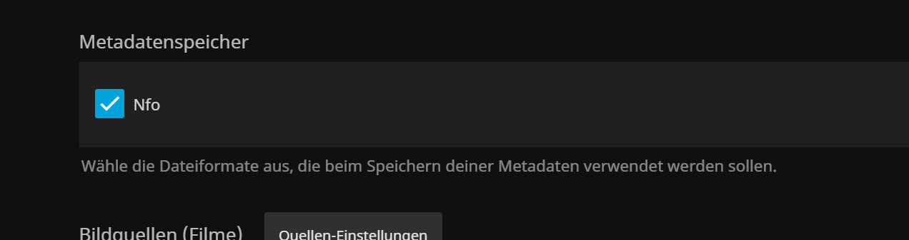

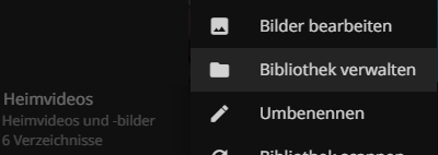

How to save artwork and metadata in the media folders in Jellyfin
By default, Jellyfin stores all artwork (covers, logos, fanart, etc.) in a central metadata directory (e.g. /config/data/metadata). If you want the images to be saved directly in the same folder as your media files, you can enable this option in the library settings.
Steps:

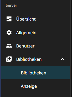

  1. Open the Jellyfin Dashboard.
  2. Go to Libraries and select the library you want to change.
  3. Click Edit.
  4. Scroll down.
  5. Enable “Save artwork into media folders”.
  6. Save your changes.
  7. Run a library scan (with “Find missing metadata” or “Replace all images”) so Jellyfin writes the artwork into the media folders.
Important note:
Even with this option enabled, Jellyfin does not always save all artwork reliably into the media folders. Some files may still end up in the central config directory, depending on the Jellyfin version and library setup. For full control, many users rely on external media managers (like TinyMediaManager or MediaElch) to ensure all artwork is written directly into the media folders.
Thanks for the quick reply.
I’ve already activated it, and it’s working, but unfortunately it’s still not working.
I’ve also already deleted all the pictures from the Jellyfin folder and searched again, but it’s still not working. They’re still being saved in the Jellyfin folder, now over 10GB.

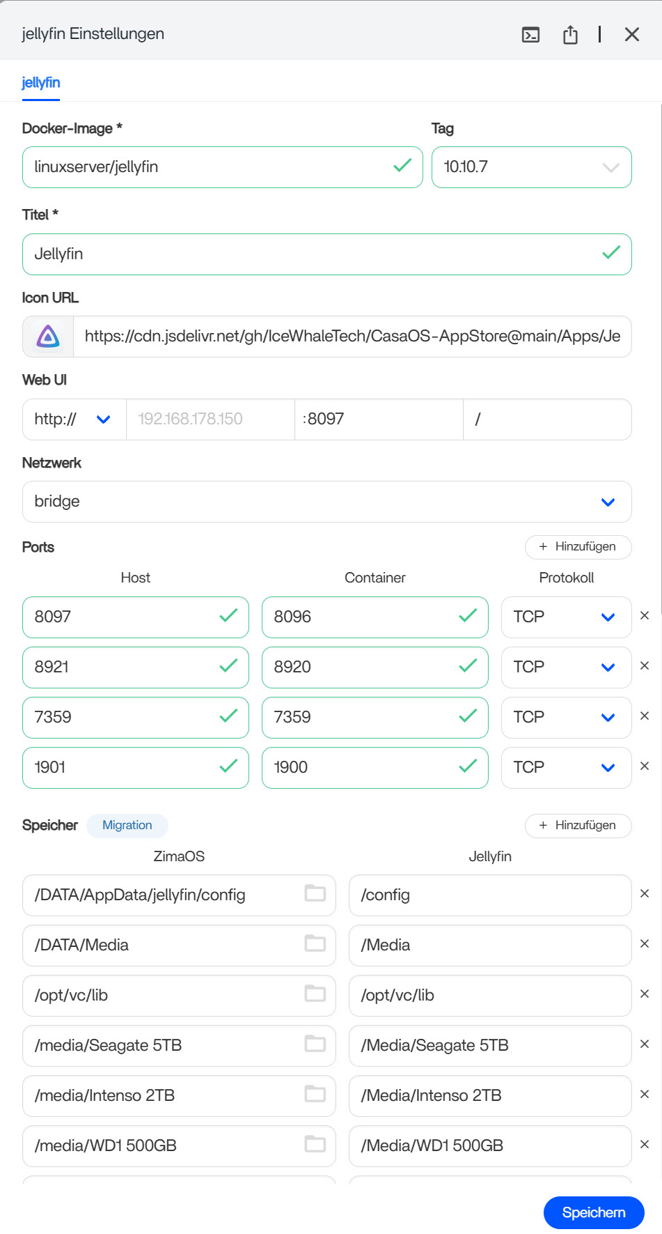

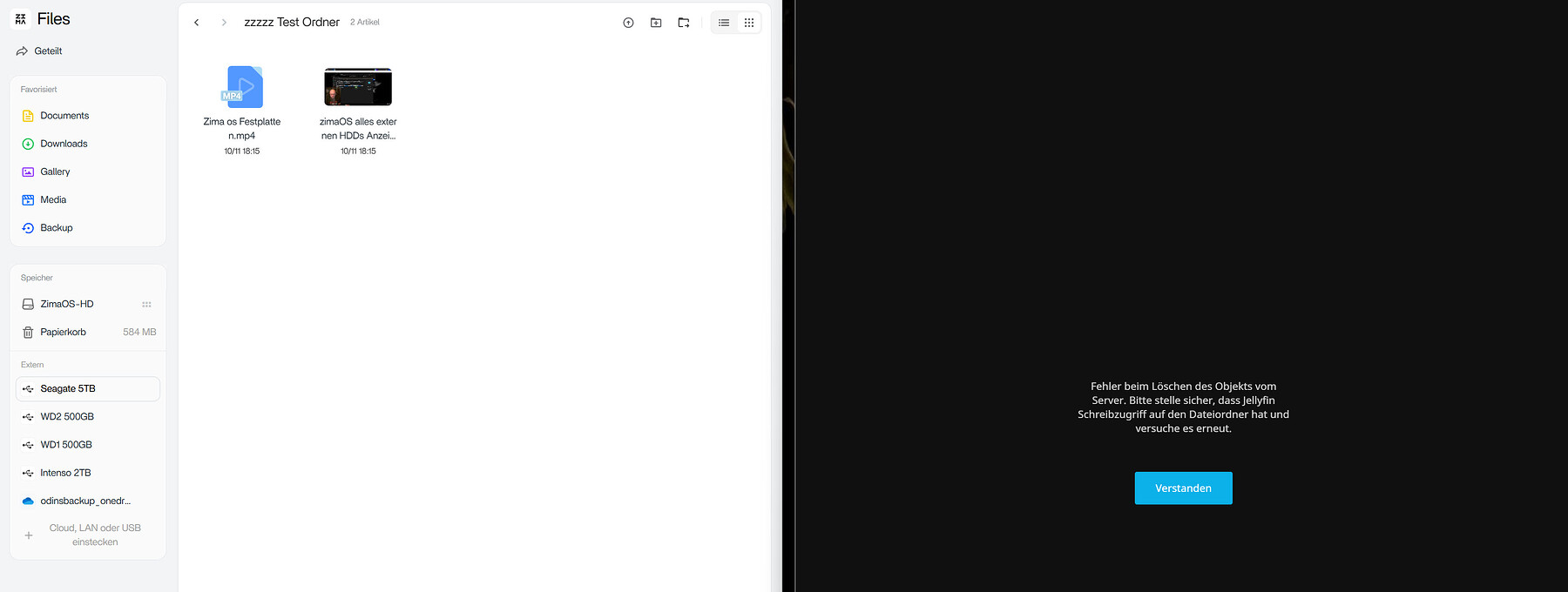

Does Jellyfin have full access to your drive, or is it mounted read‑only?
How can I see that?

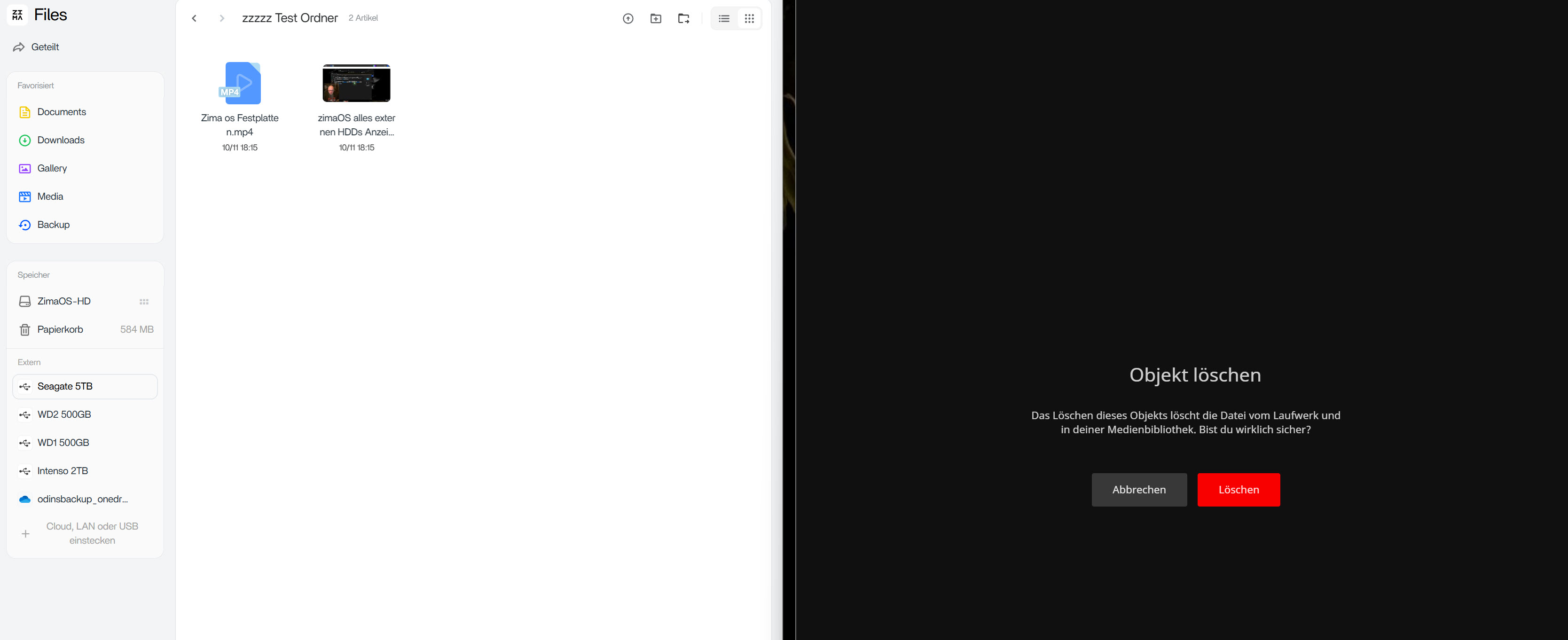

Try copying a video file into the media folder and then delete it from within Jellyfin.
If Jellyfin can delete the file, it has write access. If the deletion fails or throws an error, the folder is likely read‑only.
Jellyfin can’t be deleted :frowning:
Is there any way I can enable it?
Or should I reinstall Jellyfin?
What do I need to be aware of?

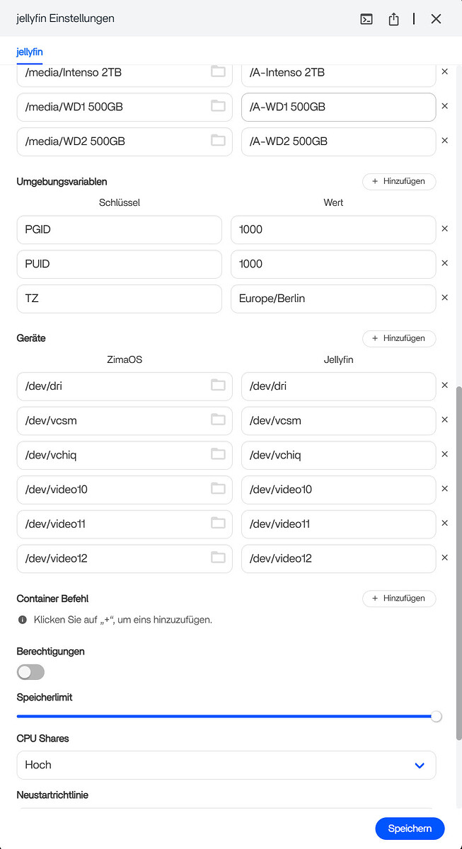

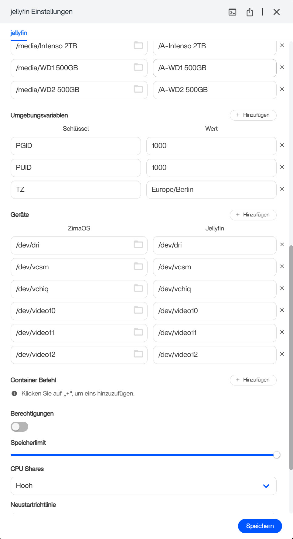

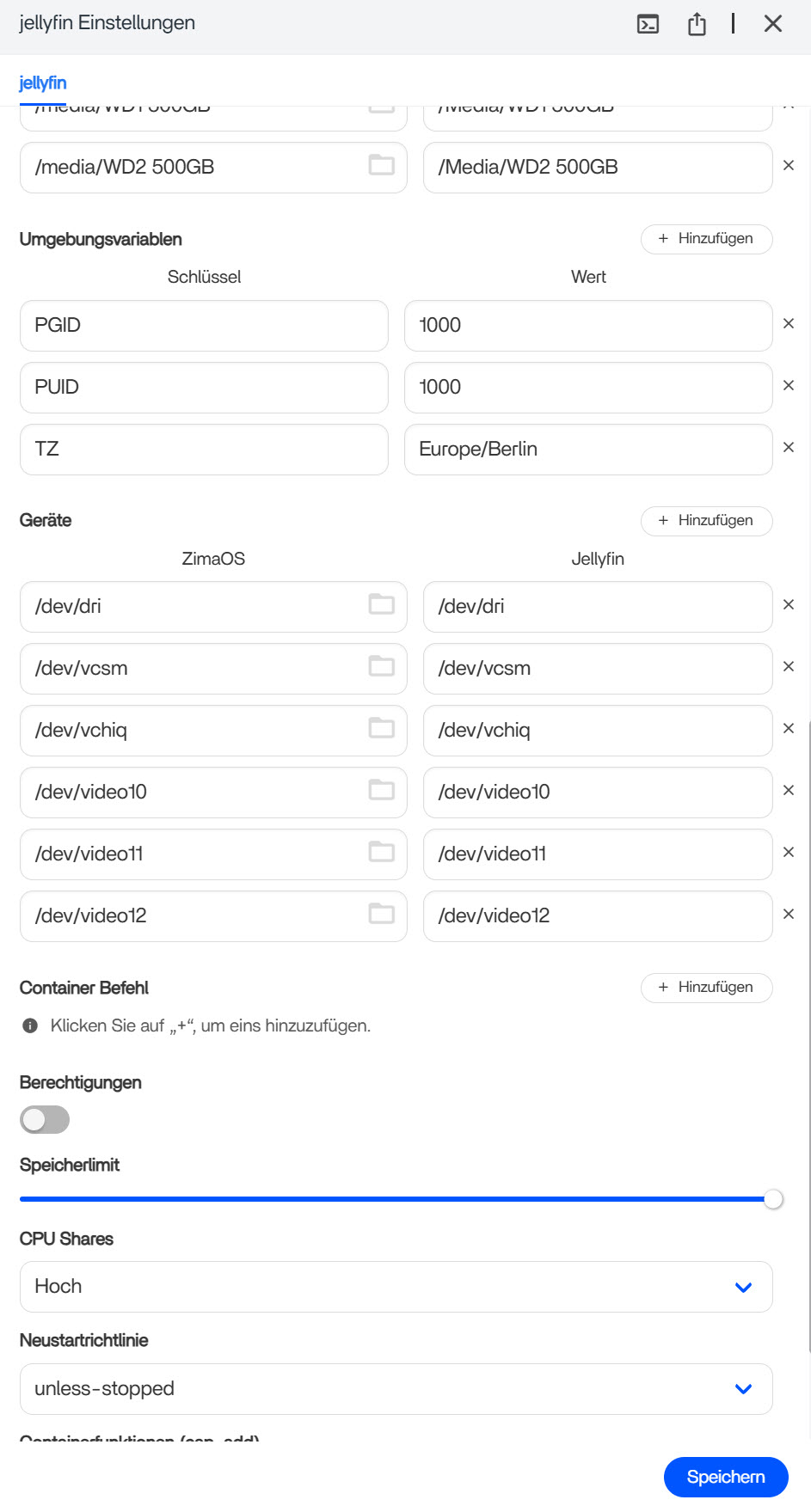

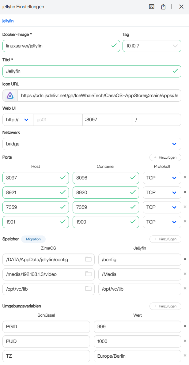

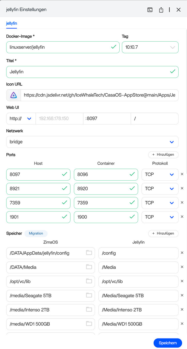

Which settings do you have under environment variables? Click on the three dots in the Jellyfin app under ZimaOS, then go to Settings. Try setting PUID to 999 and PGID to 1000.
Both are set to 1000.
I’ll test it immediately.

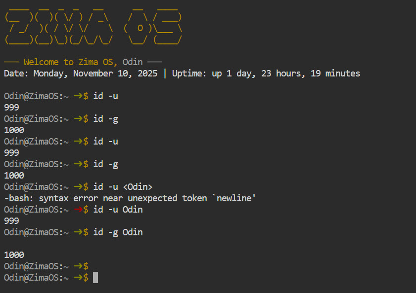

You can use the CLI commands id -u <username> and id -g <username> to find out the IDs.

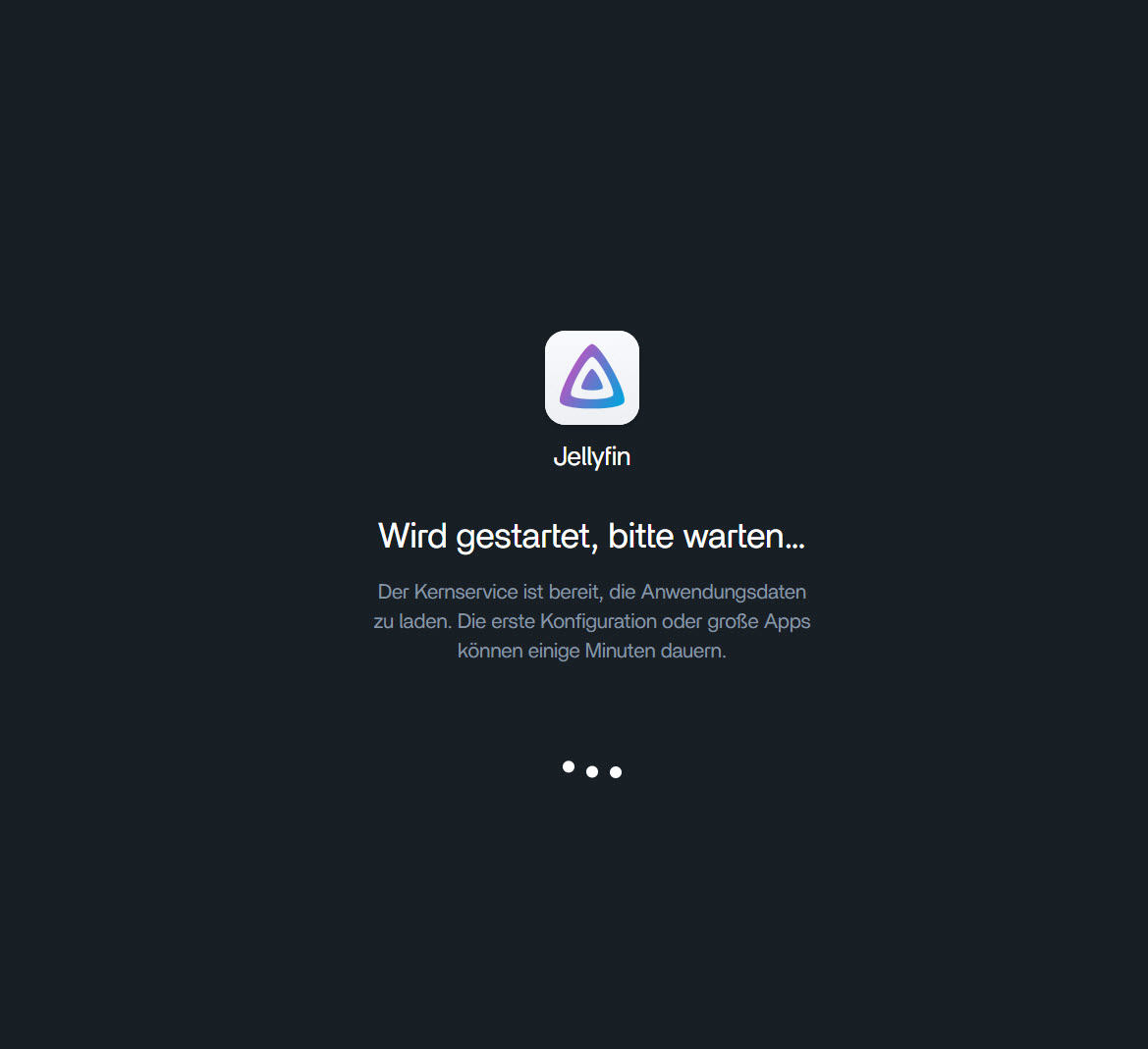

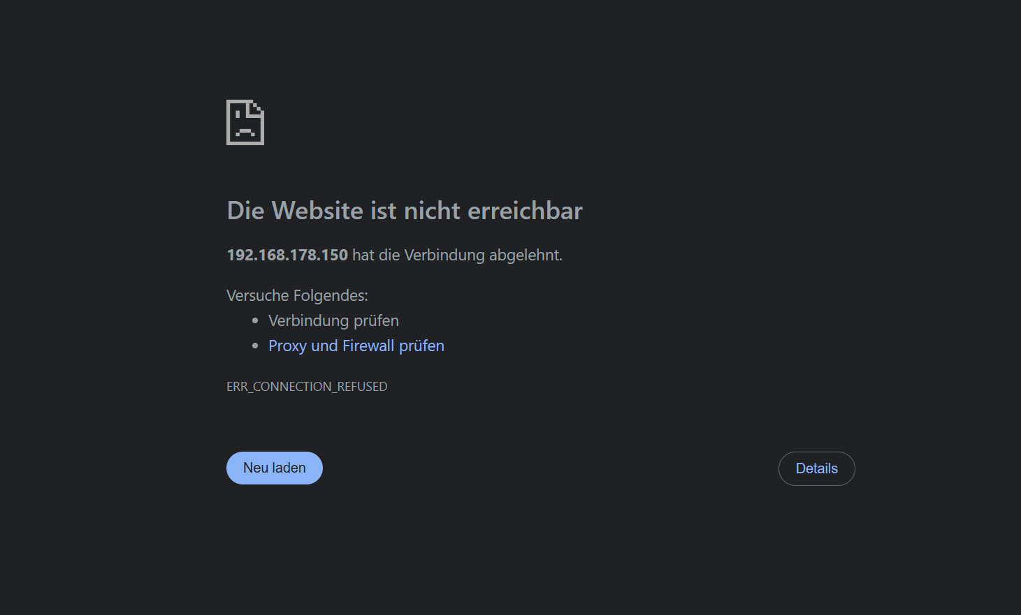

Jellyfin won’t start anymore.
I googled PUID and PGID
and found some commands to test:
id -u for your PUID = 999
id -g for your PGID = 1000
So, basically, it’s correct with
PUID = 999
PGID = 1000
It starts, but I can’t get in.
wie sieht dein stack aus?
das ist meins

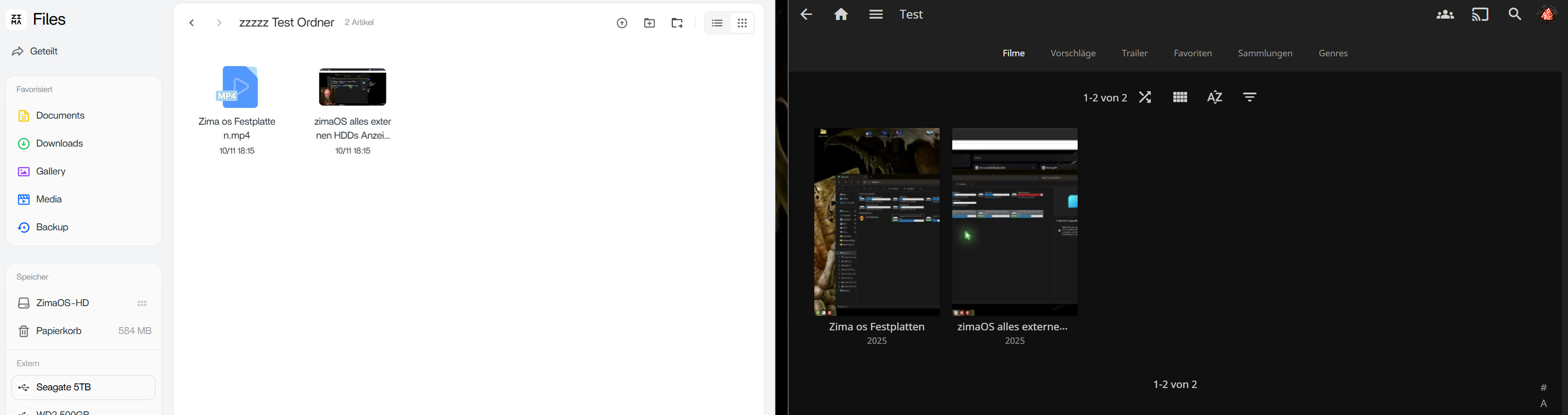

hab glaube was gefunden ebend gings bei einer plate teste jetzt grad die anderen
Hab jetzt einiges getestet alle bis auf eine Festplate geht
files/ZimaOS-HD kann ich bei der Plate löschen und schreiben
per SAMBA geht auch alles
wenn ich sie am PC habe auch
nur in Jellyfin geht kein Löschen
hab die gleiche auch mit 6TB die geht auch bei mit Jellyfin
hatte erst gedacht weil meine dirckt in Jellifin angebunden sind
z.B /WD1 500GB und bei vielen und auch bei dir ist es
/Media/WD1 500GB
so ging meine Test plate hab es dann mit allen so gemacht und
noch mal getestet alle gehen nur die Seagate 5TB nicht
so eine scheisse der ganze stress nur weil die plate irgendwie
nicht mit Jellyfin mag
die Seagate 6TB geht und es ist exakt die selbe nur 1TB unterschid
hast du das Problem gelöst? Bei dem Bild oben hab ich anstelle PUID die PGID auf 999 umgestellt. Stelle PUID auf 999 und PGID 1000, danach diese Befehle ausführen:
sudo chown -R 999:1000 /DATA/AppData/jellyfin/config
sudo chown -R 999:1000 /media/Seagate 5TB usw., weiß aber nicht ob die Leerzeichen gut sind. Eigentlich solltest du beim Einbinden von Laufwerken keine Leerzeichen verwenden, nimm _ oder - oder schreibe es zusammen. Ich kann jetzt Videos löschen.

ja jetzt geht alles
ich habe die Plate an den pc angeschlossen formatirt und gelöscht und einen neuen datenträger restellt
dann wider angeschlossen und getstet und alles ging :slight_smile: ich weis nicht was die plate für ein problem hatte.
