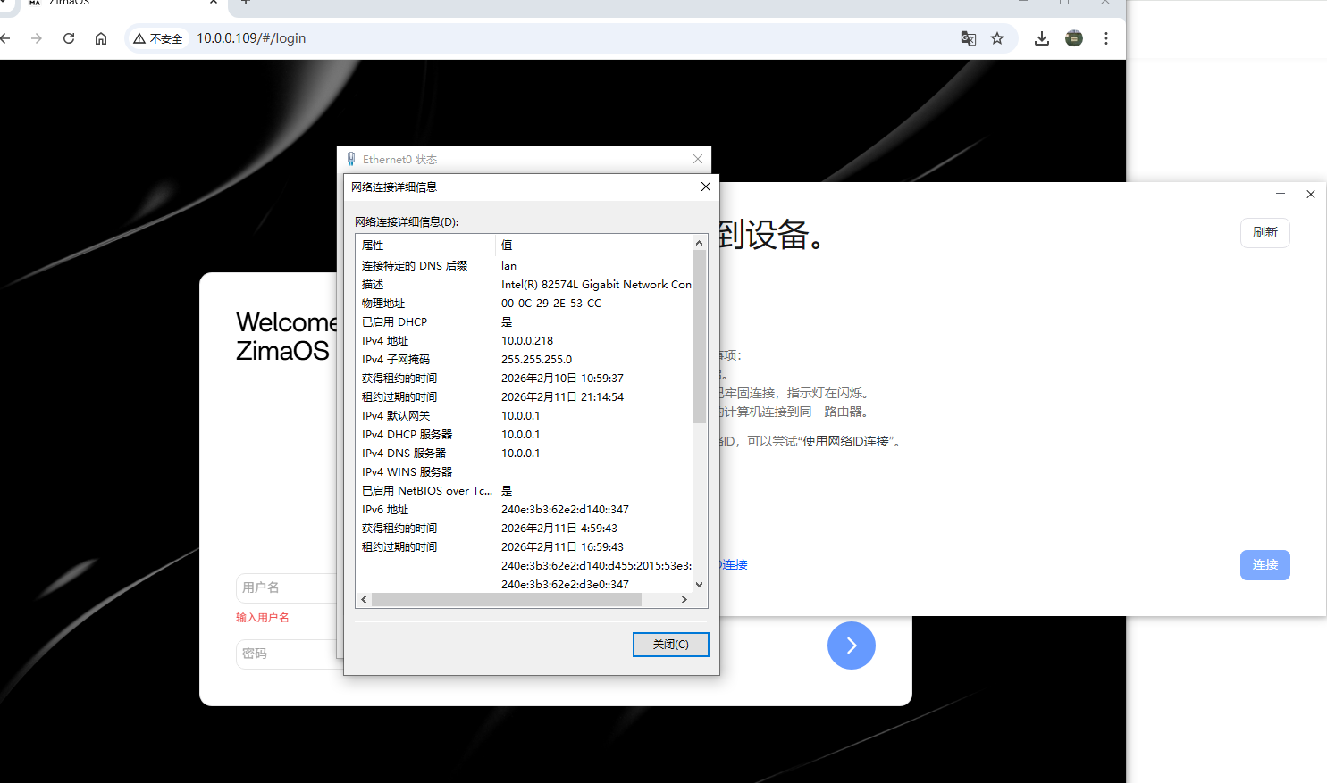

I just don't get it—why can't the client just let me manually enter the LAN address?
My Windows client and ZimaOS are on the same LAN, but the auto-discovery fails completely. What’s worse is that I can’t even manually enter the local IPv4 address. Are you really forcing me to use a Network ID and go through a ZeroTier virtual NIC just to connect locally? This design logic feels way too aggressive.

To follow up and provide some hard evidence—I’ve performed a full-stack diagnostic to prove this isn’t a “network issue,” but a “discovery logic” failure. Here is what I’ve verified:
  • Service Layer: Ran ss -tulnp | grep -E '80|443|9527' on ZimaOS. All core services are listening on 0.0.0.0, NOT just localhost.
  • Routing Layer: ip addr and ip route confirm the device is sitting exactly where it should be on the local subnet.
  • Access Layer: From my Windows host, Test-NetConnection 10.0.0.109 -Port 9527 (as well as 80 and 443) returns TcpTestSucceeded: True.
The “pipe” is wide open. I can reach the ports and see the services, yet the client remains blind.
Are you guys relying on Windows NLA (Network Location Awareness) or specific mDNS/Avahi broadcasts that struggle with multi-homed environments? If NLA is misidentifying the network profile, it might be blocking the discovery layer entirely.

PS C:\Windows\system32> Test-NetConnection 10.0.0.109 -Port 443
ComputerName     : 10.0.0.109
RemoteAddress    : 10.0.0.109
RemotePort       : 443
InterfaceAlias   : Ethernet0
SourceAddress    : 10.0.0.218
TcpTestSucceeded : True
PS C:\Windows\system32> Test-NetConnection 10.0.0.109 -Port 9527
RemotePort       : 9527
PS C:\Windows\system32> Test-NetConnection 10.0.0.109 -Port 80
RemotePort       : 80
