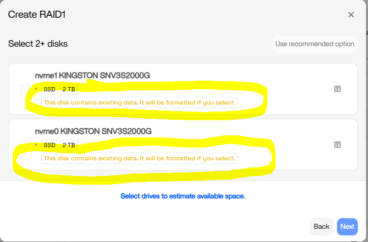

I have two identical NVMe drives (2TB each, same brand etc). Initially I added them both thinking I might use the space (4TB) but nah, I think 2TB of RAID 1 will be better. So I disabled the drive that has nothing on it, then went to create RAID 1, but it says it will format both drives (!).
Is there a way to simply mirror nvme0 to nvme1 as RAID 1?

Yeah unfortunately the current RAID creation flow in ZimaOS is still “create from scratch”, not a true live mirror conversion like Synology’s SHR migration or mdadm grow/migrate workflows.
So the warning you’re seeing is expected right now, even if only one disk actually contains data.
Since both disks get added into a brand new RAID1 array, ZimaOS treats them both as needing initialization and formatting first.
Your backup → create RAID1 → restore approach is honestly the safest and cleanest method at the moment, even if it feels a bit clunky.
