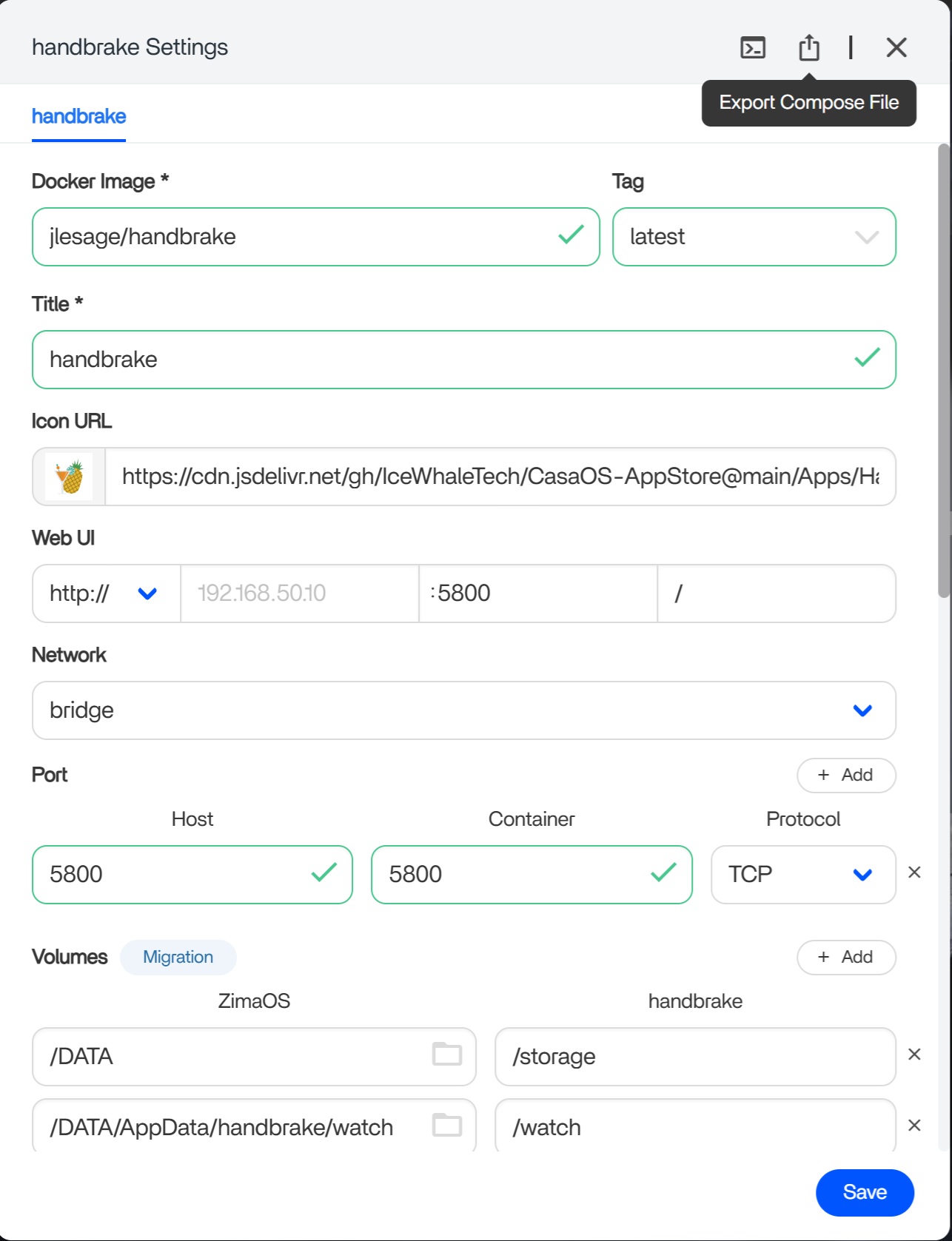

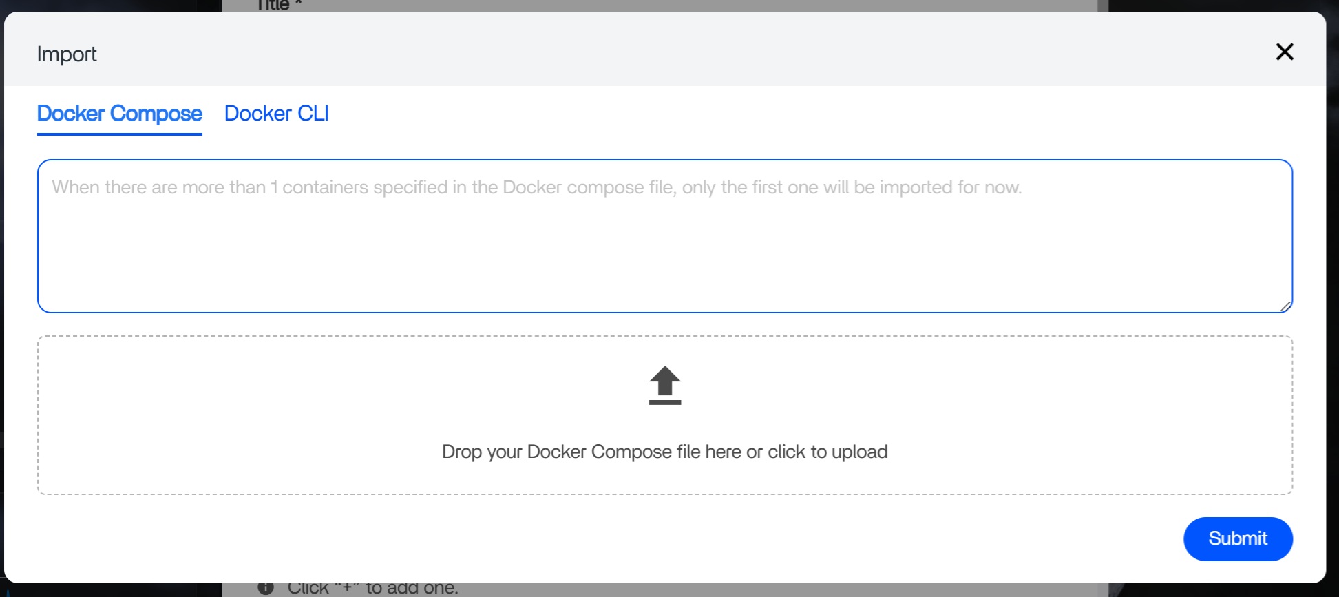

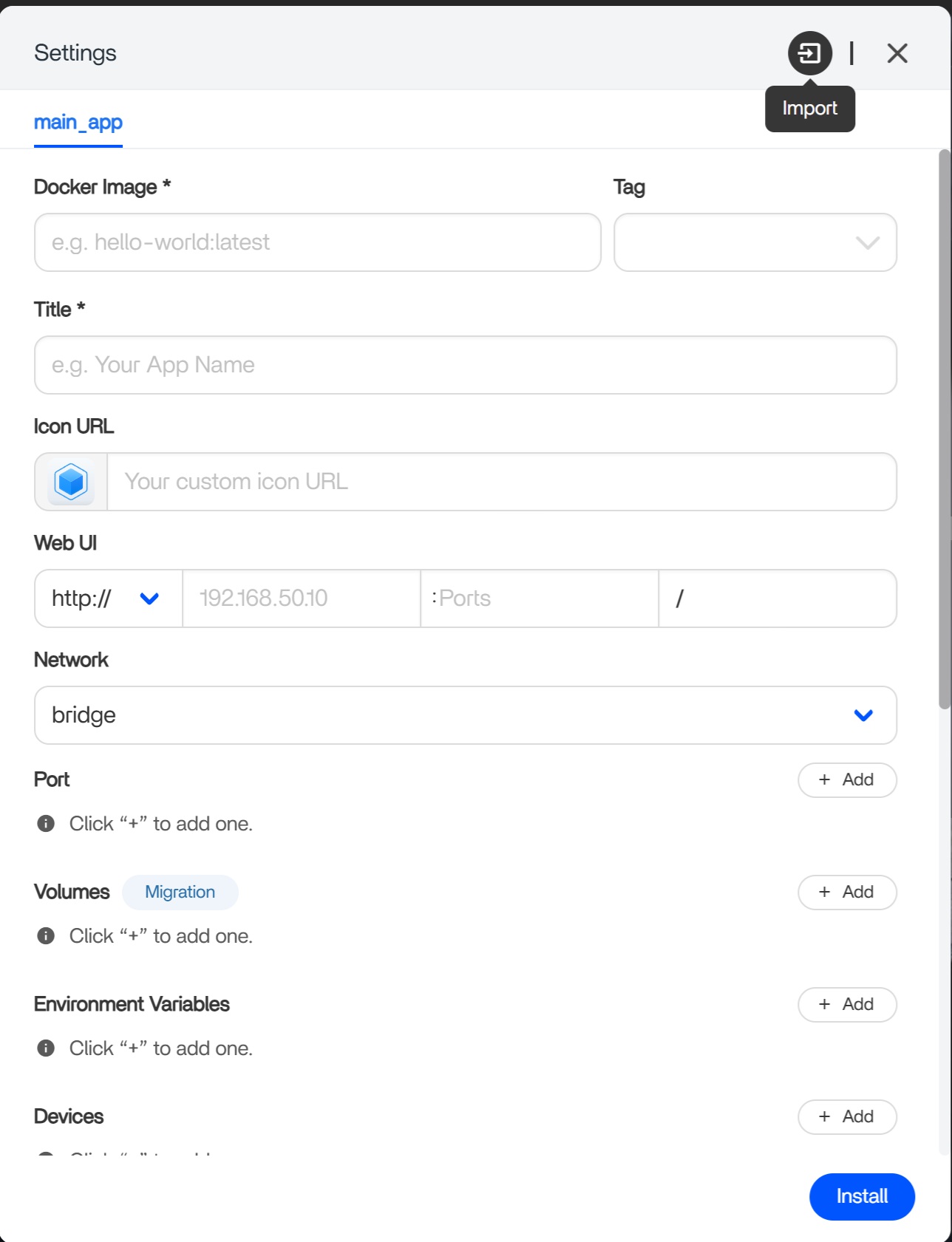

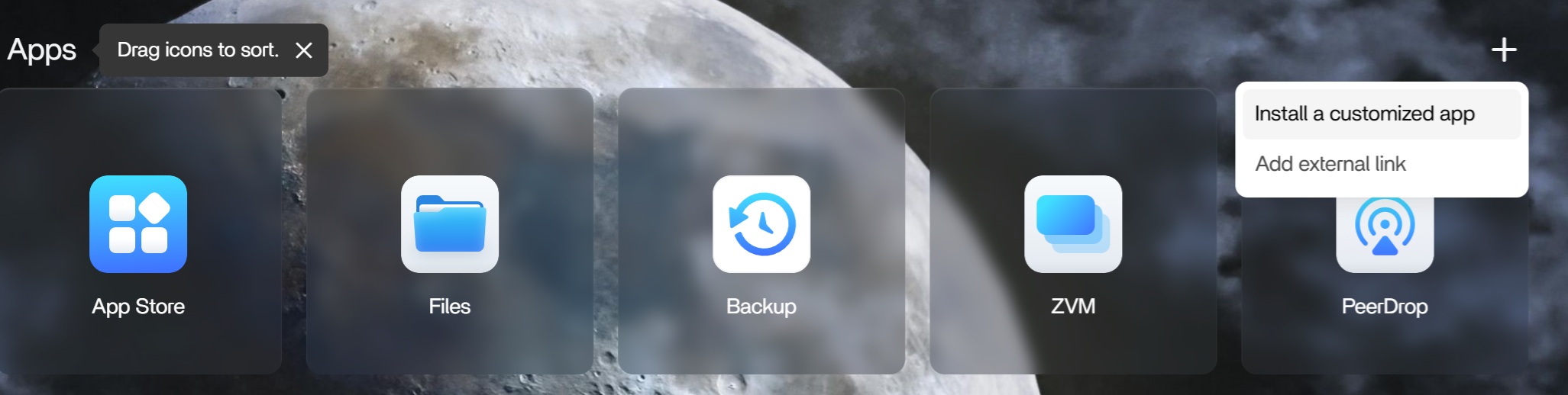

export the compse file from the app.
make your edits and import it again by installing as custom app.

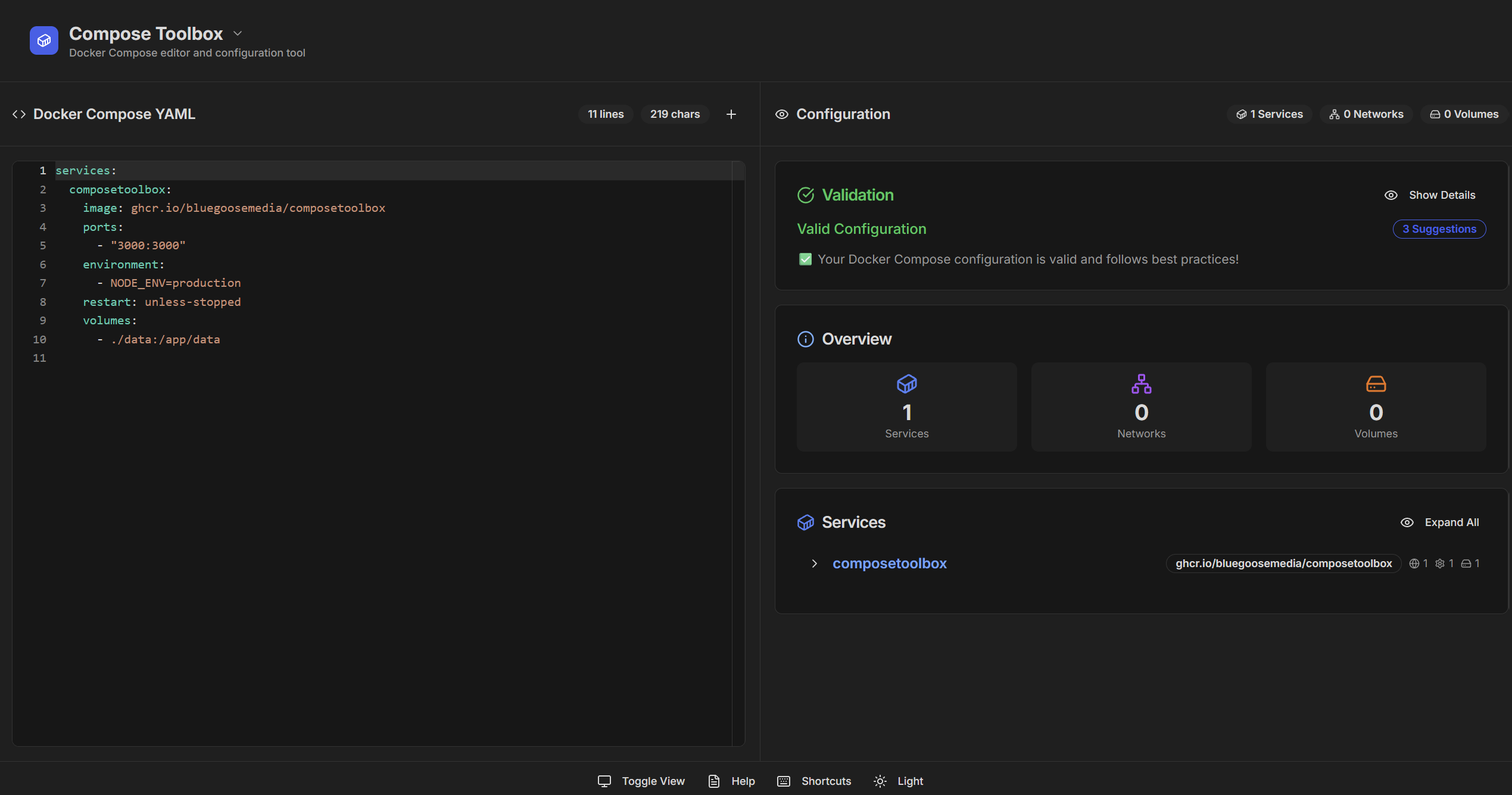

You can also install Compose Toolbox directly from the ZimaOS App Store.
Open Compose Toolbox, paste the exported Docker Compose YAML into the editor, and it will validate the configuration before you import it as a Custom App. The right-hand panel will show whether the Compose file is valid and highlight any formatting problems or suggestions.
This lets you check the YAML safely before changing the existing installation. Do not remove the current app until the exported Compose file has been validated and its existing model/configuration mounts have been confirmed.

So I only added 5 lines and it says 40 errors. I don’t get it because I didn’t touch any of the lines it says there are errors on.
I dropped an updated compose in here and kept on pressing submit but nothing happened :confused:
That usually means one of the five added lines has broken the YAML structure. A single indentation, missing colon, tab, or misplaced - can cause Compose Toolbox to report errors on many lines below it, even though those lines were not edited.
