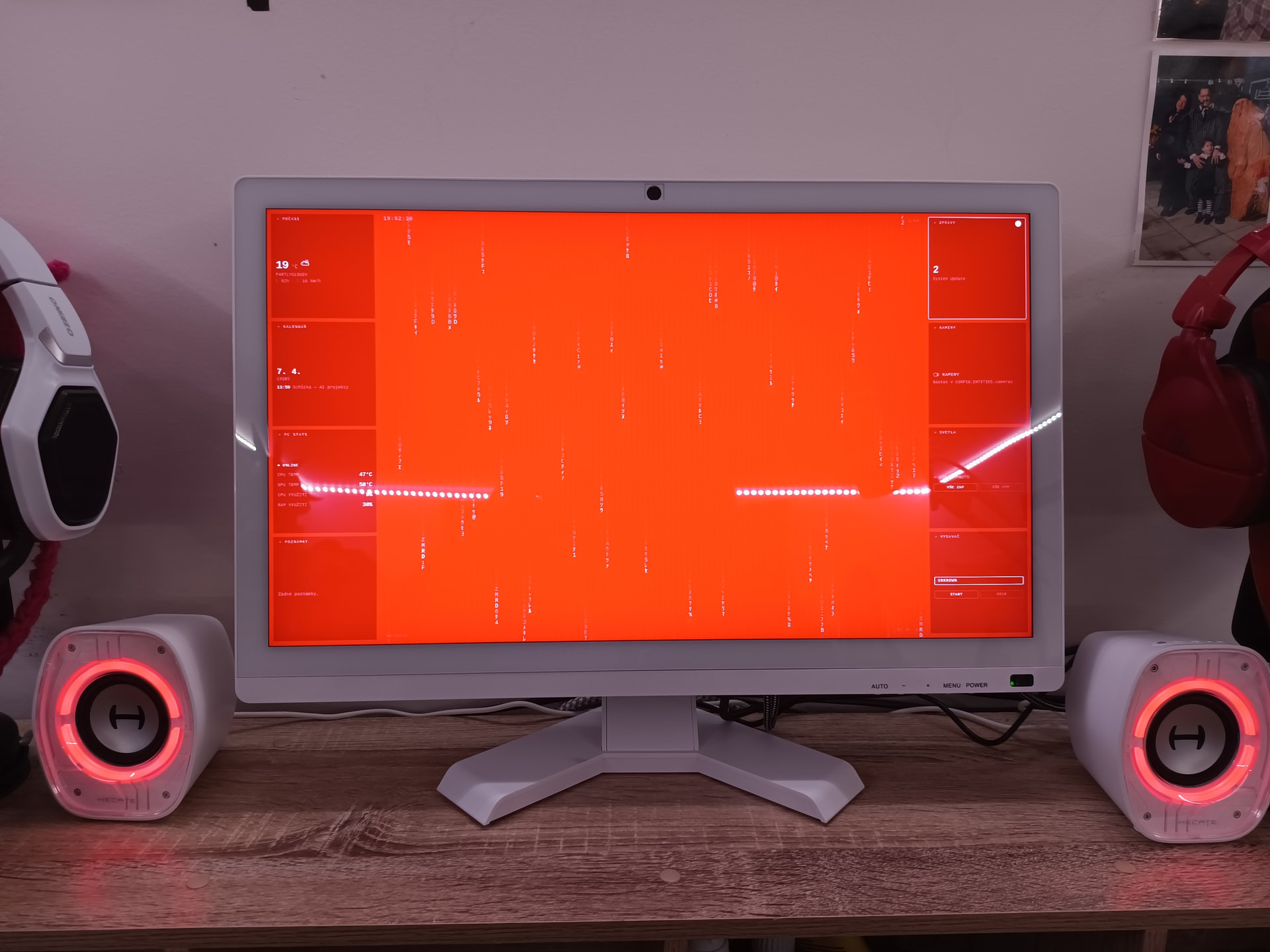

Hey everyone,
I wanted to share how I got a fullscreen touchscreen kiosk running on my ZimaBoard 2 connected to a 22" touch monitor via HDMI.

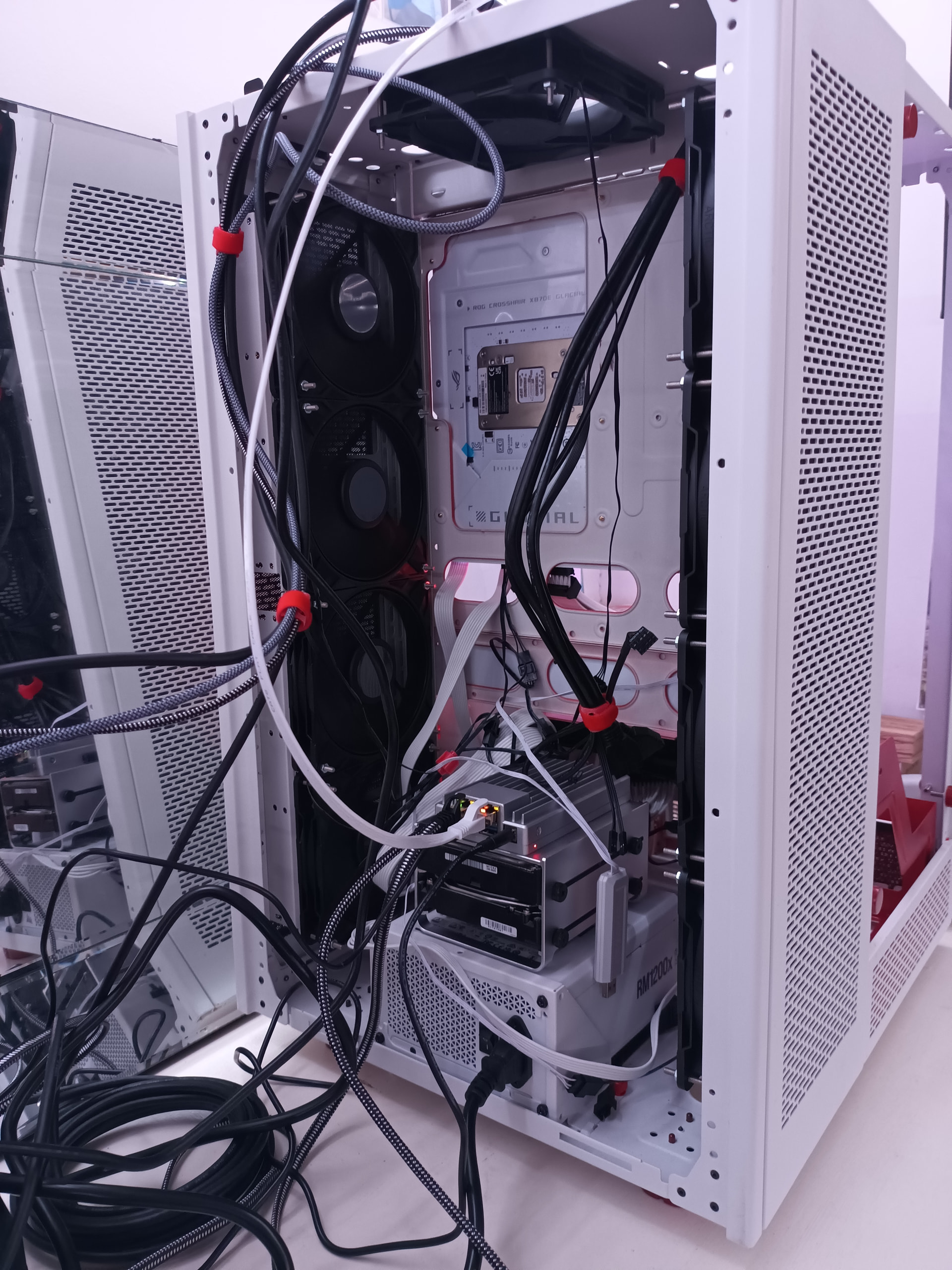

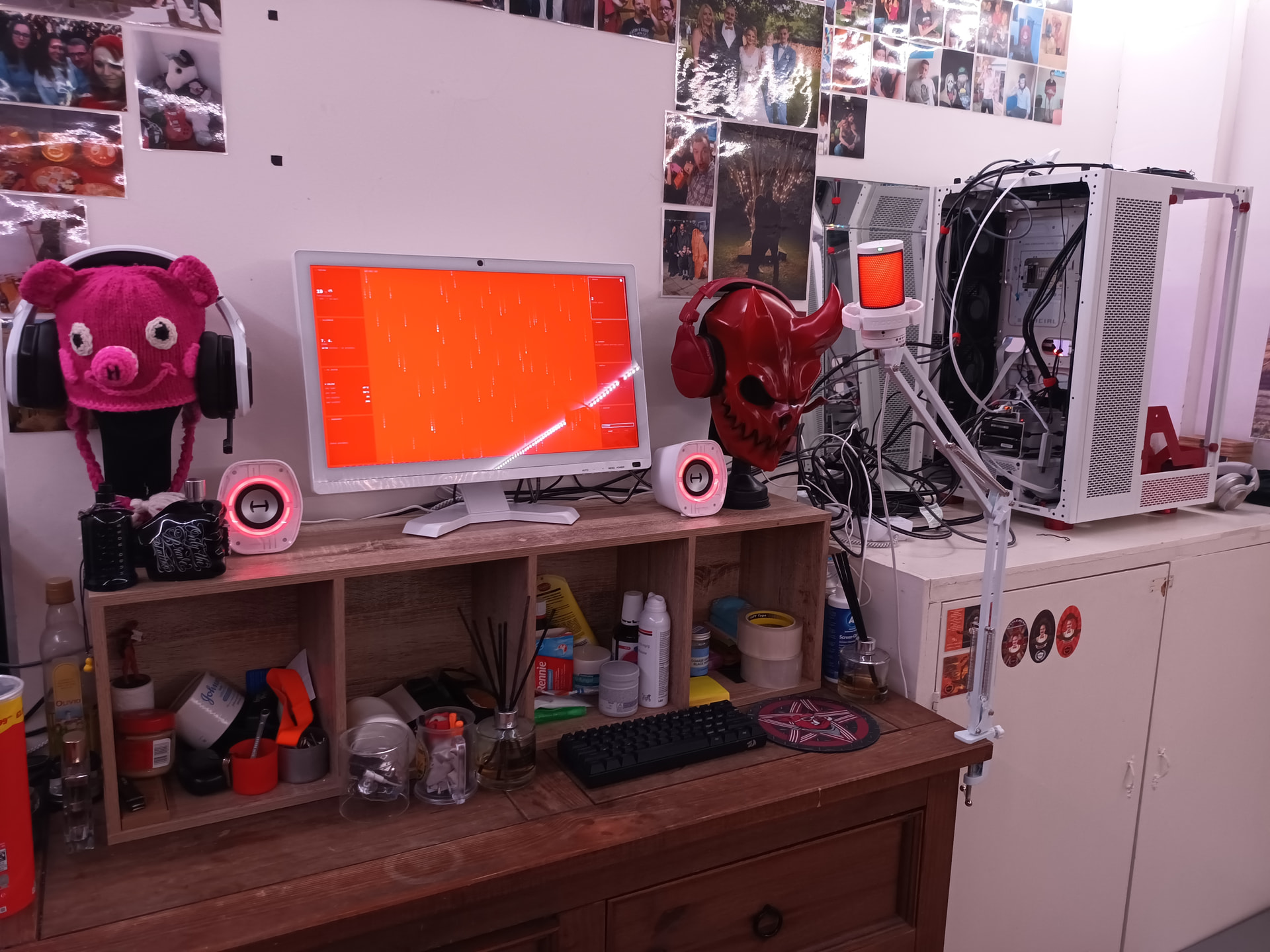

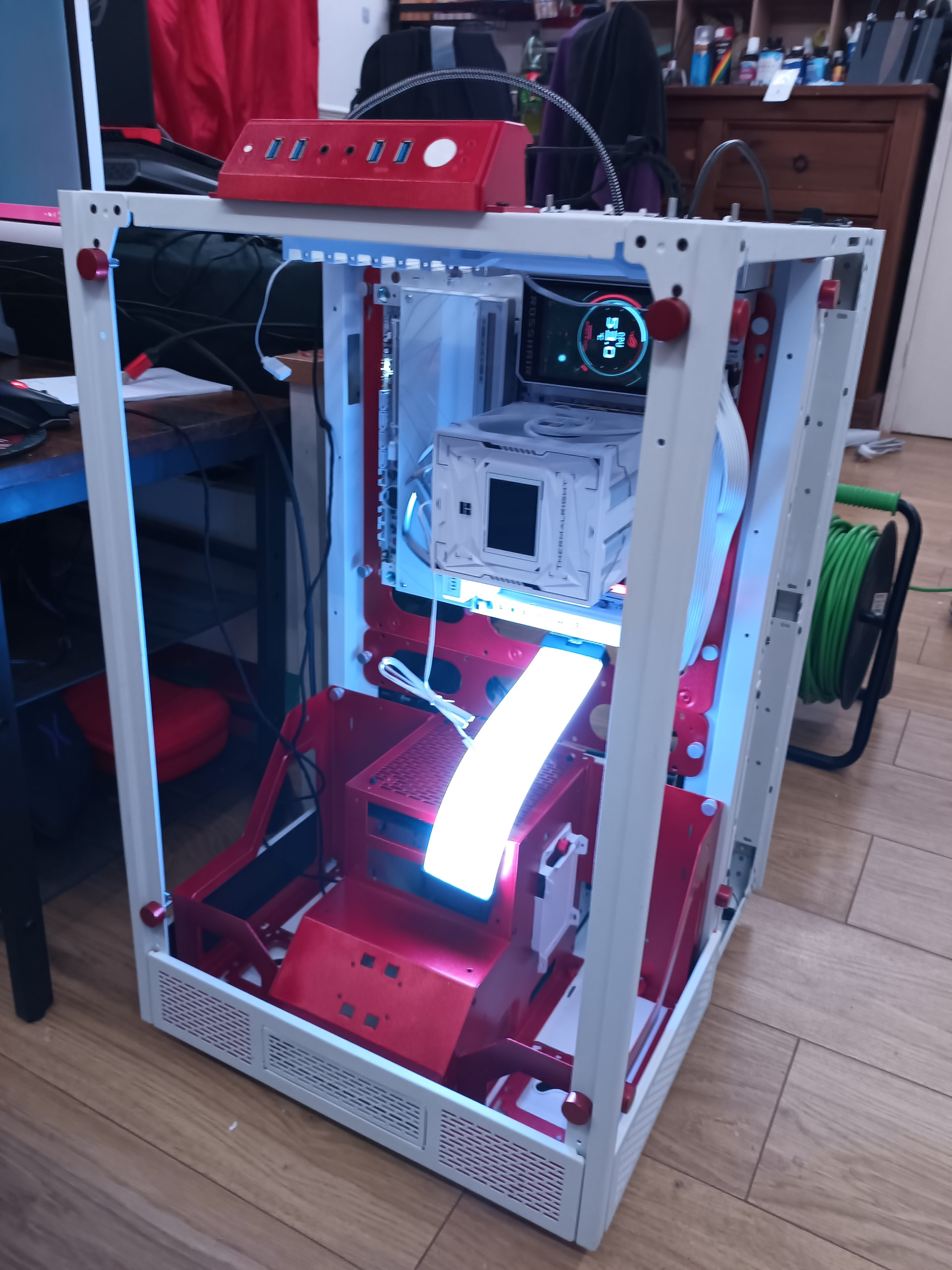

I built a power-efficient home assistant setup that’s available 24/7 without having my main rig burning electricity around the clock. The secret weapon is a Zima acting as the always-on brain, while my full PC sleeps in hibernation until it’s actually needed.
The Main PC
Here’s what’s inside the primary machine:
  • CPU: AMD Ryzen 9 9950X3D
  • Motherboard: ASUS ROG Crosshair X870E Glacial
  • RAM: Acer Predator Hermes RGB DDR5 96GB (2×48GB) 6000MHz CL28
  • Storage: Crucial T710 4TB NVMe M.2 PCIe 5.0 Gen5
  • GPU (Gaming): ASUS ROG Astral GeForce RTX 5080 16GB
  • GPU (AI): Intel Arc Pro B70 32GB (waiting on release)
  • PSU: Corsair RM1200x
  • Case: Thermaltake Tower 900
The Zima Setup (The Always-On Hub)
The Zima runs 24/7 and handles everything lightweight — home assistant duties, camera feeds, and basic AI queries using Groq free tier via the cloud.
Connected peripherals directly to the Zima:
  • Pisichen 22" Touch Screen monitor via HDMI → miniDP adapter + one USB-C cable for touch input
  • Edifier G1000 II speakers through an external USB-A to 3.5mm soundcard
  • DAMAO DGM20S microphone via USB-A
Storage:
  • Seagate IronWolf Pro 20TB — ‘‘black hole’’ NAS drive
  • Seagate IronWolf Pro 1TB — main NAS drive
Networking:
  • Zima connected to the router via Ethernet
  • Second Ethernet cable runs directly from the Zima to the PC for fast local transfers
The Smart Part: Wake-on-LAN
Here’s the magic — when someone asks a question that’s too complex for Gemini to handle well, the Zima sends a Wake-on-LAN packet to bring the main PC out of hibernation. Once it’s up, it connects to a local 70B parameter LLM running on the Intel Arc Pro B70. After the task is done, the PC goes back to sleep.
The result: a home assistant that’s always responsive, but the big rig only wakes up when there’s actual heavy lifting to do. Power bills stay sane, and I still get access to a seriously capable local model when I need it.
***Huge shoutout to Claude Code and Perplexity — honestly, without their help I would have never been able to put this whole project together on my own. They were invaluable throughout the entire process.
I hope this information helps anyone crazy enough to take on a similar project — feel free to share it wherever you like!***
