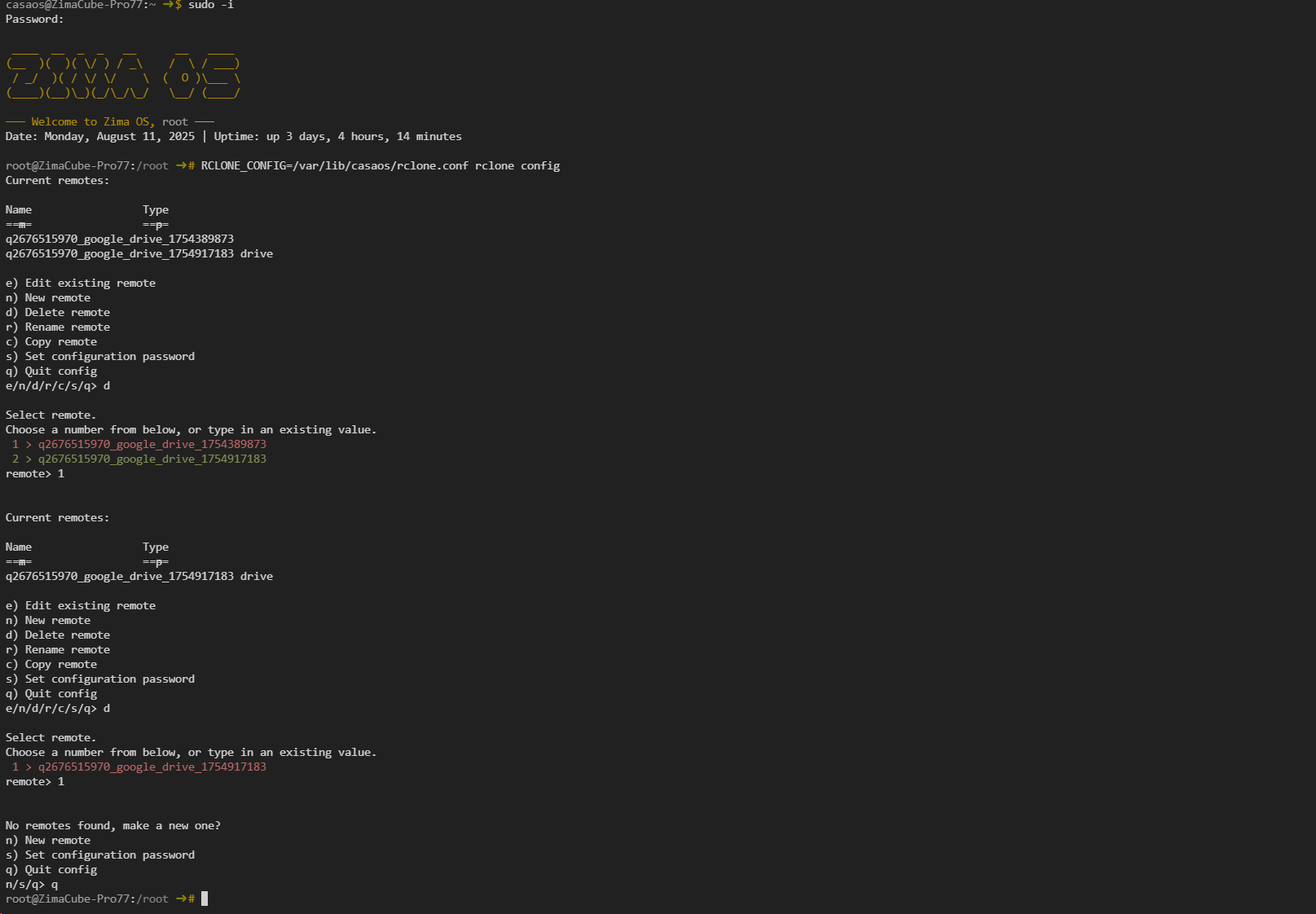

got it working doing this
Thank you for your feedback, about the mounting of Google Drive, our team is optimizing, the mounting problem you mentioned, for the time being, I can solve it with the following steps
Run RCLONE_CONFIG=/var/lib/casaos/rclone.conf rclone config on the command line
You will see the old mounting, what you need to do is press the d key, first remove those old network disk configurations, and then press Q to exit
Go back to the Files page of ZimaOS and remount
Follow the operations shown in this image
sudo -i
and enter your password
Error example: because the user is not root
