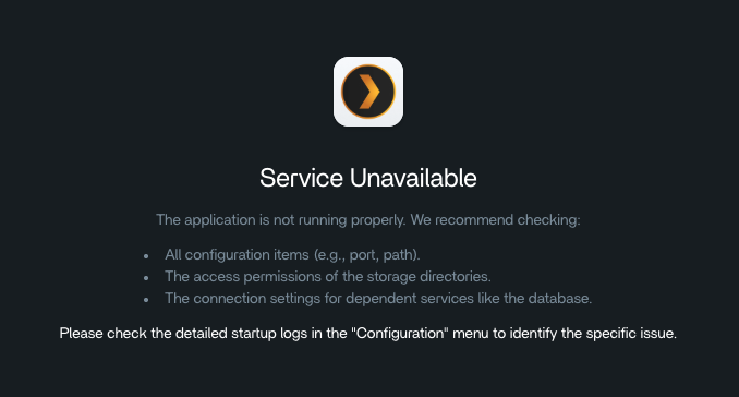

External Drive Mount Fail & Hence Plex Container Fails to Start After Update to ZimaOS+ v1.5.4-beta1
OS Version:
Service Affected:
Plex (Docker container)
Issue Summary:
After updating to v1.5.4-beta1, Plex no longer starts. Restarting the container fails consistently with an OCI runtime mount error.
Error Message:
Error response from daemon: Cannot restart container 57044a6410460621f48a288045d5e0533e1cba5b3fa8a7facc35dd118ce3cdbf:
failed to create task for container: failed to create shim task:
OCI runtime create failed: runc create failed:
unable to start container process:
error during container init:
failed to fulfil mount request:
open /media/NVFLIX/PLEX: input/output error
What Changed:
Plex was working normally before upgrading to v1.5.4-beta1.
Issue appeared immediately after the update.
Mount Details:
  • Plex media directory mounted from:
    /media/NVFLIX/PLEX
  • Mount path unchanged from previous working version.
Steps Taken:
  • Restarted Plex container
  • Restarted Docker service
  • Rebooted system
    → Issue persists
Observations:
  • Error suggests a mount or filesystem access issue
  • Path exists, but Docker reports an I/O error during container init
  • Other containers may still access storage normally (if applicable)
Expected Behaviour:
Plex container should start normally with existing media mounts after OS update.
Actual Behaviour:
Container fails to start due to mount failure.
Request:
Guidance on whether:
Infact Zima OS is not automounting the external Drive - Oops! Something went wrong…
readdirent /media/NVFLIX: input/output error
/NVFLIX/303 GB Available/1.02 TB
This isn’t a Plex or Docker issue.
After the 1.5.4-beta1 update, the external drive is not auto-mounting.
/media/NVFLIX is returning input/output errors, so Docker correctly refuses to start the container when the bind mount is unreadable.
Key points:
  • Host mount is broken > container cannot start
  • Path did not change, permissions are not the issue
  • Likely a beta automount regression or the filesystem not mounting cleanly after the update
To confirm the root cause on the ZimaOS host, please run the following commands and share the output:
lsblk -f
mount | grep NVFLIX
dmesg -T | tail -100
Once the disk is mounted cleanly and readable at the OS level, Plex should start immediately with no container or path changes needed.
