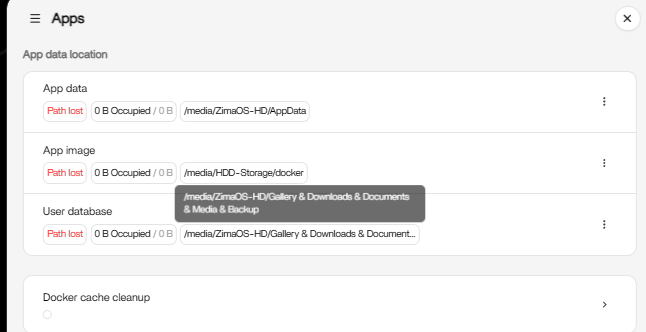

After reboot/startup, ZimaOS sometimes behaves almost like a fresh installation.
Observed symptoms include:
  • HDD appears as “Path lost”
  • /media/HDD-Storage is missing
  • Docker fails to start
  • Nextcloud and other applications become unavailable
  • Existing applications/data appear to be missing from the UI
  • ZimaOS may show setup/login behavior that looks like a fresh system
  • /DATA, /media, /opt and /var/lib/casaos are not mounted correctly
  • /media and /opt remain on the read-only SquashFS root filesystem

Because of this, the HDD cannot be mounted and ZimaOS shows “Path lost”.

The 4 TB HDD immediately mounted correctly again:
/media/HDD-Storage
/dev/sda
btrfs
rw
All old files were visible again.

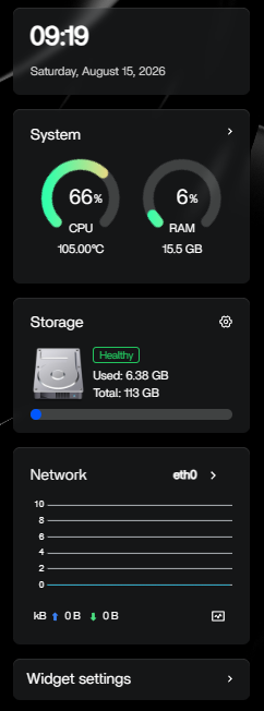

Additional v1.7.0 observations
After upgrading to v1.7.0 I also experienced abnormal CPU/RAM behavior.
At one point the system became extremely slow/unresponsive and restarted or became unavailable.
After recovery, icewhale-files was one of the highest CPU consumers:
/usr/bin/icewhale-files
~21% CPU
~300 MB RSS

and CPU got really high normally isnt like this
