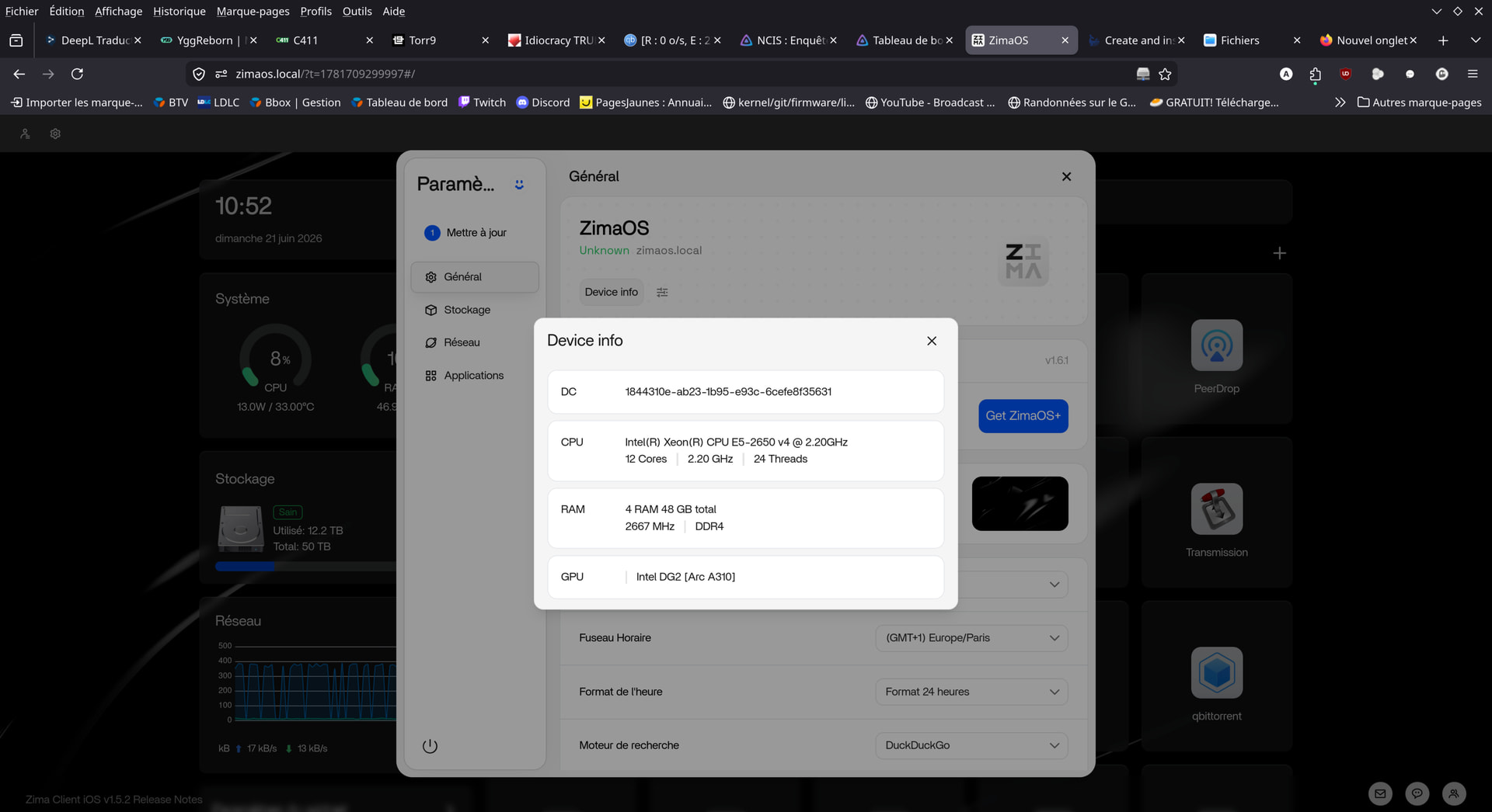

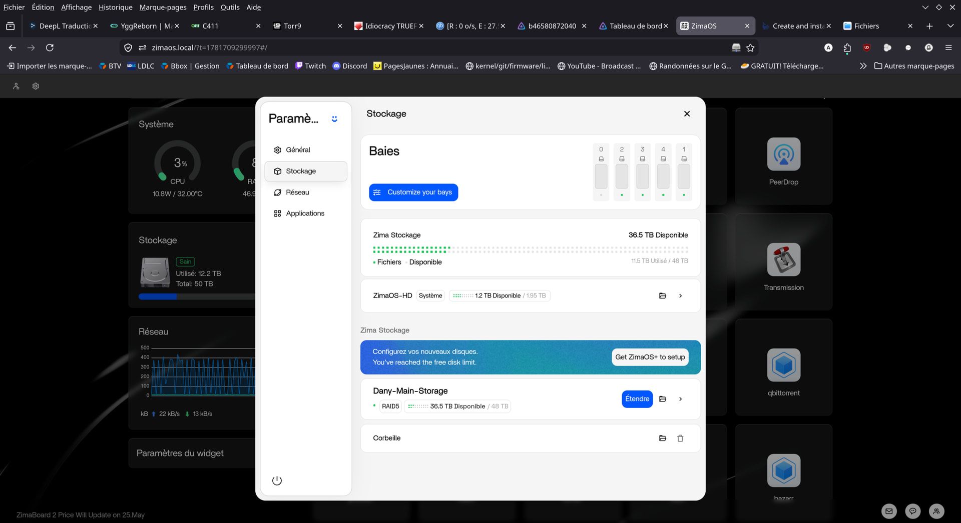

Xeon E5 (12 cores/24 threads), 48 GB RAM, and over 30 TB of HDD storage.

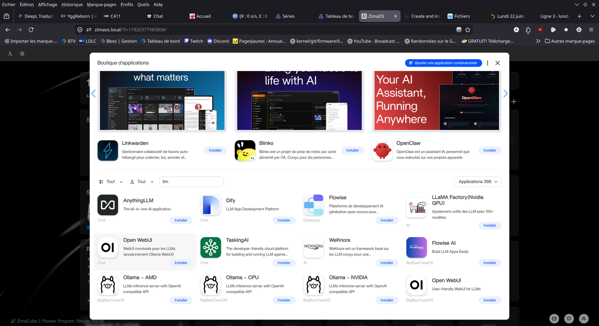

I see that Ollama and Open WebUI are available, indeed.

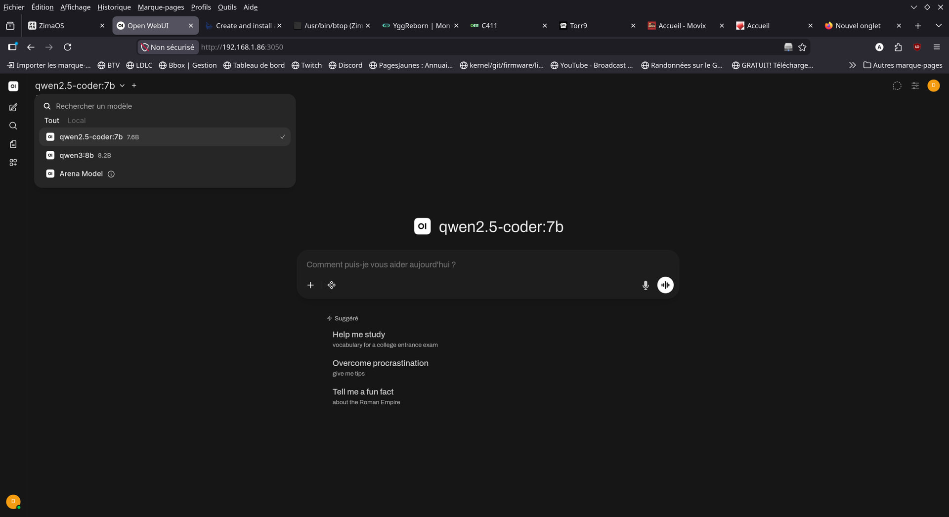

I installed Open Web UI and Ollama CPU.
I added two engines:
  • qwen2.5-coder
  • qwen3
Did I make a mistake?
