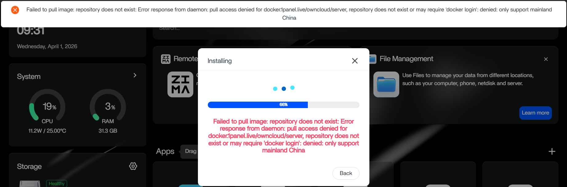

I’v been trying to make install a cloud sync app, for 3 users at home, for the past 2 weeks and so far I haven’t been able:
  1. OpenCloud: it just wont install by following Gemini’s suggestions and from the github page it’s just gibberish to me
  2. Nextcloud: I’m stuck at choosing the type of database: SQLite is not recommended in the long run fom what I read and setting up MariaDB/MySQL is more gibberish to me
  3. I’ve tryed with OwnCloud from the ZimaOS app store it wont even install.
I’m really let down so far. Is there anything that would just work for file sync on this OS? I think I’m only left with Syncthing but I don’t like the fact that there isn’t a central server.
you don’t say what the issue is with opencloud installing. For Nextcloud, try the install guide here Streamline Nextcloud Installation on CasaOS with BigBearCasaOS
Owncloud is a bigbear version and you should chose to do a custom install, so you can set some of the settings change mount point, set ip address, and a few other things like passwords and so forth.

About owncloud it just wont complete the installation from the app store.
Thanks for the link btw.

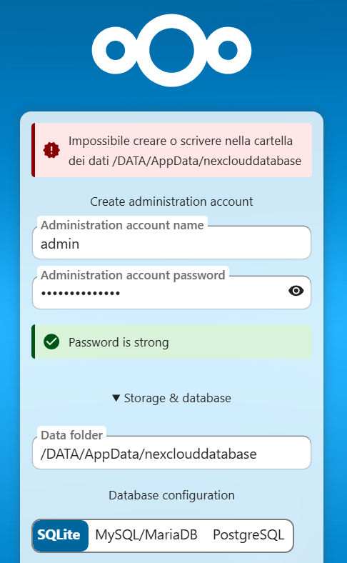

I’m on a fresh installation of Nextcloud and first of all I’m trying to follow your tip about moving my nextcloud data out of the container. How do I do that?
On the first welcome page I was given che choice where to store the databade, right under the user and password creation. Well it did not allow me to do that even if I already created a dedicated folder for it.
So before going further I found some really complicated guide on the nextcloud forum to set this after the initial setup with the risk of breaking stuff. Instead of the masochistic way how can I choose this location right from the welcome page? This would be the perfect time for me since I want all the data (file sync) in nexcloud to be stored in my raid and not the boot ssd.
For this I created the /DATA/AppData/nexclouddatabase folder where “DATA” is my raid now.
Some fields are still showing in Italian, my language, I don’t know why since the OS is in english, sorry about that. As you see in field “Storage & Database” I could be pointing to somewhere else but it wont allow me.
Yeah you’ve actually done everything right, you’ve just hit the one part that isn’t obvious at all with Docker/ZimaOS.
That error you’re seeing simply means Nextcloud can’t write to that folder. Not because the folder is wrong, but because the container doesn’t have access to /DATA/... directly.
That field on the welcome page looks like it should let you choose your storage location, but it only works inside the container, not on your actual disks. So when you point it to /DATA/AppData/nextclouddatabase, it fails because Docker hasn’t been told about that path.
So the fix isn’t on that screen.
What you want to do is set this at the container level first, then let Nextcloud use its default path.
Go into:
ZimaOS > Apps > Nextcloud > Settings > Volumes
You’ll see something like:
/var/www/html/data
That’s the real Nextcloud data directory inside the container.
Map that to your RAID, for example:
/DATA/.media/your-raid/nextcloud/data
or
/DATA/AppData/nextcloud/data
Once that mapping is in place, restart the container.
Now go back to the welcome screen and just leave the data folder as default (/var/www/html/data) and continue with SQLite.
Behind the scenes:
  • Nextcloud writes to /var/www/html/data
  • Docker redirects it to your RAID
  • no permission issues, no errors
That’s why it wouldn’t let you set it directly before, it’s not the right place to do it.
You’re actually doing this the right way by stopping now. Most people only realise this after they’ve already filled it with data on the wrong disk
