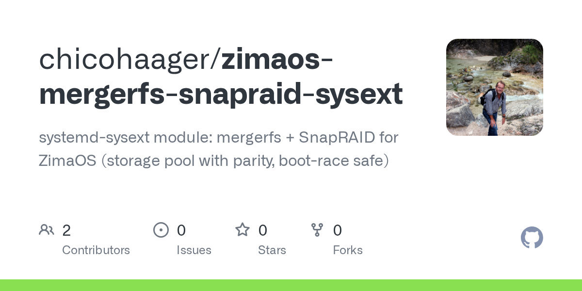

As already discussed with you - here we go :wink:
This is outstanding mate.
For anyone following this thread, Holger has not just talked about the problem, he has actually built a proper ZimaOS solution for it.
What makes this impressive is that ZimaOS is not a normal Linux distribution where you can simply install packages and modify the base system freely. It is a read-only, appliance-style OS, so adding something like SnapRAID safely is not simple.
Holger’s approach using a systemd-sysext module is exactly the kind of clean layered method that makes sense for ZimaOS. It adds the missing functionality without fighting the base OS or turning the system into a hacked-up install.
From what I can see, this is a very serious piece of work:
mergerfs + SnapRAID for ZimaOSstorage pool with parityboot-race safesystemd-sysext baseddesigned around the way ZimaOS actually works
Honestly mate, I take my hat off to you.
This is the kind of work that opens doors for ZimaOS users and shows that advanced storage features can be added in a clean, controlled and update-friendly way.
Superstar effort, Holger. Very impressive.

I did a controlled test on my ZimaCube Pro and can confirm Holger’s sysext layer works on my system.
Test environment:
ZimaCube Pro
ZimaOS
amd64
systemd-sysext available
Docker buildx available
What I tested:
  1. Cloned the repo.
  2. Built SnapRAID locally using the provided Docker build script.
  3. Built the sysext image locally.
  4. Installed the sysext.
  5. Confirmed systemd-sysext loaded mergerfs-snapraid.
  6. Confirmed the binaries are available:
mergerfs v2.42.0
SnapRAID CLI v14.5
I then did a safe manual mergerfs test using only a disposable test disk/folder. I created two test branches and one pool folder, mounted them manually with mergerfs, created a file through the pool, and confirmed the real file appeared on the underlying branch. I then unmounted the test pool cleanly.
So far, this confirms the sysext installs correctly and mergerfs works on ZimaOS.
Important note: I did not run a full SnapRAID parity/recovery test yet. For that, I would want a proper test layout with separate data and parity disks, ideally ext4 or xfs, and not any live production data.
Also worth noting: after install, the default timers/services were enabled, so I disabled them before configuring anything. Anyone testing this should check the default config first and make sure it does not point to real disks before starting services or timers.
Very impressive work from Holger. This looks like a proper ZimaOS-friendly layered approach rather than fighting the OS.
