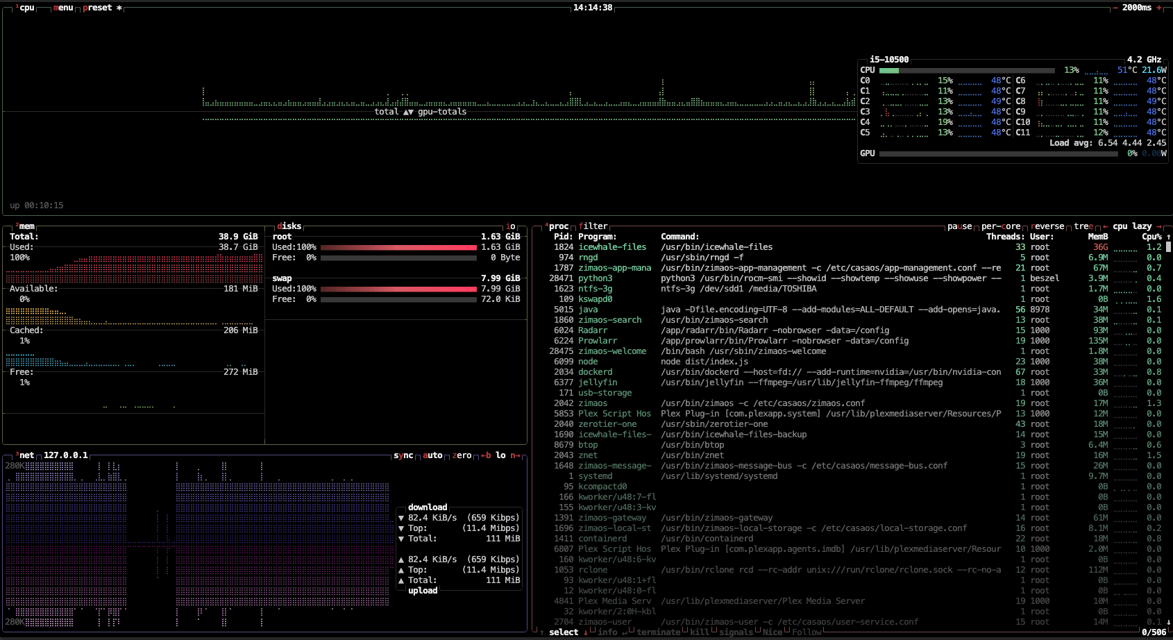

When copying a large amount of data from a USB HDD to the internal HDDs configured in RAID, the system gradually consumes all available RAM. It also fills the swap completely, and eventually the entire system becomes unresponsive and crashes.
In my case:
  • The system has 40 GB of RAM
  • RAM usage reaches almost 100%
  • Swap usage also reaches 100%
  • The issue occurs during a copy from an NTFS USB HDD to the RAID storage
  • The web interface and services stop responding
  • A forced reboot is required
The attached screenshot shows the situation shortly before the crash, with only around 181 MB of available RAM and the swap completely full.
This looks like a memory leak or an issue with filesystem caching that is not being released correctly during large file transfers. Normal Linux caching should not make the entire system unusable, especially once memory pressure increases.
Has anyone else experienced this issue on Beta 2? Please let me know which logs or diagnostic information would be useful to help investigate it.

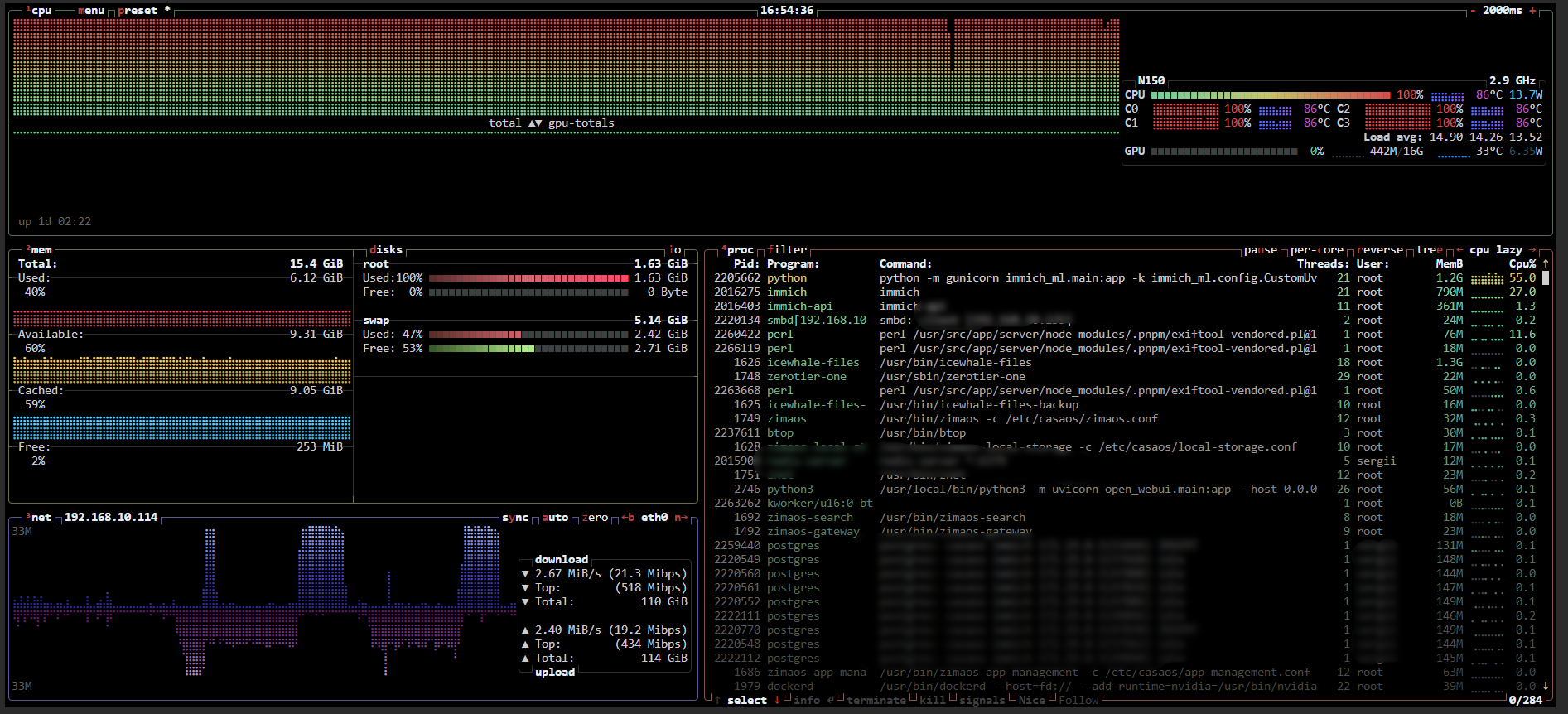

Install ZimaBrain; it might give you some clues as to where to look for the problem. You clearly have some bugs. Or try a clean install of version 1.7.0 b1, then update to beta 2. I’m experiencing higher CPU and RAM usage and temperature, SWAP fluctuates between 50-100%, but no freezes.
