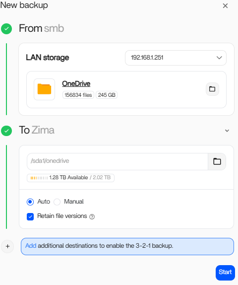

In the Backup app, you can chose to backup a Cloud Service a Lan or USB. 2 Problems really. 1) Does’t matter what you chose (I’ve looked at all 3 options) you can’t share either the root or more than 1 folder.
I would have to create a separate backup task for each and every folder I want to backup. That would be very time consuming for both me to setup and for ZimaOS to do. Heck, in my example I have files in the root of my onedrive. Impossible to select those.
2) If you select nothing and just click confirm, the backup app changes behind the scene to as if you had selected something. You hit cancel and go back so say change to something else and those options are gone. You can only chose a destination.
Worse it lets you chose destination sortof. Note it lets me chose a folder on sda1, but not click confirm.

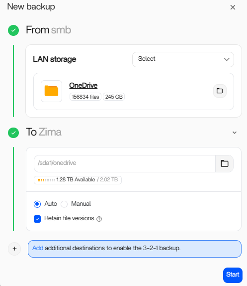

OK, this is weird. I clicked start, and the screen just sits there. If I click the x it says it won’t be saved. To me it looks like nothing is going on
But so far it has copied almost 60gb of it. But what is weird also is I selected the Onedrive folder as source. and the one drive folder on sda1, and it put a new onedrive folder inside the onedrive folder on sda1. Not ideal but doable.
Hopefully by time it gets done copying the 245gb it will have saved the backup job. I ended up opening another tab and going to zimaos and looked in backups and it does show there now so that is a good sign.

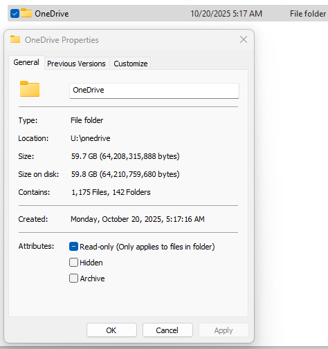

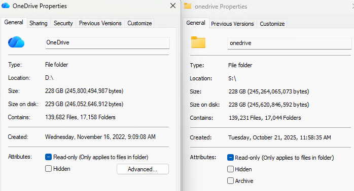

File count from the backup info on Zima OS says 139,229 files
Just now I did a properties in windows on both the Onedrive folder it is backing up, and the destination where they are being copied to. Obviously it’s not backing up something in one drive. 114 folders and 450 or so files. And yes the last time Zima checked was yesterday, but I can tell you that this not because of that. I’m 95% sure I didn’t do 1 thing with a new file on onedrive in the last 24 hours. Nor did I add 450 files. But actually I noticed this the day it said it finished.

It’s not really a backup problem, it’s just a difference in how ZimaOS and Windows count files.
ZimaOS backup skips hidden, temporary, or system items (like OneDrive cache and .dat files), while Windows Properties counts everything. That’s why you see a few hundred extra files or folders in the OneDrive view, even though the total size is almost identical.
It’s the same kind of reporting mismatch as the storage usage display, nothing’s missing, just counted differently.
