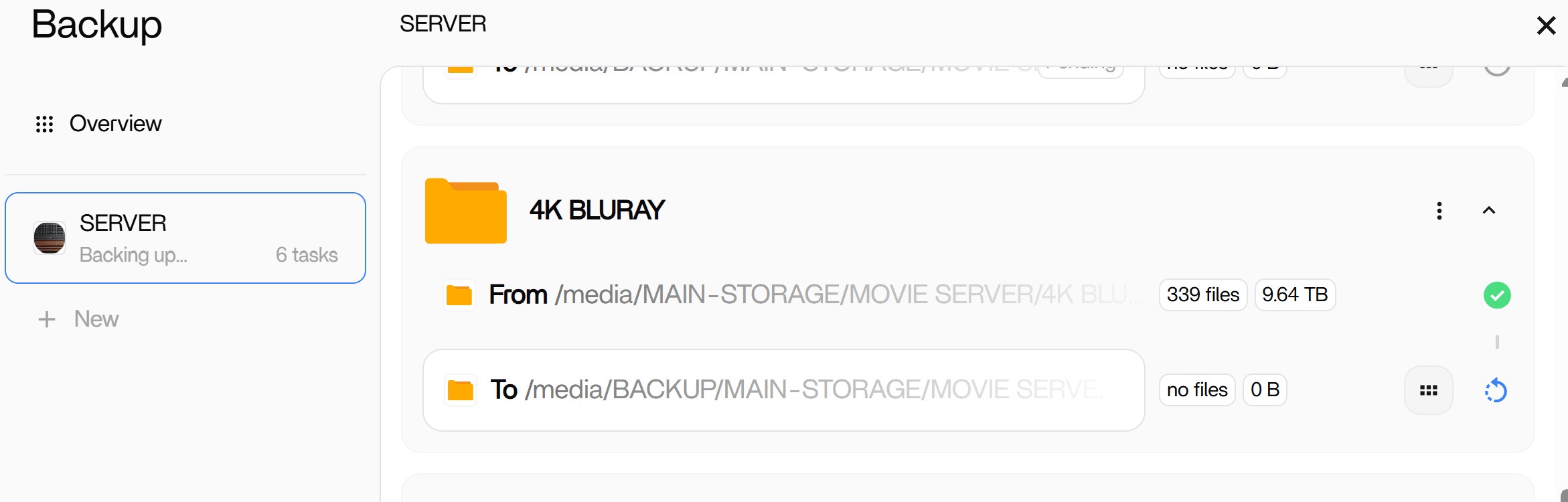

After updating to 1.70 my backup job with the internal app is not working anymore. I start the backup routine manually. The source data are on the ZimaOS NAS (media data, big files), the target is an TrueNAS Backup server. In the folder are several hundred files. After the backup routine did not work (after starting the was no traffic of any kind between the servers), i deleted the backup routine and created a new one from scratch. Same result - nothing is happening. Any advice appreciated. In 1.62 everything worked like a charm.

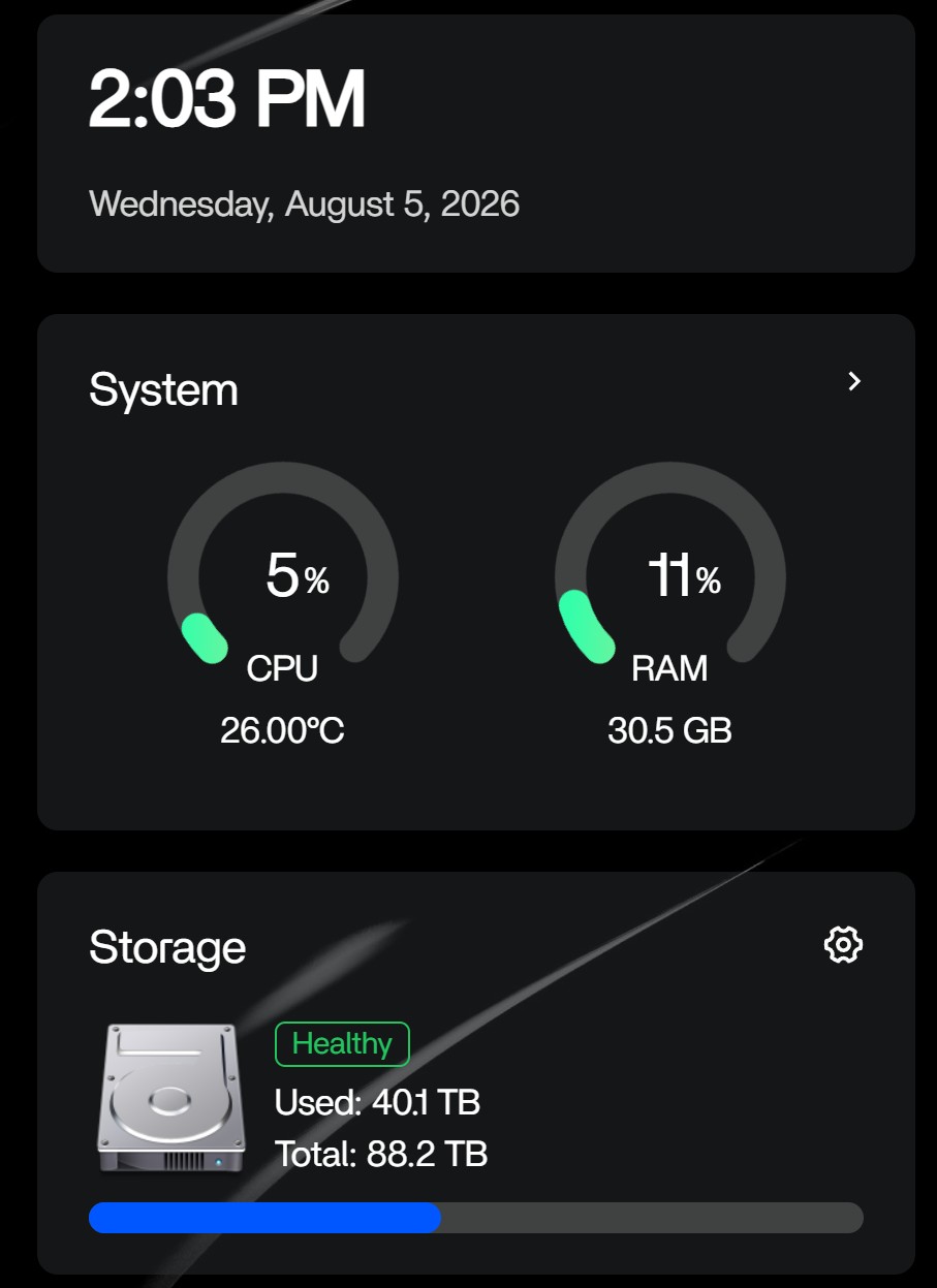

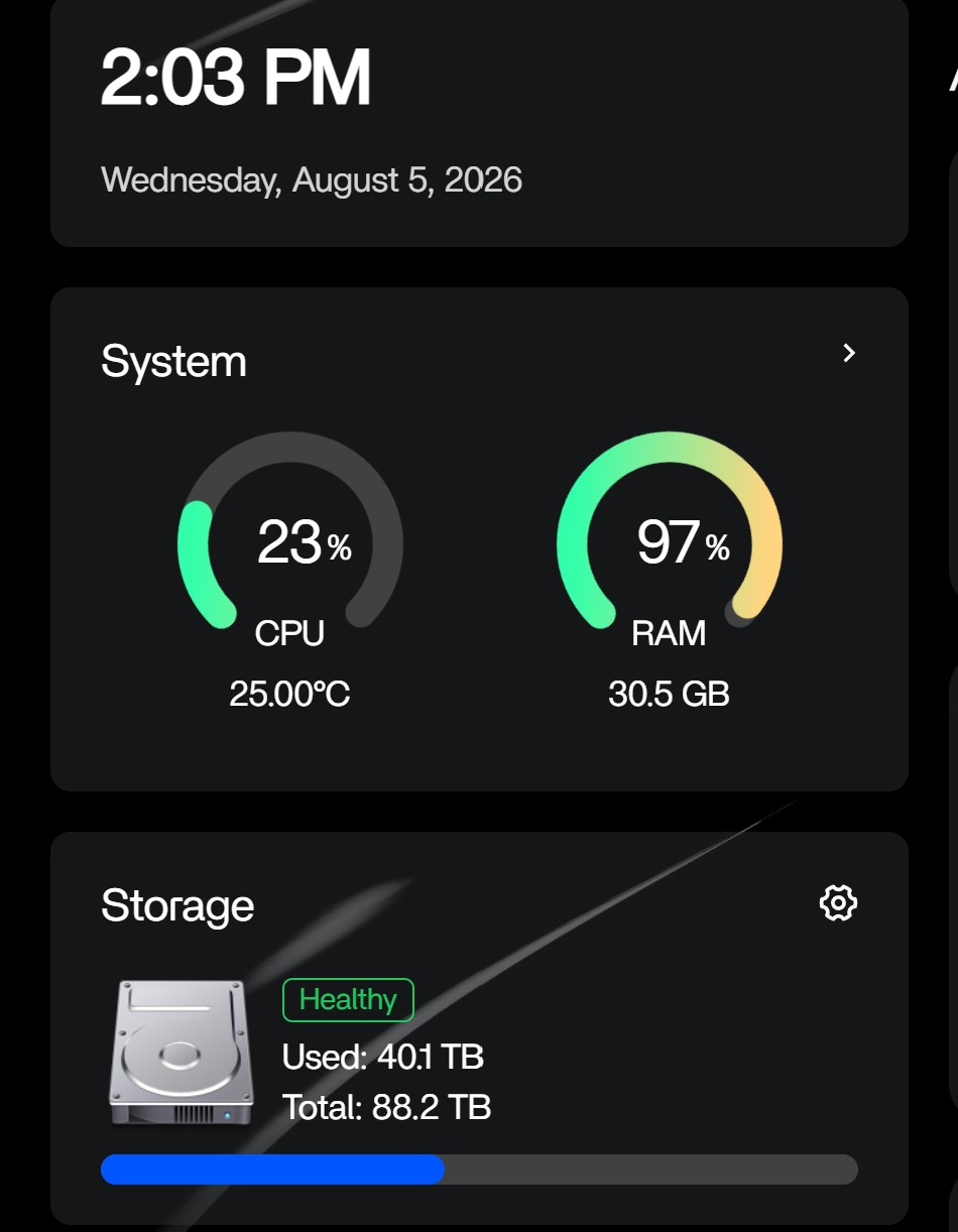

The icewhale-files-backup process grows to 40+ GiB RSS within a few minutes, pushing the system close to OOM (RAM usage climbing from a ~11% baseline to 92%). The growth repeats after restarting the process.

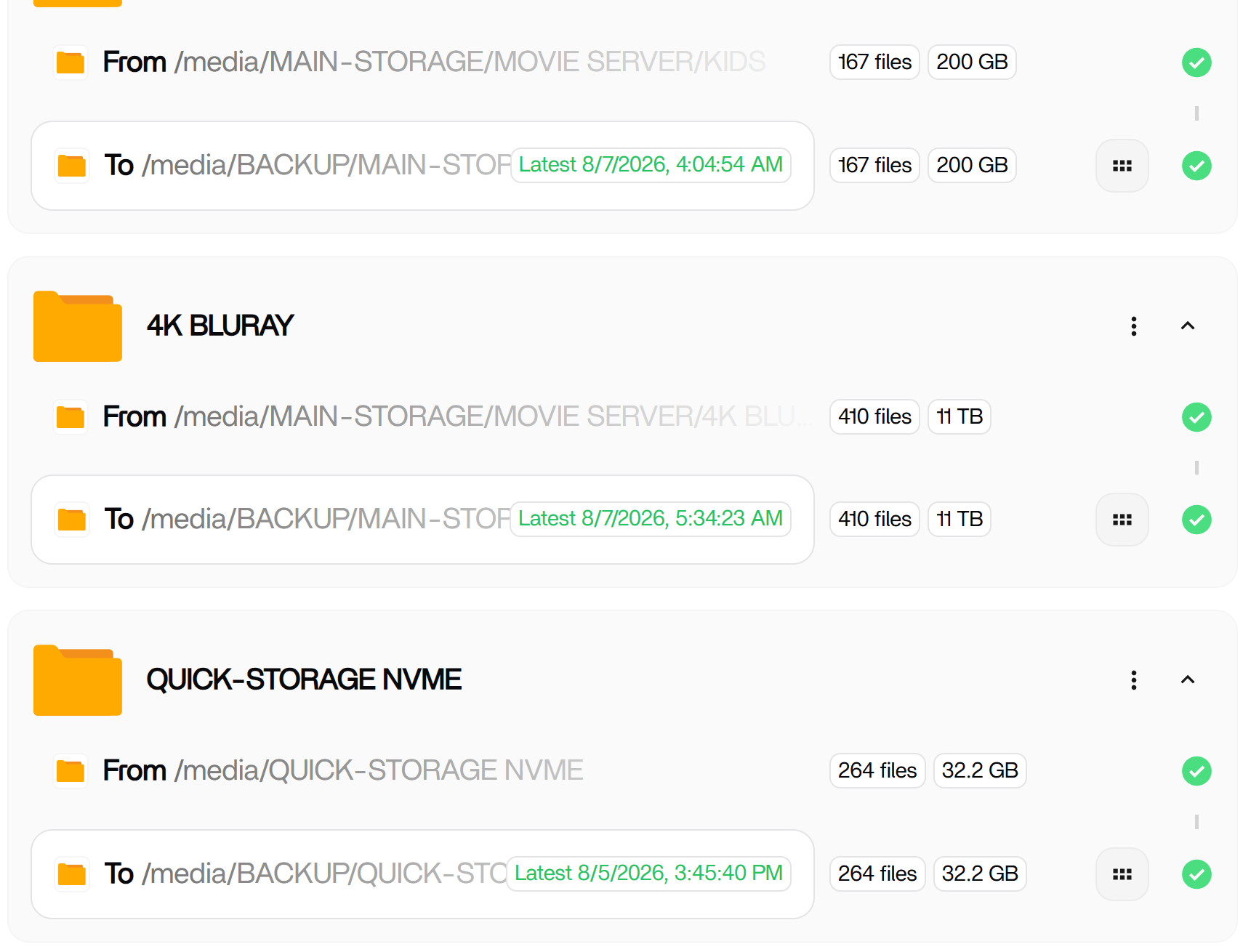

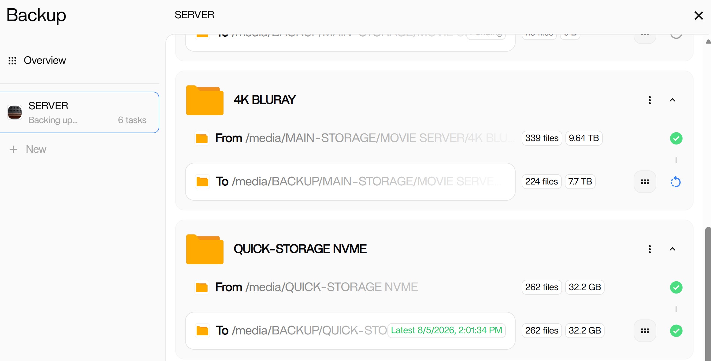

I can confirm that the 1.7.1 alpha 1 is solving the backup issue. I launched a bunch of big backup tasks and the process icewhale-files-backup only use 118M of RAM.
Backup works on 1.7.1 alpha 1. Backed up 11 TB of 4K Movies. Thank You !!!

Also I would like to say, that the back up is buggy. It kinda works. My ram is also maxing out, but a few smaller folders could be easily backed up.
So at least 2/3 attempts, and the third still running, I can imagine, that it’s a bug in the UI or the conversion from the backend to the front end. The ram maxing is weird, to before. Even though, it also uses some CPU. So I wouldn’t really think, that it’s not working. And the CPU isn’t maxing out.

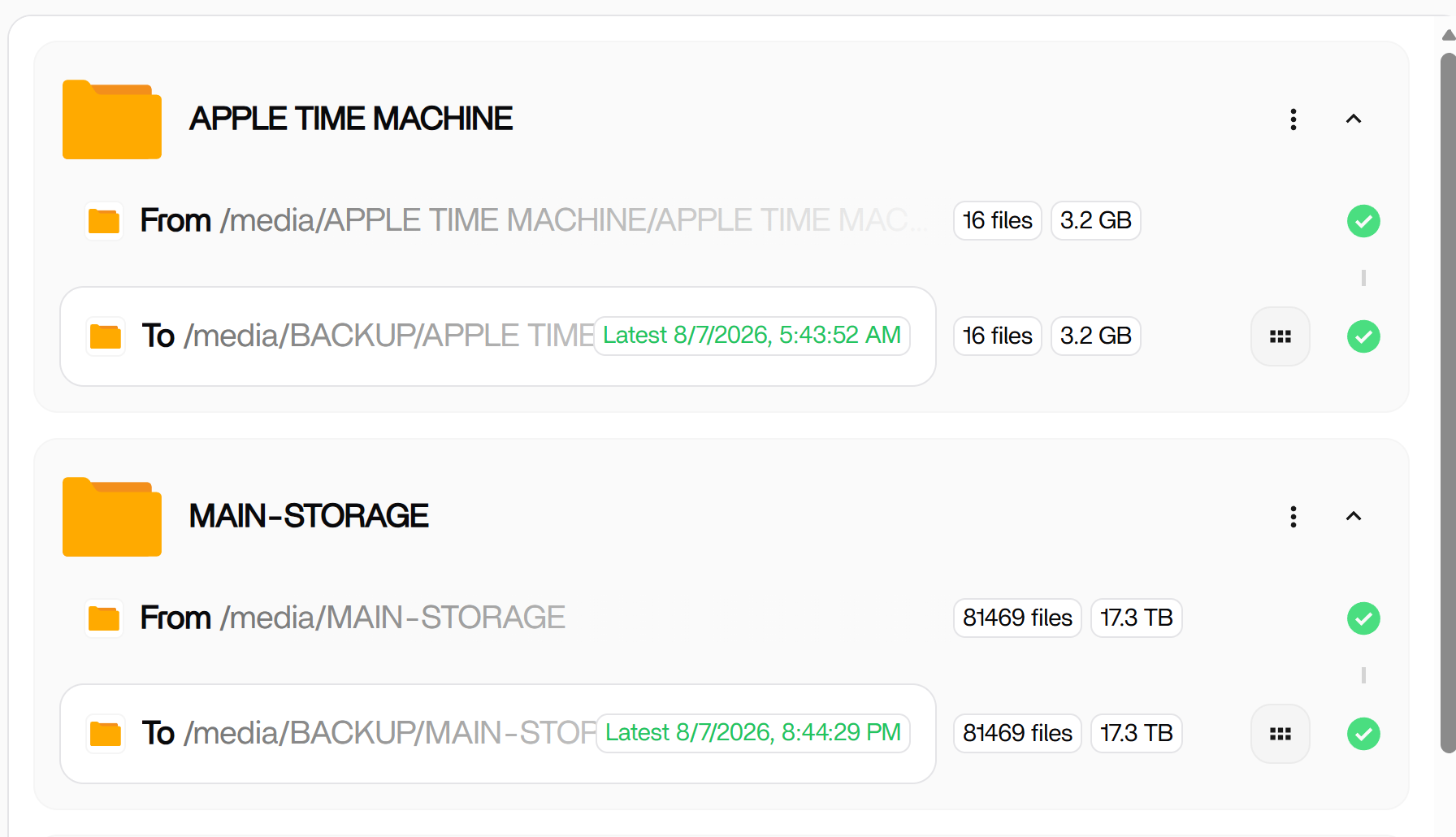

Managed to do 11 tb media backup. then made whole drive to back up and it finished with 17tb of data.
At least im safe now with all the data backed up.
