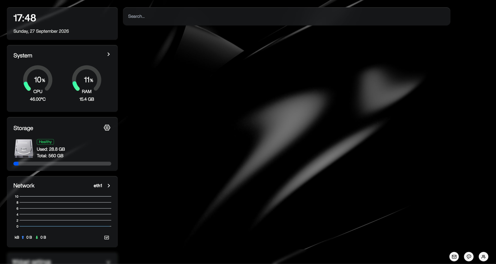

I upgraded to version ZimaOSv1.8.0-beta1
After upgrading I no longer see:
Any of my App Icons.
Any network traffic on eth1.
I have rebooted, this did not resolve the issue.
I have looked at the running processes and confirm I can see them.
I have tested “OpenSpeedTest” that I have installed on port 3004, this is working.
Therefore the containers are working and have running processes - so it appears to be a UI issue.
Let me know if you need any specific logs and where I can grab any debugs from.

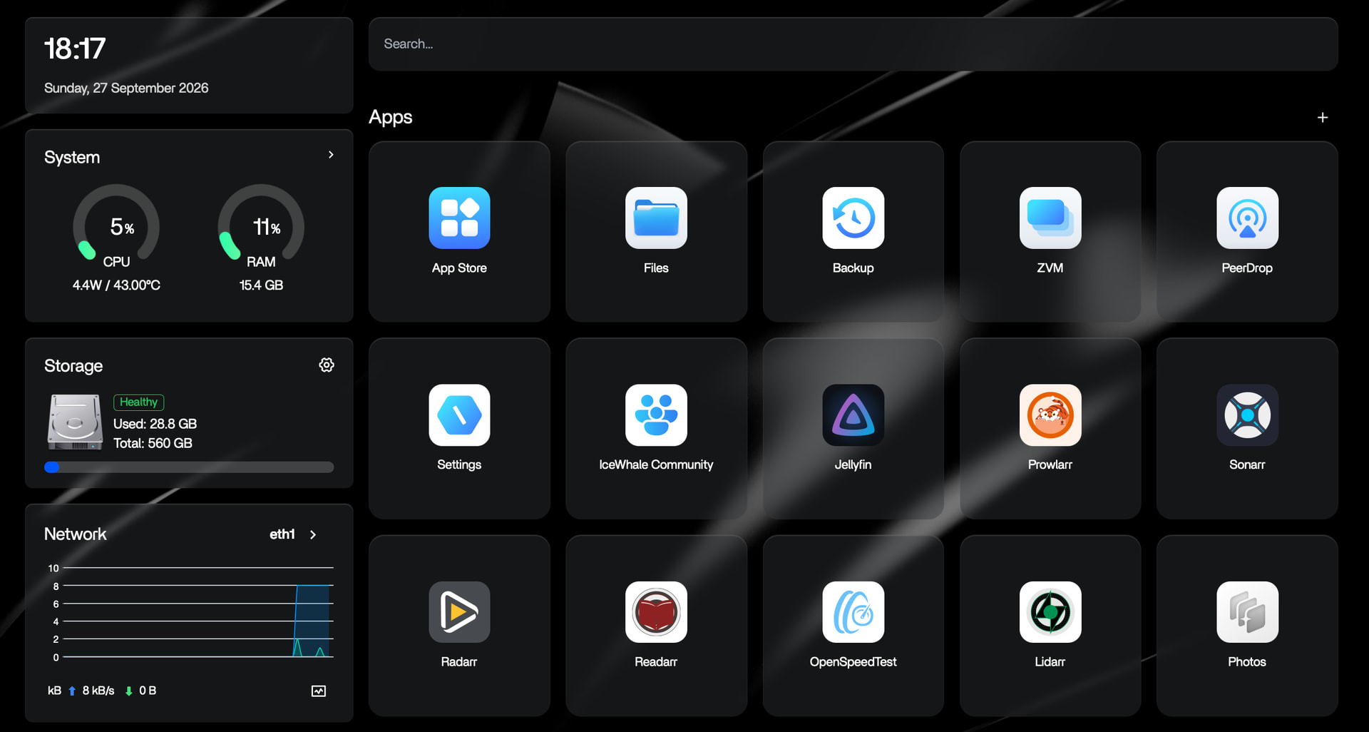

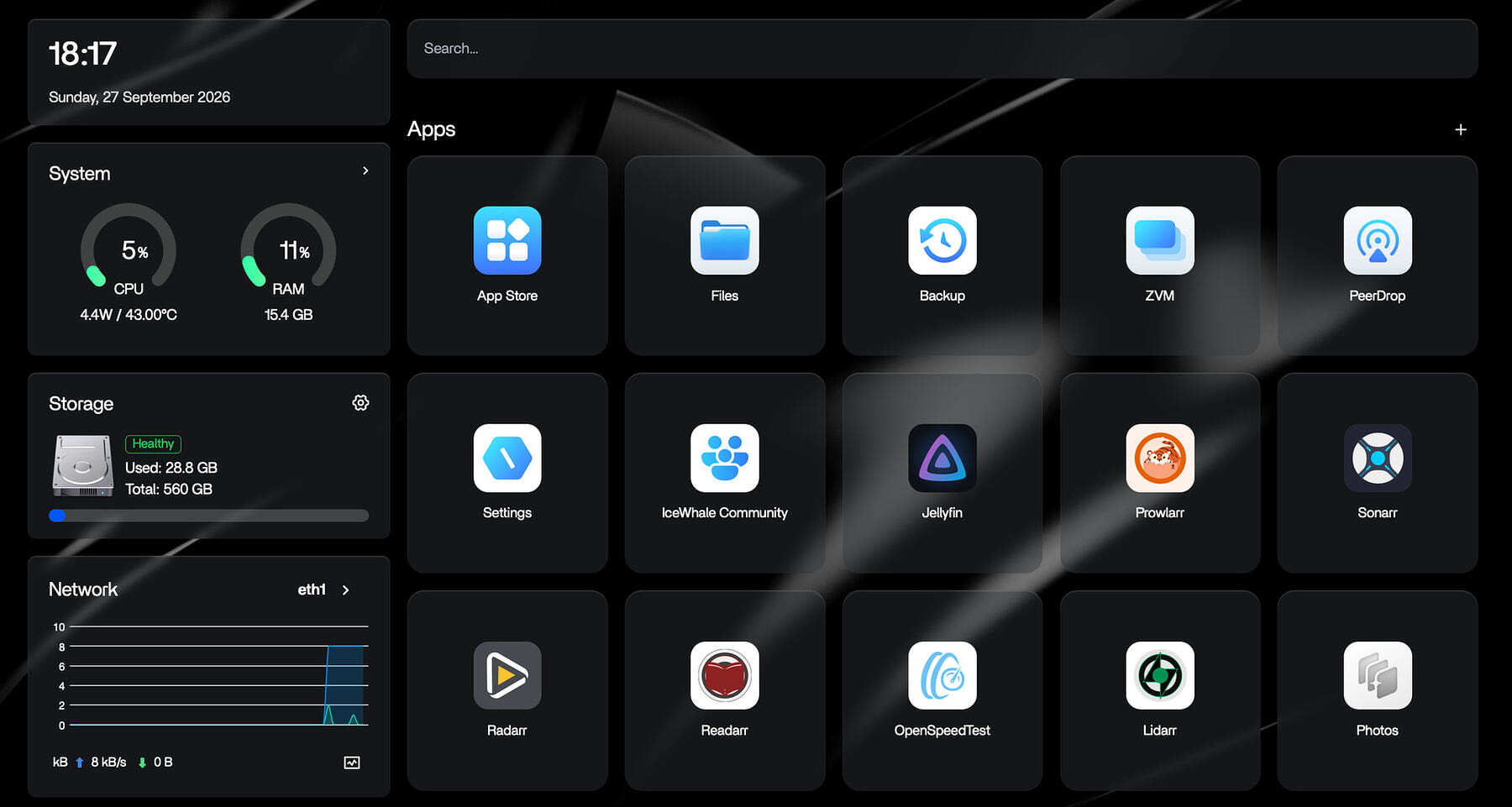

Update:
After 29 minutes, the apps all appear on screen with no intervention. Network details also are also showing.
Im not sure, if after the update, there is some kind of background process running in the background with no UI feedback, that is triggering this.
If it is a background update, then I recommend that some kind of “Upgrade is in progress” banner shows on screen with a progress indicator. It’s not an problem if the user is aware that the update will take time.

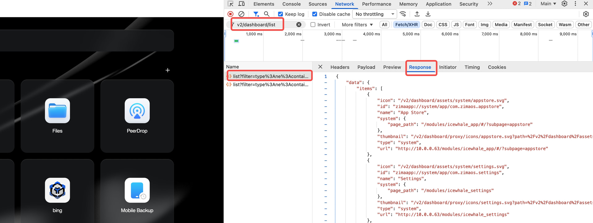

@BenP Is it back to normal now? You can open the browser control panel to see the v2/dashboard/list interface response error.
