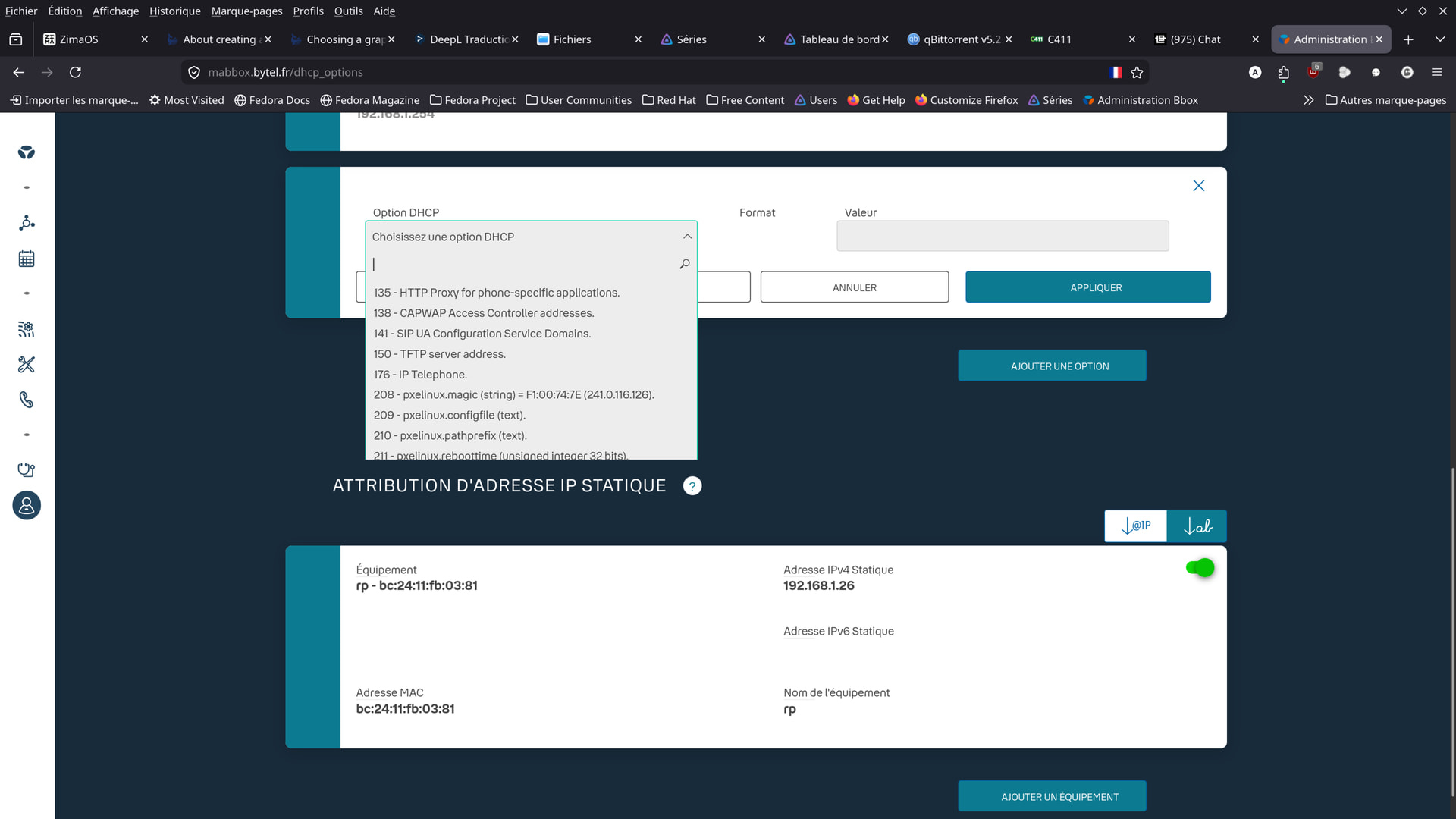

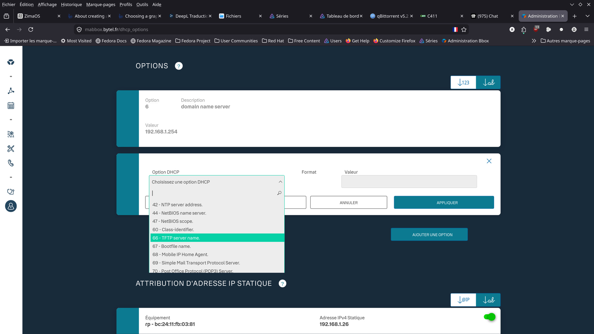

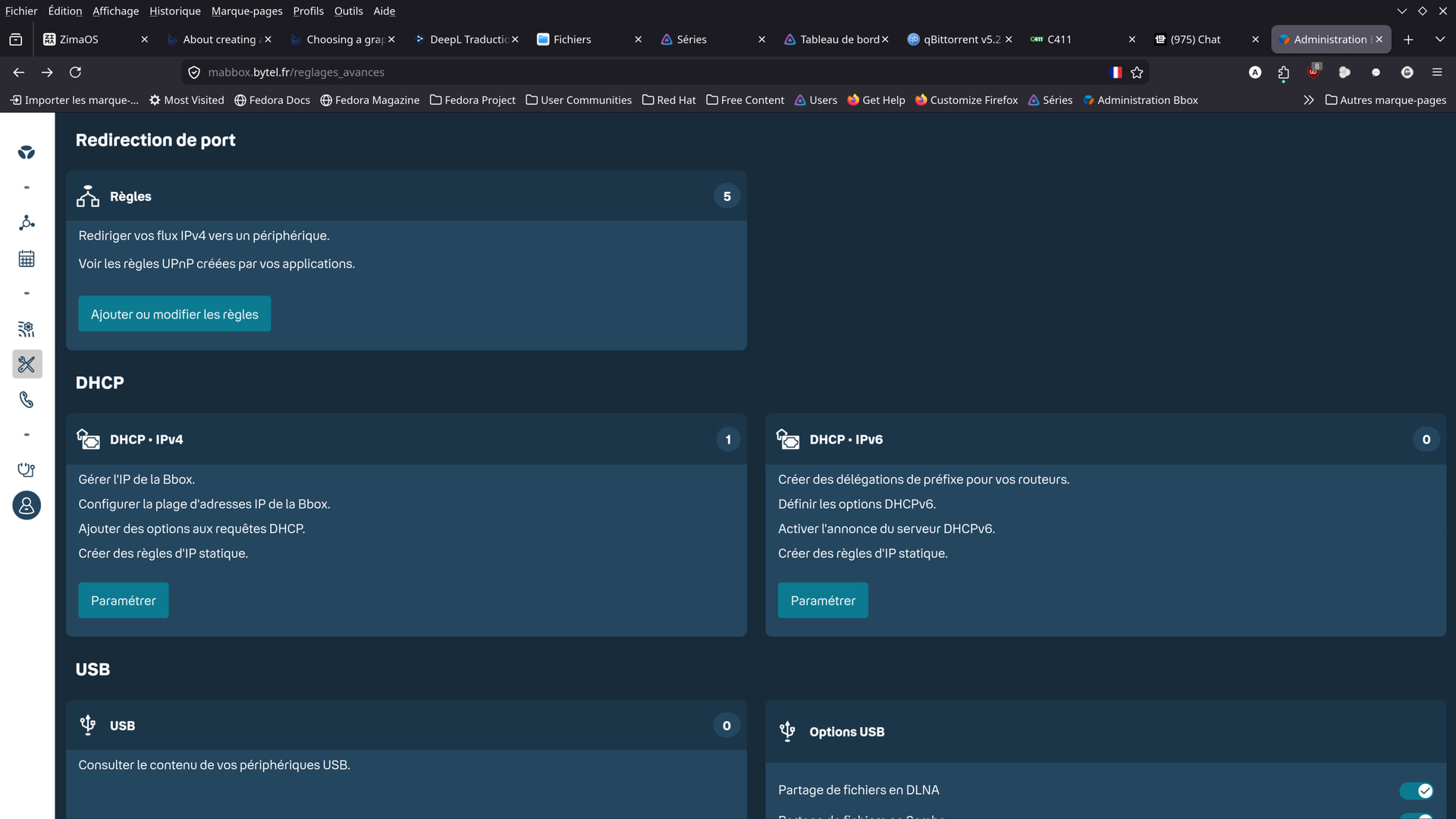

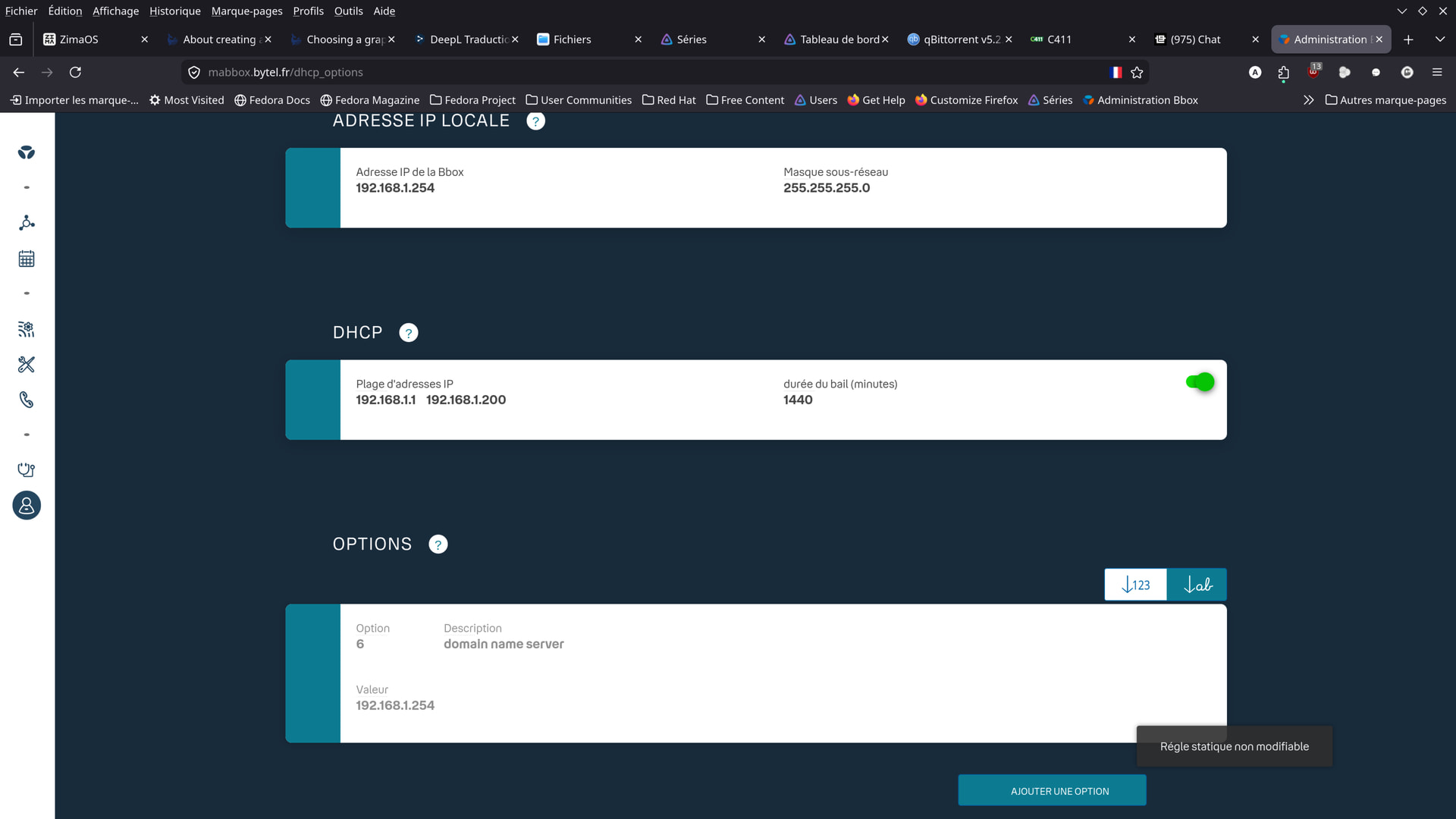

I wouldn’t worry too much about the NAS side yet. The first thing I’d check is whether the Bbox actually allows PXE-related DHCP options to be configured.
Unfortunately, many ISP-supplied routers are quite limited and sometimes don’t expose the DHCP settings needed for PXE booting.
Before spending time building a PXE server, I’d suggest checking whether your Fast5330b-r1 offers:
  • DHCP option 66 (boot server)
  • DHCP option 67 (boot file)
  • PXE or network boot settings
If those options exist, you’re in good shape.
If they don’t, it’s not necessarily game over. Many people run a separate DHCP/PXE service (for example via Docker) and let the ISP router handle only internet access, but that adds a bit more complexity.
Personally, I’d verify the router capabilities first. If the Bbox supports the required DHCP options, then setting up something like netboot.xyz or Ventoy PXE on ZimaOS becomes a much more realistic project.
When you have time, a screenshot of the DHCP settings page would probably tell us very quickly whether the router is PXE-friendly or not.

From the screenshots of your Bbox, the encouraging part is that it appears to support custom DHCP options. That is often the biggest hurdle with ISP routers.
Personally, I would first verify whether the router can provide the PXE boot information required by clients. If it can, then either solution should be achievable.

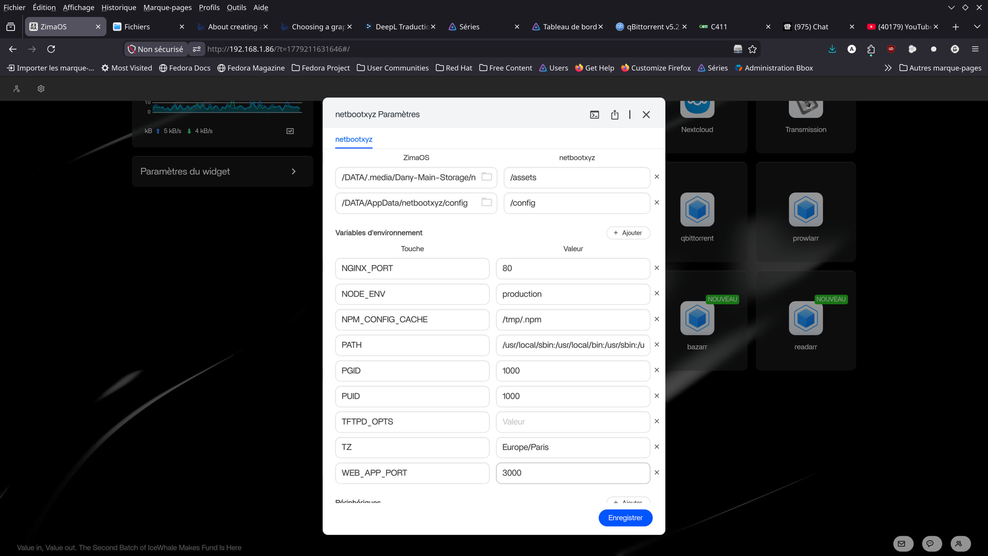

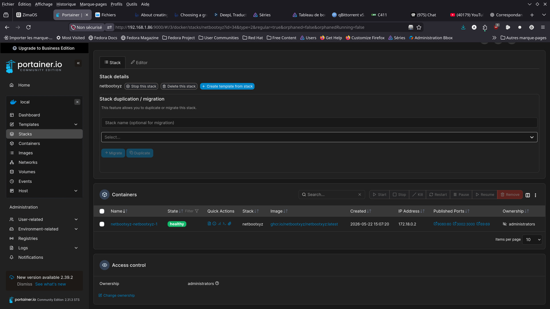

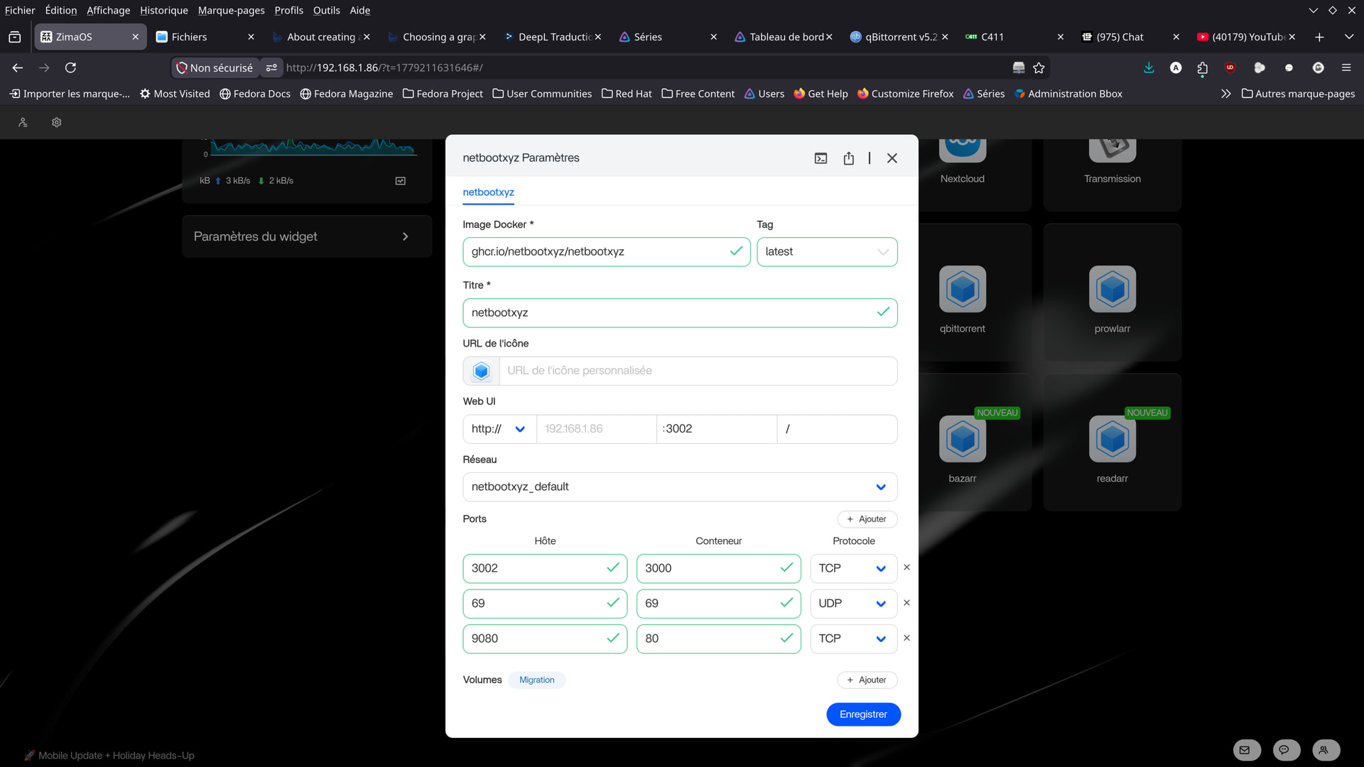

netboot.xyz is finally installed and up and running.
Tested in a VirtualBox VM.
There were a lot of “timeouts,” but I finally made it to the menu.
According to Claude, that’s normal.
Why? I didn’t quite understand.
I’m currently downloading all the images and files (437).
Netboot seems interesting.
That’s great progress already.
The fact that you successfully reached the netboot.xyz menu from a VirtualBox VM proves that the core pieces are working:
  • DHCP
  • PXE boot
  • TFTP/HTTP delivery
  • Communication between the client and the ZimaOS server
As for the timeouts, occasional delays during the early PXE stages are not unusual. A PXE boot typically involves several separate steps and network requests before the menu appears, so a retry or timeout message doesn’t automatically indicate a problem.
That said, I wouldn’t simply assume “it’s normal” without further investigation. Some timeouts can be expected during boot discovery, but excessive or repeated timeouts may point to network latency, DHCP timing, TFTP performance, VM networking settings, or router behaviour.
Since you eventually reached the menu and the downloads started successfully, I wouldn’t be too concerned at this stage. The important thing is whether the boot process is reliable and repeatable.
The next interesting test would be a real physical machine rather than VirtualBox. Virtual machines can sometimes introduce PXE quirks that don’t exist on actual hardware.
437 images available certainly gives plenty of options to explore.
