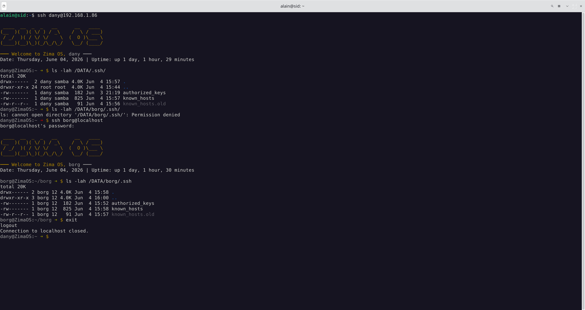

I can create the key, but I can’t copy it to Zima OS, and ChatGPT is giving me bad advice
my pc debian :
alain@sid:~$ ls -lah ~/.ssh
total 52K
drwx------ 2 alain alain 4,0K 3 juin 17:40 .
drwx------ 58 alain alain 12K 3 juin 17:46 ..
-rw------- 1 alain alain 399 3 juin 16:24 borgbackup
-rw-r–r-- 1 alain alain 91 3 juin 16:24 borgbackup.pub
-rw------- 1 alain alain 13K 17 avril 20:04 known_hosts
-rw------- 1 alain alain 12K 17 avril 20:03 known_hosts.old
alain@sid:~$
my nas zima os :
alain@sid:~$ ssh dany@192.168.1.86
dany@192.168.1.86’s password:
(__ )( )( / ) / \ / \ / )
/ / )( / / / \ ( O )_
)(__)_)(/_/_/ _/ (___/
─── Welcome to Zima OS, dany ───
Date: Wednesday, June 03, 2026 | Uptime: up 1 hour, 45 minutes
dany@ZimaOS:~ ➜ $ ls -lah ~/.ssh
ls: cannot open directory ‘/DATA/.ssh’: Permission denied
dany@ZimaOS:~ ➜ $ sudo ls -lah ~/.ssh
Password:
total 8.0K
drwx------ 2 root root 4.0K Jun 3 16:33 .
drwxr-xr-x 22 root root 4.0K Jun 3 16:31 ..
-rw------- 1 root root 0 Jun 3 16:33 authorized_keys
dany@ZimaOS:~ ➜ $
I manually entered my key into “authorized_keys,” but Borg still isn’t working.
found .
now all is ok .

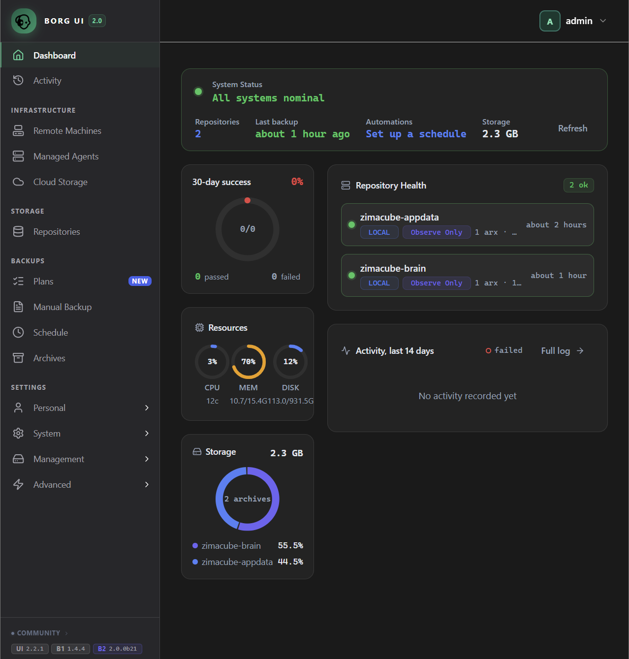

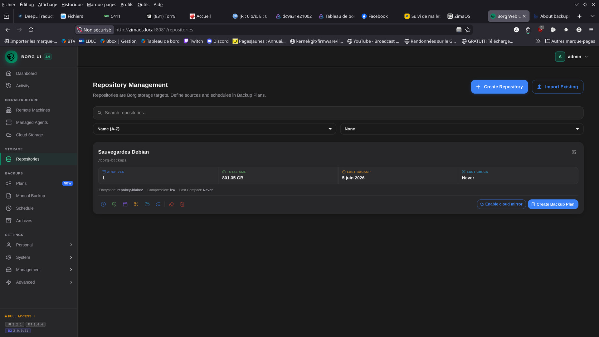

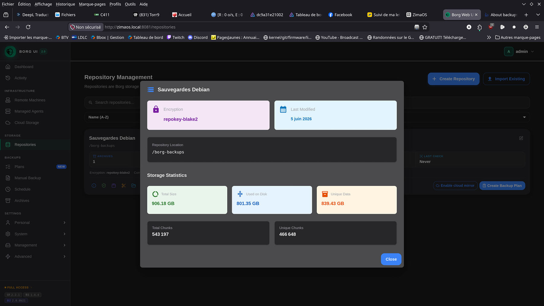

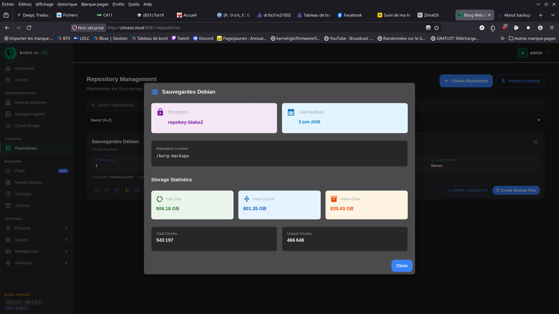

Just wanted to add a bit of feedback here because this thread pushed me to test Borg properly on my ZimaCube.
I ended up setting up BorgBackup with borgmatic as the backup engine, and then added Borg UI as the dashboard layer. I have to say, I am really impressed.
What I like about this setup is that it is very clear what is happening:
  • Borg/borgmatic handles the actual encrypted backups
  • Borg UI gives a clean dashboard to view the repositories and archives
  • Repositories can be imported in “Observe Only” mode, so the UI can monitor and browse them without taking over the backup job
  • You can clearly see archive count, storage used, last backup, encryption type, and repository health
In my test I created separate repositories for different backup targets:
zimacube-appdatazimacube-brain
Both are encrypted Borg repositories, and both are visible in Borg UI in Observe Only mode.
The most important part for me was not just creating the backup, but actually testing restore. I created the repo, ran the backup, listed the archive, then restored files into a test folder to confirm the backup was real and usable.
That makes a big difference. A backup is only trusted once a restore has been tested.
I really like this setup. For my use case it feels much stronger and clearer than a basic backup button because I can see exactly:
what is backed upwhere it is storedhow large the archive iswhether the repo is encryptedwhether restore actually works
Borg UI also looks very nice. The dashboard makes it much easier to understand what is going on, especially for users who do not want to manage everything from terminal.
Thanks for pointing this out. I think Borg + borgmatic + Borg UI is a very good option for ZimaOS users who want a more serious backup setup.

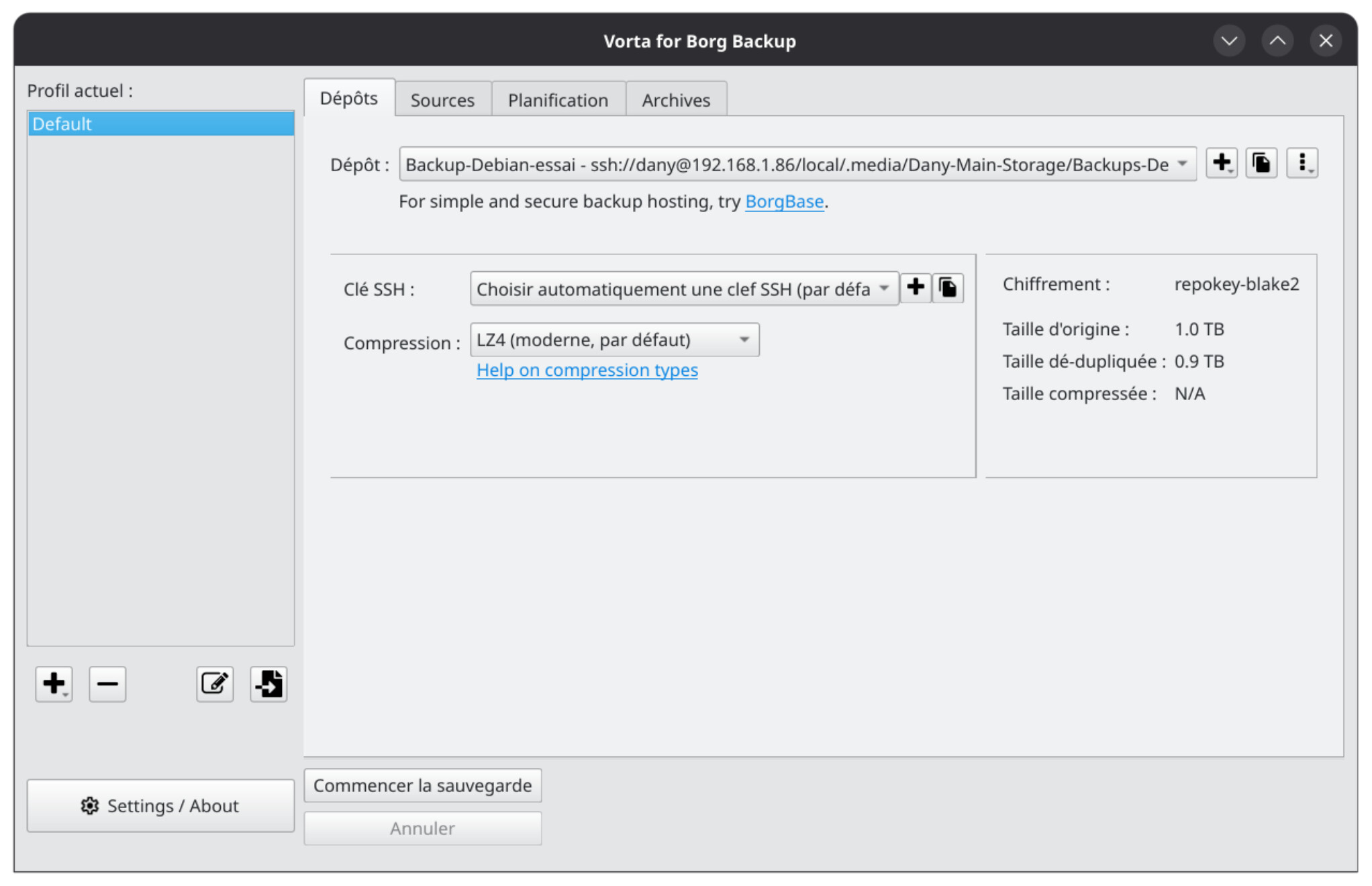

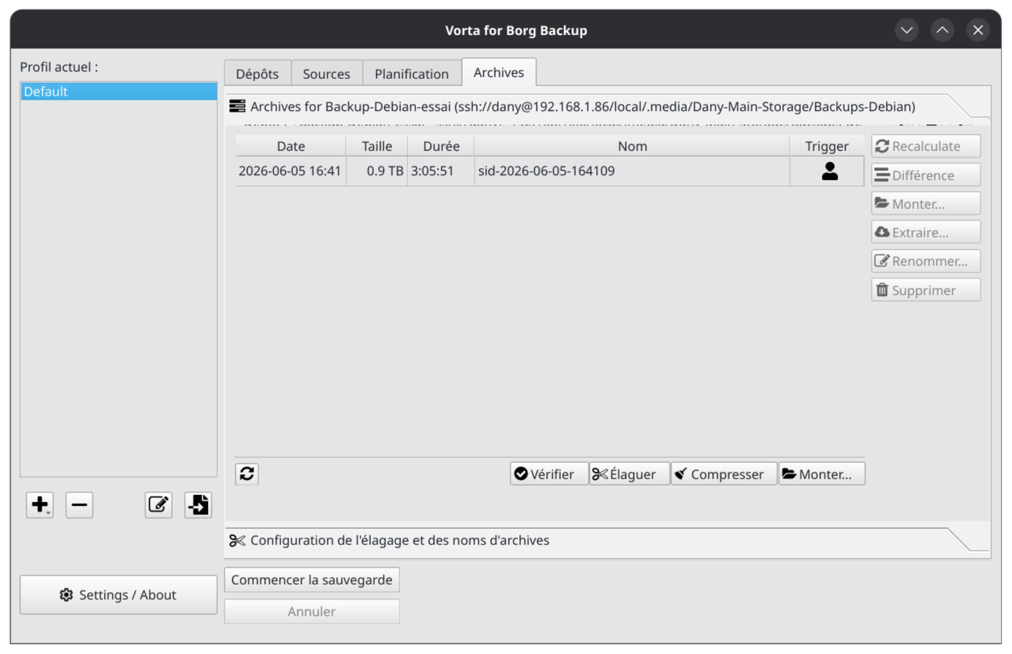

For now, I’m using Vorta on my Debian PC, and it works great.
But I don’t know if it’s possible to schedule a backup of the PC to the Zima OS NAS and its hard drives?

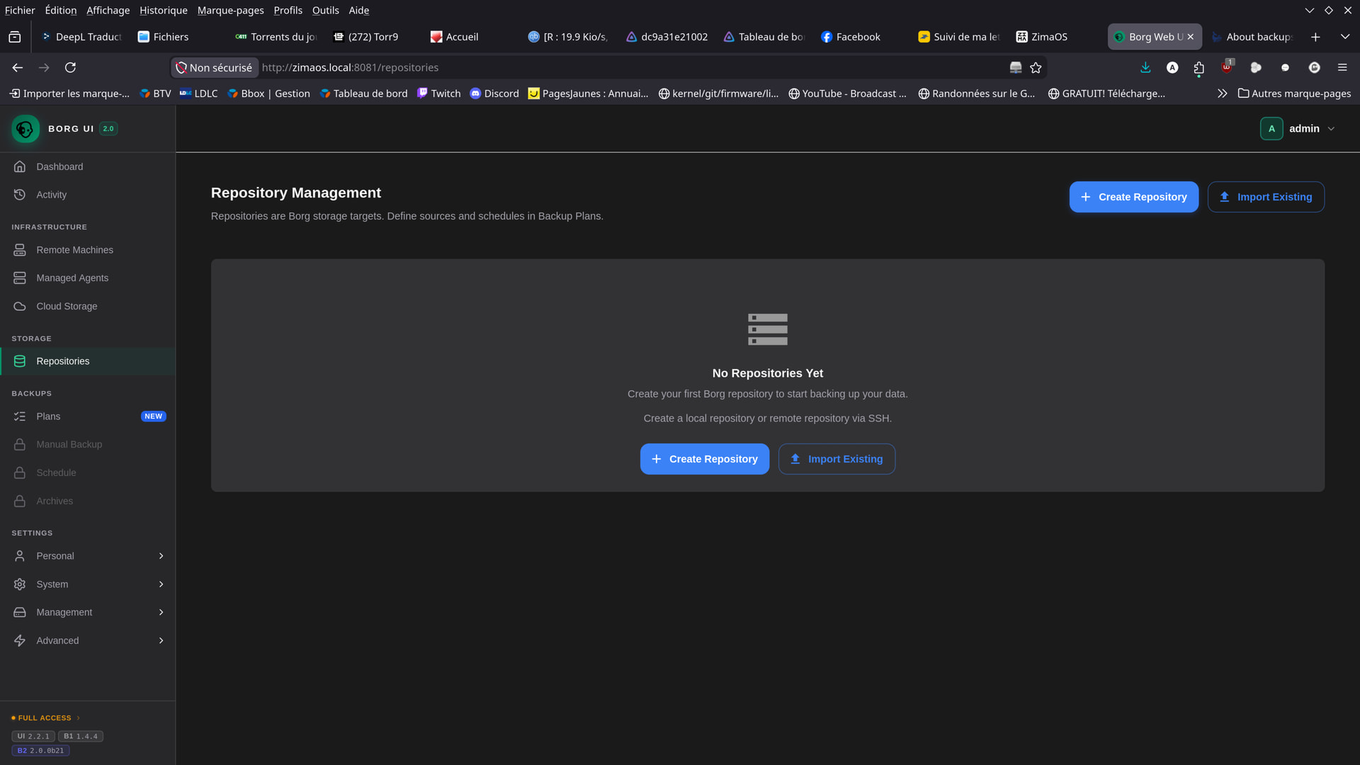

here are some photos :

I was able to back up my Debian PC to my NAS—from my Debian PC, that is—using Vorta (also on Debian).
I’d like to do the same thing, but using Borg-Web-UI on a Zima OS Docker container.

From the way I understand it, your current working setup is:
Your Debian PC runs Vorta/Borg
Your ZimaOS NAS stores the Borg repository on the HDD
The backup is pushed from the Debian PC to the NAS
That is actually a very good setup.
The important point is that the machine running the backup must be able to see/read the files being backed up. So if Borg is running inside a Docker container on ZimaOS, it can easily back up folders that exist on ZimaOS, but it cannot automatically see the files on your Debian PC unless you first expose/mount those Debian files to the NAS somehow.
So for backing up your Debian PC, I would keep Vorta on the Debian PC and let it push the backup to the ZimaOS NAS. That is the cleaner and simpler direction.

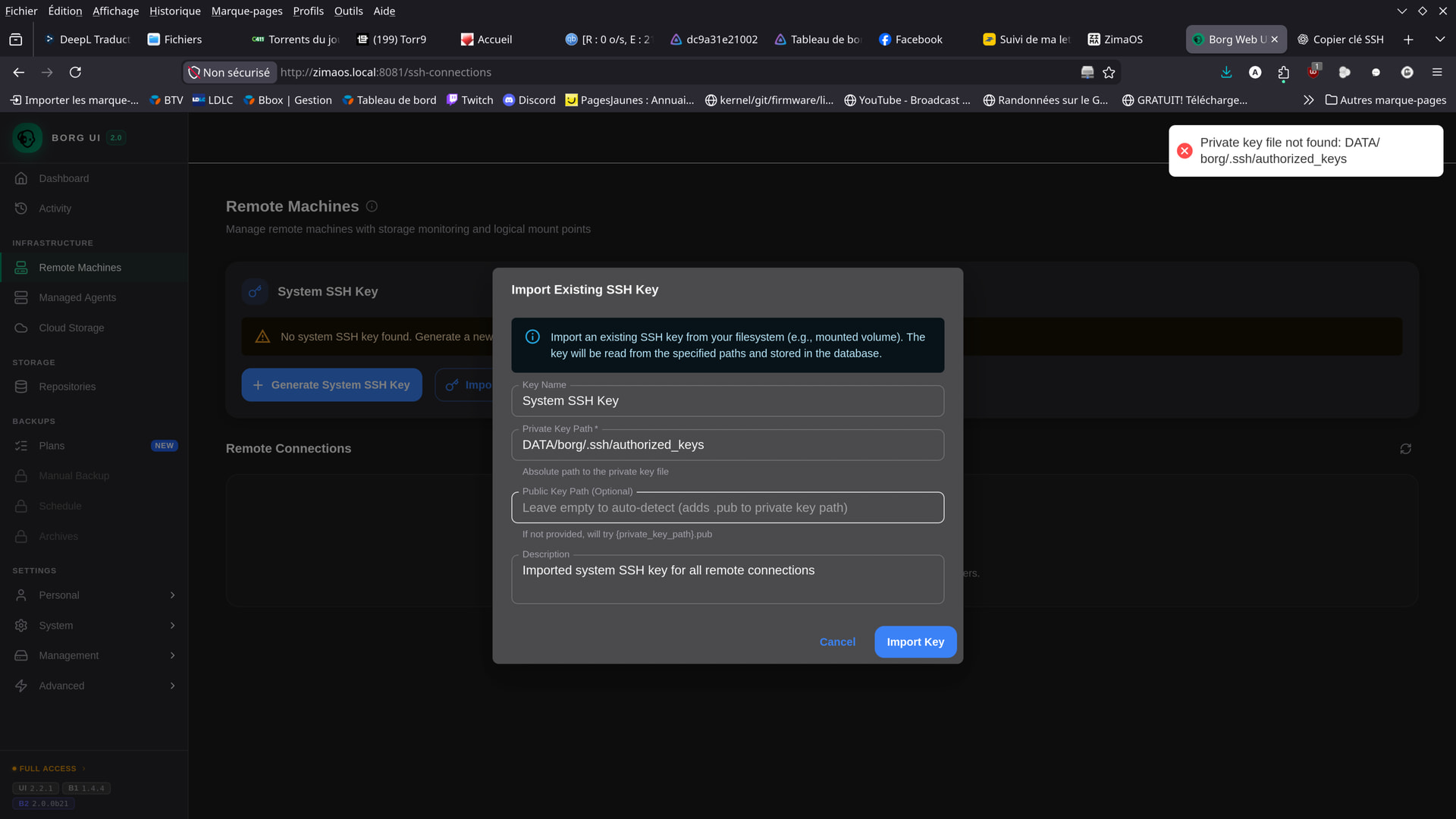

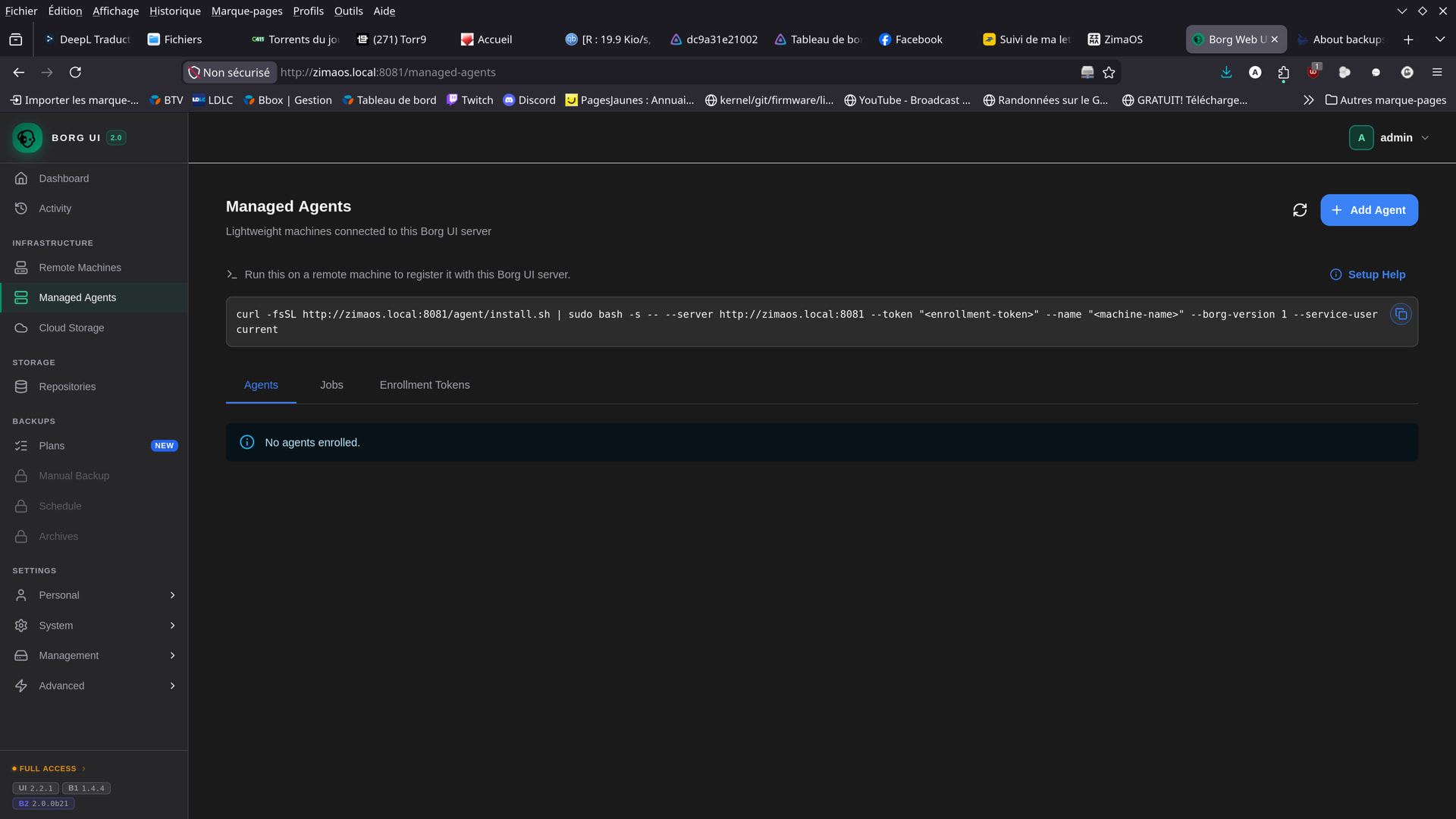

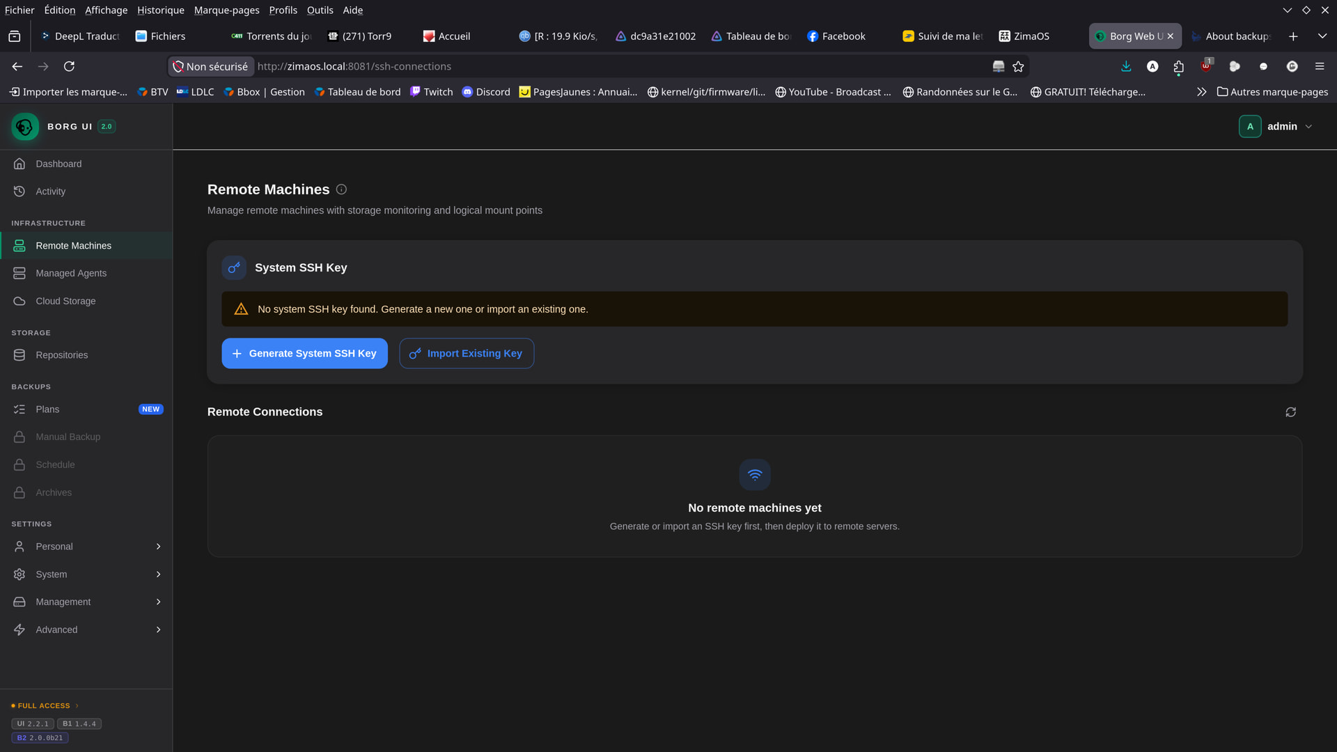

But how do you monitor backups on Zima OS using the Docker Borg-Web-UI?
Is that even possible?

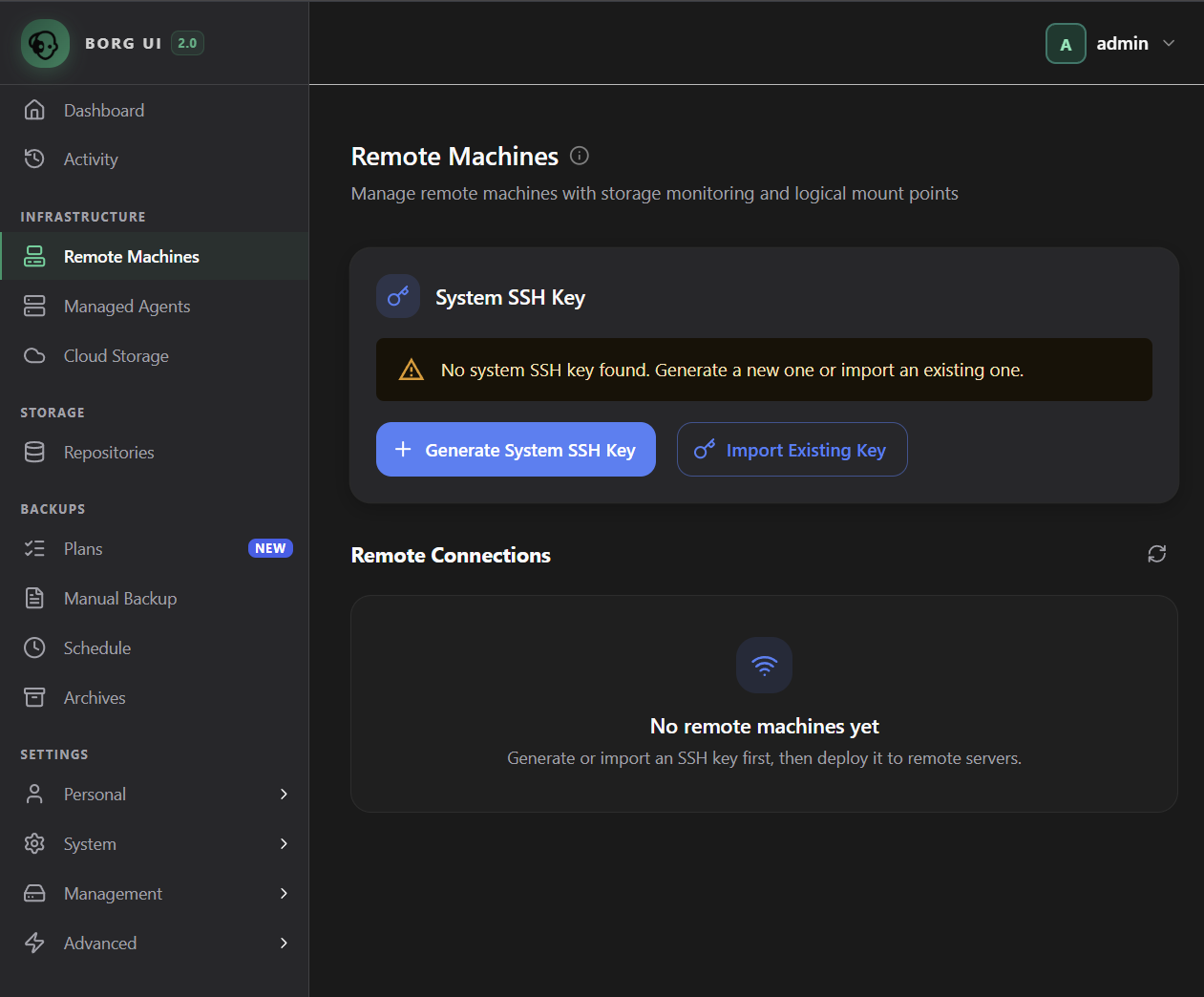

Yes, from that Borg UI screen it does look possible.
The “Remote Machines” section is designed for exactly that type of setup. Borg UI can generate or import an SSH key, then use that key to connect to remote machines and manage them.
So there are two possible approaches:
  1. Keep Vorta on the Debian PC and let it push backups to the ZimaOS NAS. Then Borg UI on ZimaOS can inspect the repository if that repository path is mounted into the Borg UI container.
  2. Use Borg UI more directly by adding the Debian PC as a remote machine over SSH. In that case Borg UI needs an SSH key, and the Debian PC must allow that key to log in.
The screenshot below is showing the second method. It is asking you to create or import the SSH key that Borg UI will use for remote connections.
So yes, it appears possible, but the important things to confirm are:
  1. Borg UI can SSH into the Debian PC
  2. The correct folders on the Debian PC are exposed for backup
  3. The Borg repository destination is on the ZimaOS storage
  4. A test backup and test restore both work
Personally, I would still keep Vorta on the Debian PC if that is already working, because it is simpler. But Borg UI does appear to support the more centralised SSH-managed approach too.

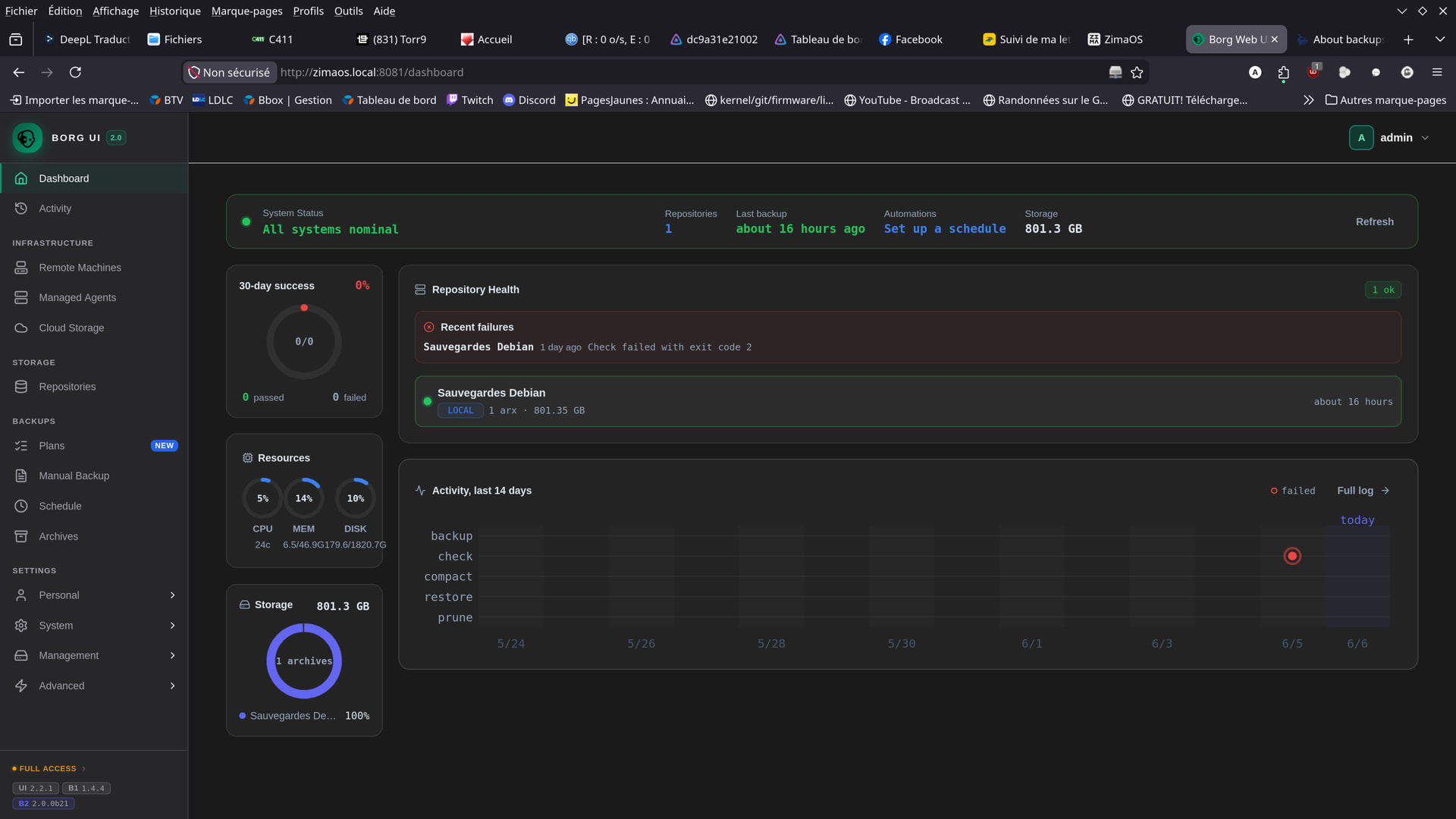

Backup done.
Let me know what you think.
If you’d like me to take it further, we can discuss it.
Like setting up and managing a backup controlled from my NAS to back up my PC (to the NAS)…
Here are a few photos.
PC Debian side :
NAS Zima os side :
