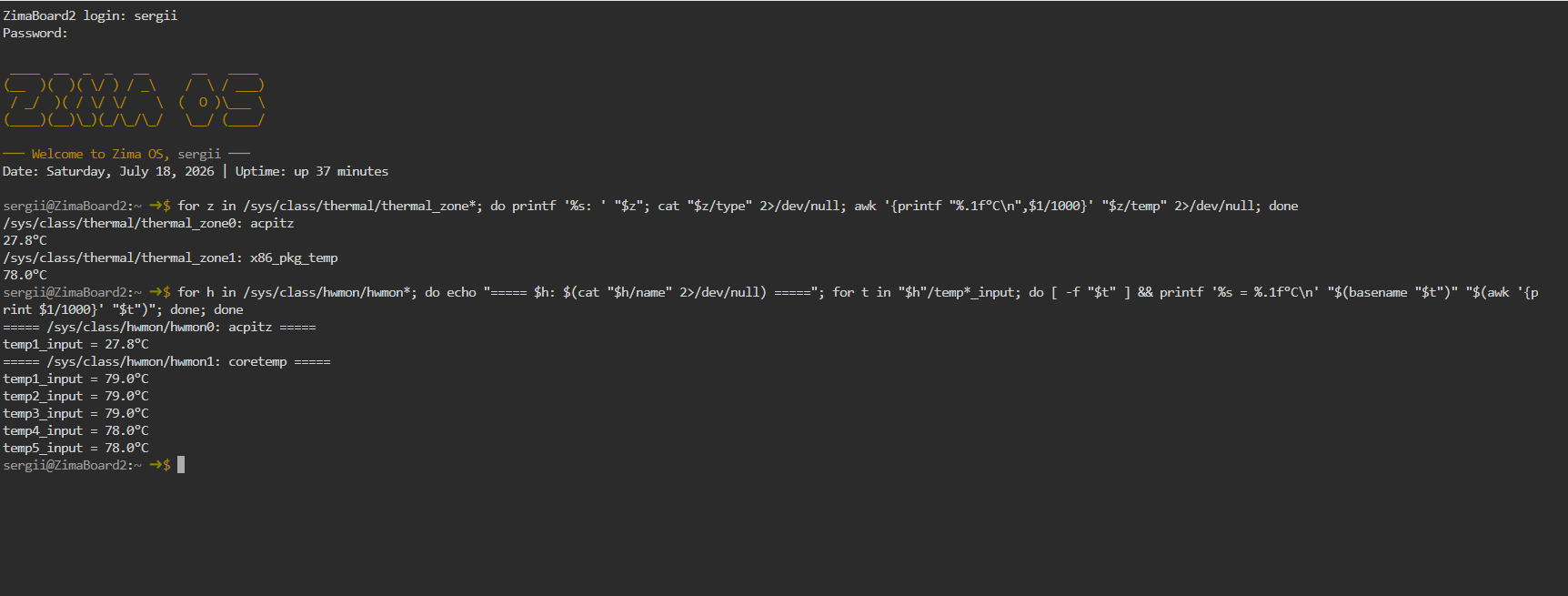

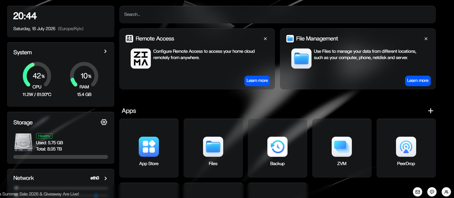

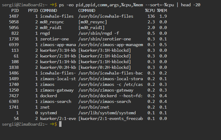

A clean installation of ZimaOS v.1.6.2 resulted in a temperature of 75-85°C, ZimaBrain not starting on v.1.6.2
Something strange is happening:
  1. A clean installation of ZimaOS v.1.6.2 resulted in a temperature of 75-85°C; upon inspection, it was discovered that the disks were constantly being polled.
  2. Installing ZimaBrain on v.1.6.2 resulted in ZimaBrain not starting on v.1.6.2, although everything worked fine in versions 1.6.0 and 1.6.1.
    Now in more detail:
  3. After a clean installation of ZimaOS v.1.6.2 on a ZimaBoard2 with RAID 1 enabled, the temperature remained at 75-85°C, even with an additional Noctua fan. I tried installing lm_sensors and other data collection tools, but the results were negative. To figure out what was going on, I decided to install ZimaBrain.
  4. After installing ZimaBrain in Docker, version 1.6.2 returns the “unable to start” message. I rebooted the system—the same result, everything in the settings is fine. How did I get it to start? We installed it via Docker, but didn’t specify port 8601. After installation, we started it, stopped it, then added the port via the settings, and Brian started. “Dancing with a tambourine.”
    So far, I’ve restarted ZimaBoard2 three times. The system has calmed down, the temperature has dropped to 32 °C, and the constant disk and fan spikes have stopped.

For the CPU question, ZimaBrain did check the available process evidence, but no high-CPU process was active at the exact time of the export. A new export would need to be taken while the temperature and CPU load are high.
Thank you again for testing this. I will use this session to correct the permission-error classification, failed-service routing, and SMART verification status in the next ZimaBrain CE release.

Thanks, Sergii. This screenshot confirms the ZimaBoard 2 is not idle.
The CPU is at 83°C with approximately 54% total utilisation, all four cores are continuously around 50–58%, and the processor is running at 3.1 GHz. This explains the high temperature, but we still need to identify which process or service is creating the sustained load.
Interestingly, the ZimaBrain export said no high-CPU process was detected. This means the activity may have been missed during its sampling period, or the current detection threshold needs adjusting. I will include this in the ZimaBrain improvements.
While the load is visible, please run:
ps -eo pid,ppid,comm,args,%cpu,%mem --sort=-%cpu | head -20
Then run:
top -b -d 2 -n 5 -o %CPU
Please post the complete outputs. This should identify whether the activity comes from RAID synchronisation, disk management, a ZimaOS service, or another process.
